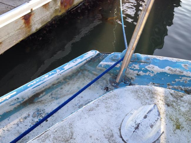

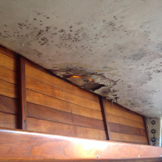

Here are a few photos do 239. I've got lots of cosmetic work to do. I would love it if some of you could throw out ideas. This repair was done poorly but is somewhat strong. Looks like a stanchion pulled out

What a great deal you got! I think you are in a great position, I would encourage you to try to avoid shortcuts but there is no need to spend tons of money to get sailing.
There are many more knowledgable then I, but even I can do excellent repairs to fiberglass with some patience. Great posts here, very knowledgable folks. Wrt your stantion problem, basically just grind out the "bad" until you get to the "good" and feather the edges... Get some fiberglass, a bit of epoxy (pick up the west system guide pamphlet at west marine, even if you don't use their brand it has good instructions)....
Please do be careful, even a reasonably safe product like epoxy can be dangerous. Use a respirator, and gloves... I learned the hard way to respect these chemicals and am very very lucky to be alive.

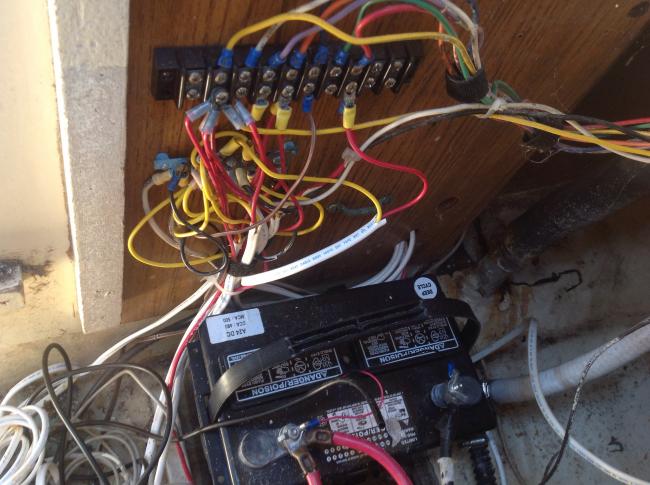

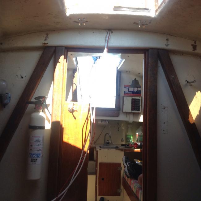

Some elect to strip out all the wiring and start from scratch. I would not do that, especially since it looks like there is a fair amount of new wire in the picture. Faith still carries some of her original (1964) wire... Try to sort out what works and what does not. If you find bad connections, replace them.... Target your repairs and unless it seems worse then it looks in the picture you can invest your time and money in other areas.
The long wires hanging down from the entrance to the vberth are coming down from the mast. They are often left long to make it easier to step and unstep the mast. Just tie them up out of the way for now....
