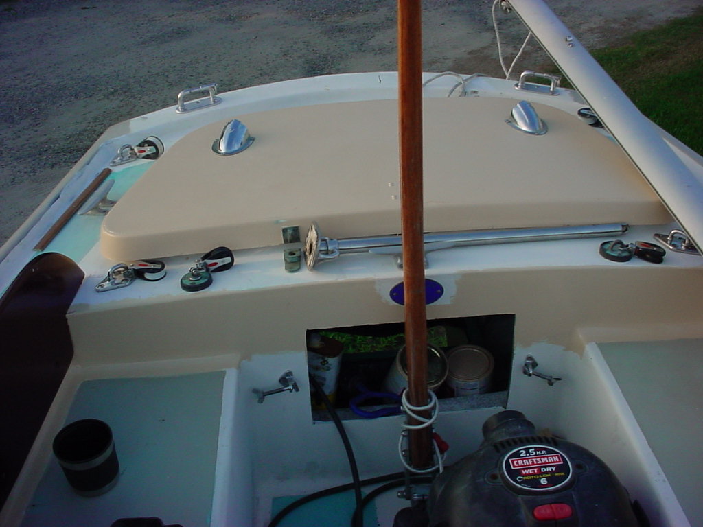

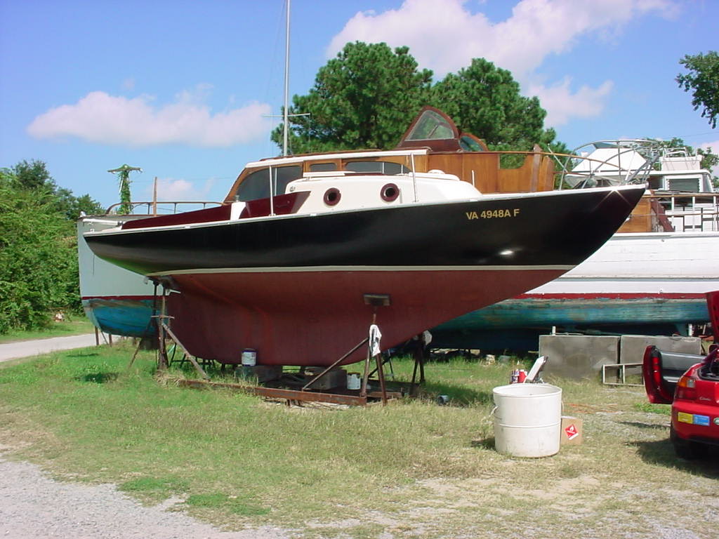

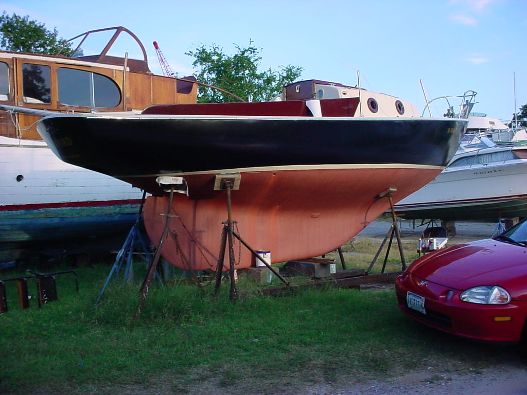

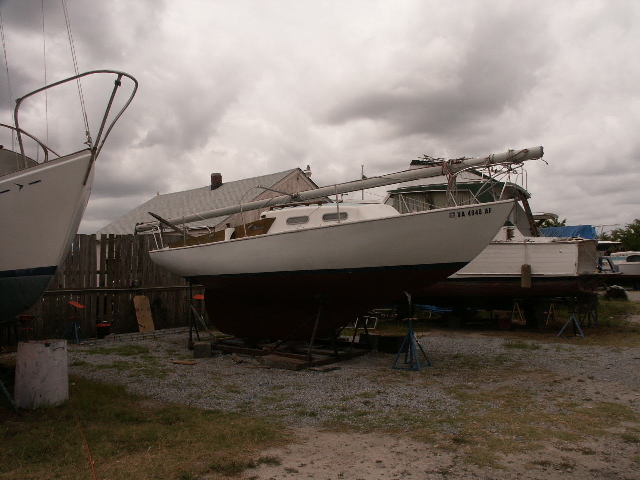

Mike Goodwin showed me his Ariel and I guess I got the bug again. I havn't sailed sinse Seascouts (ship 19 Delanco NJ) and my 4 year hitch in the Navy cured me of boats;however, the beauty of the design of Mike's Ariel and some very good memories of sailing on the Delaware has me back at it.
Mike found for me an Pearson Commander(hull 105) in great shape, ready to sail. I have removed the old peeling/powdery bottom paint and repainted it. I have replaced the worn out tiller and handholds on the cabin. I plan on painting the cabin and hull also. The deck areas will get an application of Tufflex which will make them better than new and hide some very minor stress cracks. The hull had no blisters. The decks are in great shape.The boat came with 3 almost new sails and a new spinnecker sail. The winches are original and worn I plan on installing new self-tailing ones- any ideas? I can't wait to sail her.

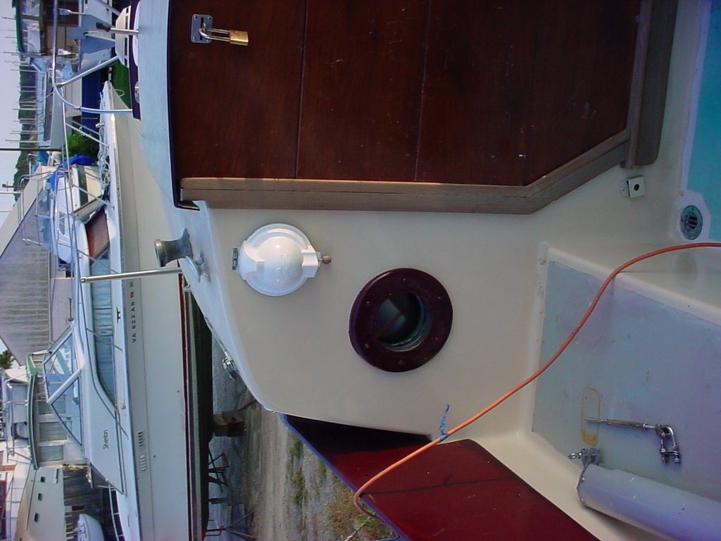

Look at that! Those round-eyed port lights are so damned salty I can't even blink. Yesssir! Now I smell styrene and have begun to itch a little. Even the Nearly Perfect Wife agrees. About that tiller--might I suggest a most noble and tough and rot-resistant wood: bois d' arc, aka osage orange. Members of my family have fence posts of the stuff more than 120 years old. Just won't rot. Beautiful stuff, too, when sanded to a glassy surface and varnished. In the sun it will eventually turn a purple-black. Bright yellow to start.

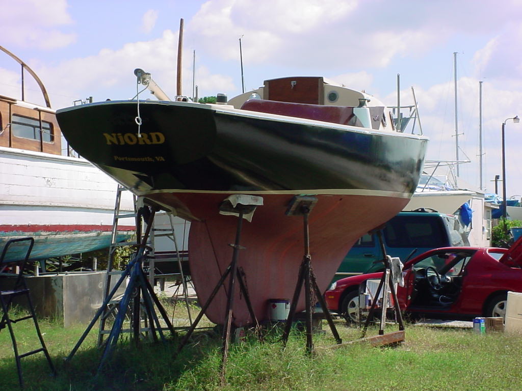

Want to Share My Commander, Njord, Hull #105
After a couple of rounds of surgery these last three years and not sailing my Commander for two years, it is in need of some maintenance. I am looking to share my boat with another/other sailors who appreciates this boat and willing to do the work or form a group to sail it. The boat is docked at Nautical Boats here in Portsmouth, Virginia. Motor has less then ten hours on it, a Nissan five horse, four stroke and is need of maintenance. I am doing very well now but need partners keeping up this wonderful sailboat and expenses. :rolleyes:
