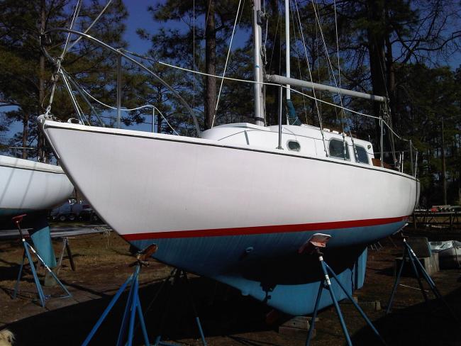

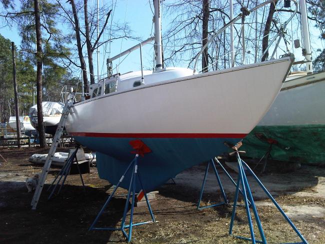

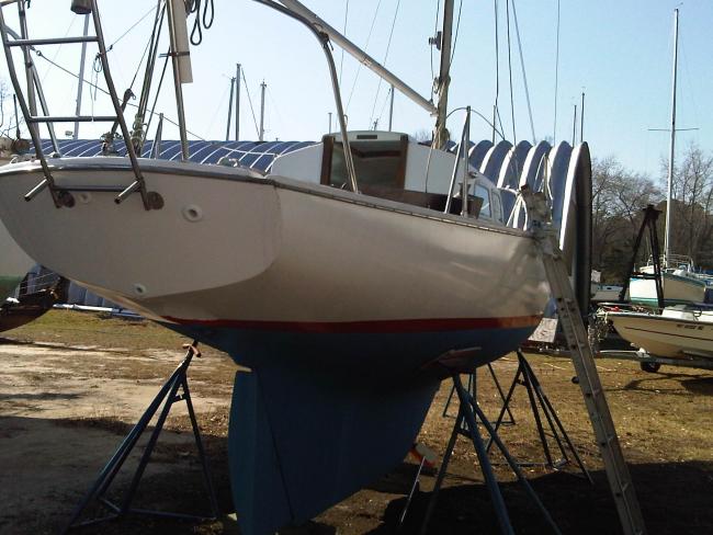

Here's a brief run down on the boat: Built in 1963, She was one time registered with the site as being in Kentucky and her name at that time was "Hunky Dory" or so I'm told.

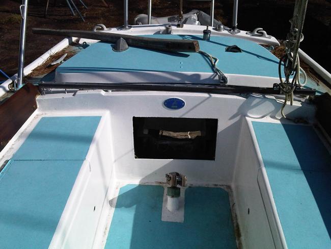

Exterior pictures attached.

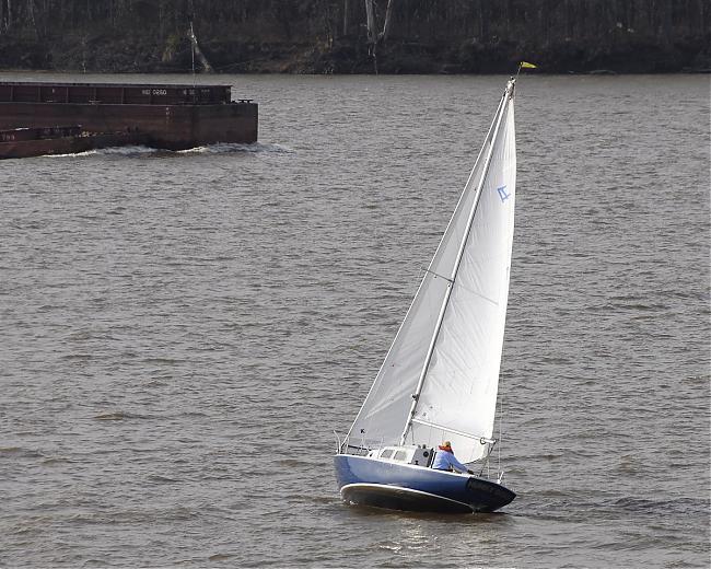

WOW that's IMPRESSIVE!!!!!
If Hull # 107 was actually named Hunky Dory as detailed in the records, she sported a different color scheme and was BEAUTIFUL!!!!!!!

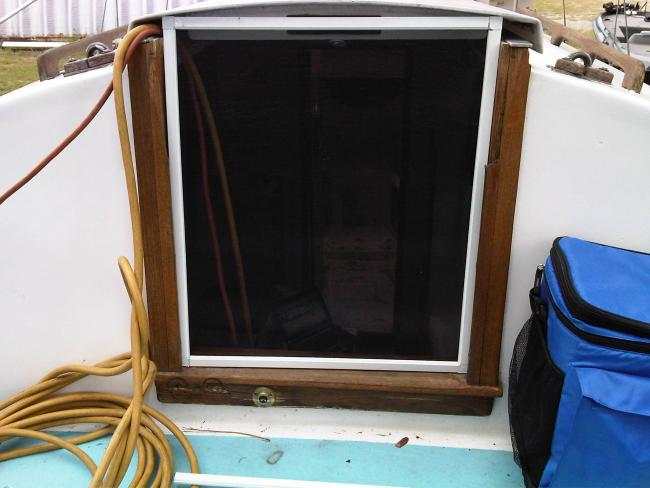

Well, I don't know about where you guys Ariels and Commanders are moored but where mine sits up, mosquitoes have become a major issue. While attempting to work, I had to stop what I was doing and go to walmart and work on screening.

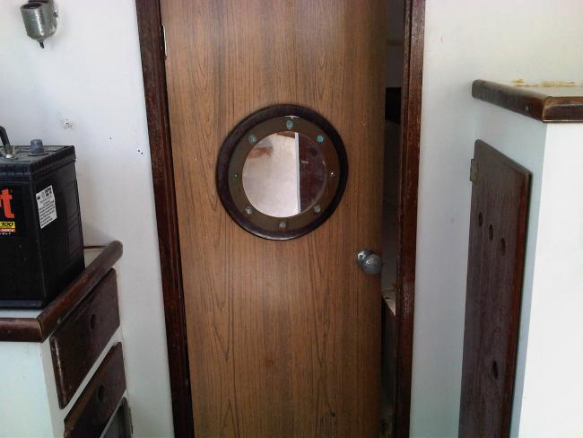

I got some nylon screen and a framing kit and pics are posted, not bad looking if I must say so myself!Attachment 7744

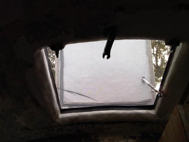

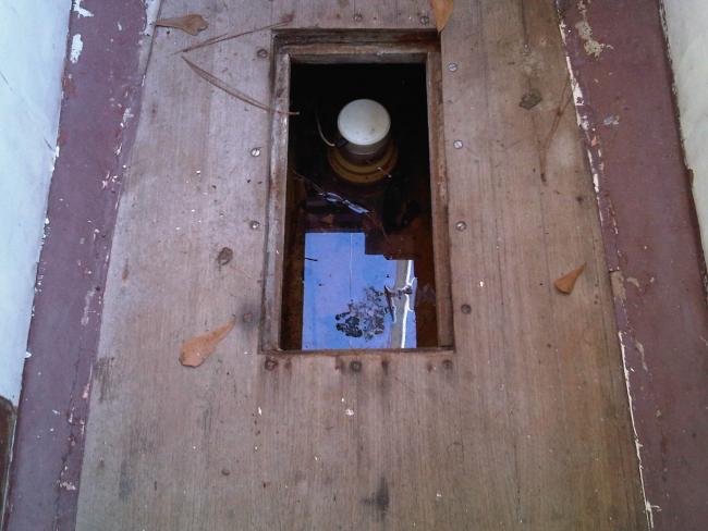

The hatch in the v-berth, I just cut some screen and secured around the base with a bunji cord. Attachment 7745

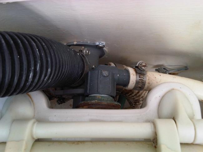

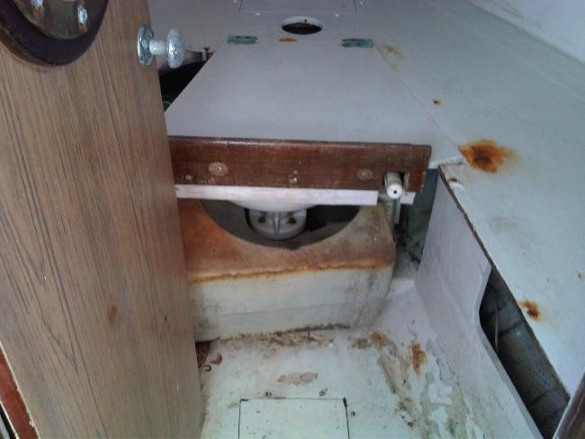

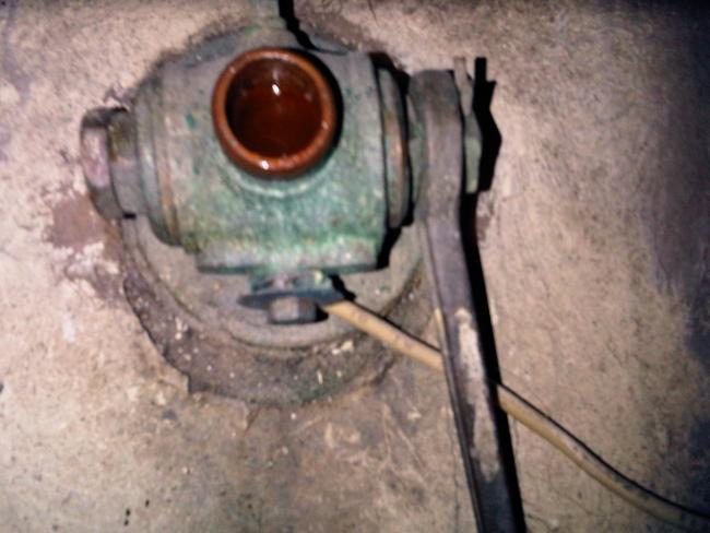

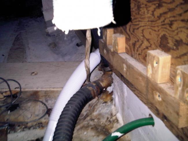

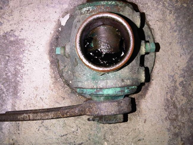

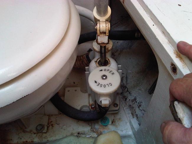

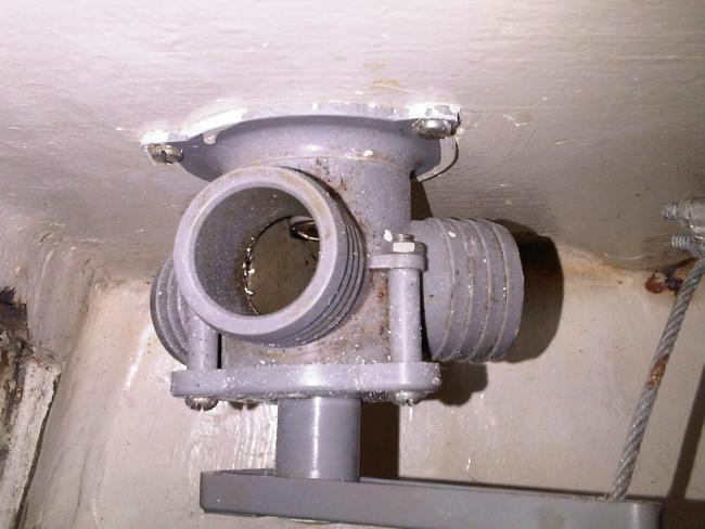

Removed the head, hoses and holding tank, so I can sand that area and while I was at it, removed the hose fittings from the seacocks and the seacock feeding the head is secure and tight, it won't budge using penetrating oil and hammer taps, the discharge seacock is somewhat open to the sea, penatrating oil can be seen running down the through-hull and down the keel which is what I was afraid of and it won't budge either. Neither seacock has nuts and bolts so apparently they unscrew from the through-hull (which is a two man job). I found out the through-hull draining the cockpit floor and the sink does not have a seacock, it's open to the sea.
