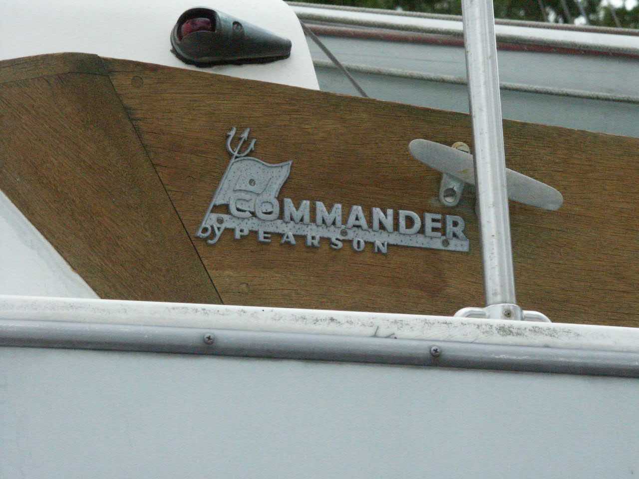

Here are the ones for the Commander from #105;
This looks like and original stem fitting also on #105

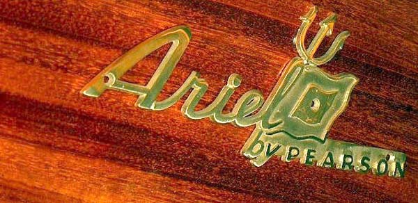

Bristol Bronze sells a copy of the Pearson oval number plate in bronze (natch) for about $40. The other castings are not available unless someone is willing to loan one for a pattern.
Kent Davis (Ariel # 376) worked with Bristol Bronze and come up with a bronze reproduction of the Ariel logo plate that Pearson affixed to the outside of the cockpit coamings. Here are a couple of photos of it. The first is of new logo plate affixed to Kent?s boat
This photo is of the two logo plates taken together:
Here is the information you will need if you want to purchase a set of logo plates for your Ariel:

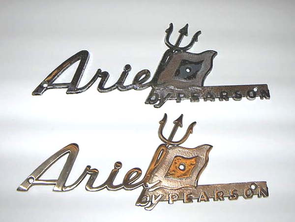

Are there any thoughts about how to turn the Bristol Bronze casting into the original Ariel plate? As I recall the original was chrome with a blue piece in the center.
I recognize that you could get the Bristol Bronze pieces chromed ($$$$$), but what about a silver paint, and a blue paint (assuming it was blue. Maybe it was white). Does anyone have an example of what the original looked like as to a coloring scheme?
It seems to me that Pearson did not use paint. More than likely it was porcelain. Like the number plate.
Bill: I think the plate was made with a process called silk screening. It leaves a slightly raised surface. They can use epoxy paint for the purpose (or any of a variety of specially designed paints) . It does look like "porcelain" but it most likely is a painted surface. To the best of my knowledge, generic silk screening is only suitable for flat surfaces. Today (I don't think the technology was available then), powdered metal may also be an alternative coating).
On the original Ariel casting, if they did chrome it, and the area to be colored is flat, that area could have been silk screened (You can silk screen over chrome as I recall).
All this is fine if you are making 1,000 peices. But for two, conventional paint may be the only alternative. Do you recall or can you find out what the original colors were, and where? Are there any metal finishing experts in the crowd?
Bristol Bronze told me that most of the original Pearson logo's were made of something called Pot Metal, which I inferred was cheap. They chromed over it (you can see remaining chrome on the original plate in the photo a couple of posts above). Bristol said that these plates deteriorated fairly rapidlyand are very brittle. Mine was in the Great Lakes for all but the last 8 years, so lasted pretty well. However, I don't recall, even as a kid, seeing the blue or white enamel or paint colors you mentioned, Theis. Not to say they weren't there earlier, but by 1971 or so, when my dad bought our boat, the colors were already gone, if they existed. Doesn't seem plausible that a hard finish would have disappeared that quickly--- paint could have.
The "pot metal" was probably the zinc stuff you find in inexpensive fittings for power boats.

In the picture a few bits above, it does look like the parallelogram flag is a different color/not chromed, but that the finish has worn off. My recollection is that there was a highlight color in that flag
If the group conclusion was that there were no colors, maybe I'll paint the logo to go along with the color pattern of my halyards so they all blend: pink, periwinkle, mauve and chartreuse.

As a former screen printer I'm willing to guess that the color was dropped in by hand or stamped on but not screened prior to baking. You're right, there has been significant changes in that industry in the last twenty years.
Peter T.,
The coloration difference you see on the flag on the "old" casting is due to the fact that I gave Bristol Bronze liberty to buff out surface pits in the chrome before they made the casting pattern. However, there is an "etched" finish to parts of the original casting, around the flag, for example. But can't tell if it was just for decorative contrast, or if something was ever applied to it. Maybe I should take the thing down to the Houston Museum of Nautical Antiquities (you know we have sooooo many old things here in Houston, ha!) and see if they can do an electron scan or flourescence testing to see what the original piece looked like.
There must be an easier way, don't you think? Or do you have the last remaining original in the whole wide world (a.k.a. www).
Ta Da!!!!
The answer is out. The plaque was chromed, and the inside of the flag was painted BLUE. Who would have guessed that? Apparently, according to Rudy Knickerson, on later models the nameplate was a decal type thing. He is sending me a couple which, when I receive them, I will post.

Took a close up of the "A" on the plate I had sent off to make the copies. You can see that it still has chrome on it, except where they ground off some of the surface pits. Was shiny before I sent it off, so buffing didn't cause the shine. Black around edges is from the pattern mold. This is off 376, so its one of the late model boats (last 15% made). Don't know if they changed the plates over time-- might have.
Kent:
That is the way I recall they looked. Roger at Bristol Bronze was around the Pierson yard in the time frame of the Ariel. He said that the potmetal nameplate was originally very bright chrome, but faded almost immediately on leaving the yard.
He suggested a matte chrome finish would come close to duplicating the original - and that is what we will be having done.
