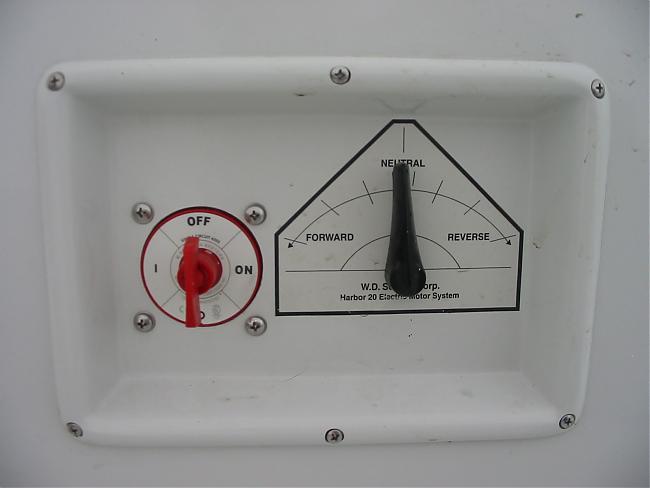

Do you have any idea how much electricity you can generate with the Sevcon PMAC 48 volt controller setup? Obviously the more you can generate the less battery weight you need to carry. I would really like to avoid needing 8 batteries. Going out long channels to get to deep water in the gulf makes my future repower a little more demanding than your inland lake sailing. I will also be looking at photovoltaics as a possible method of getting some juice back before I get back to the dock. The upside is you don't need wind to charge that way but the downside is you need a lot of them to get a significant amount of recharging capacity. Solar cell technology is improving by leaps and bounds and the problems may soon be overcome.
I was unable to find the Curtis WD-45 throttle you mentioned. I found a WP-45 but it only works up to 30 volts. Can you give me a link to the throttle? Will it lock in the center so you don't accidentally bump it into forward or reverse? I guess a key switch would make bumping the throttle not a problem however.
Have you given any thought to where you will locate the batteries? I would like to keep them as far forward as possible without making the cable excessively long.

I really do not yet have a handle on the regen capabilities. There are so many variables such as prop slippage, prop size and come in speed. I think I'll just have to play with the programming once the system is installed. A few sites selling similar systems claim to be able to regen while at anchor in a current. I don't think I would want it to come online and start inducing drag until I was near hull speed, but I'll have easy charging in my slip.
My mistake... it is the WP-45. Keep in mind it is not using the full line voltage, just the 10.5v controller circuit voltage. Anyway I'm off the WP-45. The Harbor 20 uses a Motorguide electric motor set up and has a very neat key switch and throttle in a nice recessed pan that will mount flush. It is 5-0-5 K ohms, it does not have any feel or neutral detent, but I've found it to work great the few times I've sailed a harbor 20. I just ordered the pictured set up from Schock.
