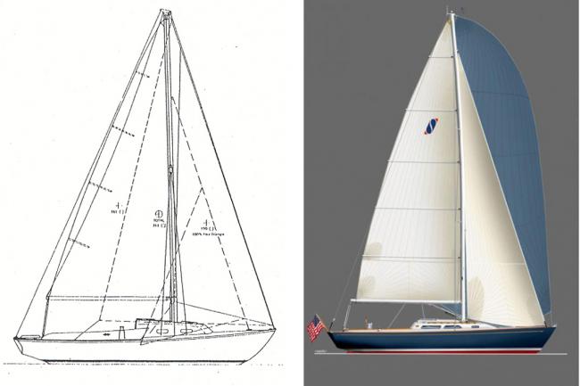

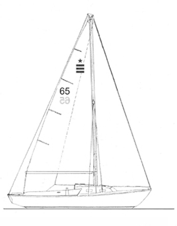

It looks like an assumption was made that the sails for Commander and Ariel are interchangeable. Is this so?
May have missed it but sails are not mentioned in our Manual equipment or promo lists.
Has anybody tried to interchange sails? It seems noticable that the boom is carried higher on the Commander which in my non-thinking assumption told me that the mainsails were the same. Or actual masts from each could be measured viz masthead to gooseneck...
A sailloft that makes sails for both will have the measurements.
And masts on the two boats are in exactly the same position....Is this so?
If it really is not known if the sails are the same then both boats could be brought up to scale and measured by the above method.
If mast, boom and sails are the same (as they appear to be from the Manual)
You could take that nice interior view drawing of the Commander (pg109) and patch a nice Ariel sailplan drawing on top of it.
Notice, by the way, that someone, maybe Alberg, doodled in a BABY STAY on the small Commander profile in the upper right of pg109.
On another thread we discussed adding an inner stay.
Here it looks like Alberg beat us to it!
Then take it back to the copy-shop and have it enlarged to whatever size...
One inch to one foot.
