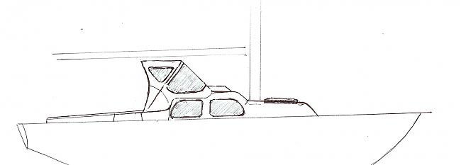

The dilemma: round or square?
On going back to Steve Marshall's blog and looking again at his 45 public shots....
On the top row we are treated to an actual wrap dodger install. There is adequate detail to be able to imagine this dodger on an Ariel. And it does look like this design would allow headroom in the corners of an Ariel cockpit - maybe NOT? A full size informal mockup would be needed to be sure.
Marshall seems to say the dodger is a foamcore composite? It doesn't look heavy. We do get an interior shot We do get to see the dodger installed in a very cropped shot.
My purely subjective feeling is that, as shown, it wouldn't be appealing on the Ariel unless it was tilted up in the cockpit area. As I keep saying. It also is easy to imagine the sides going out of curve and straightening quite a bit from the coamings up to allow that tilting. The 'top' may even need to be shortened to allow EASY exit/entry below.
If the dodger is part of a cockpit privacy/wind/rain enclosure, that needs consideration in the design. Another argument for a more squarish shape.
Imco..This particular Marshall wrap dodger also needs more visability THROUGH it.
Another good thing the truck-cab dodger has is the option for flat glass lights.
That would make for distortion free visuals. A big plus. That would mean the glass could be in at least THREE pieces, allowing the center to be opened for ventilation. There is no reason why glass couldn't be used for the center, with lexan used for the sides if curving was needed.

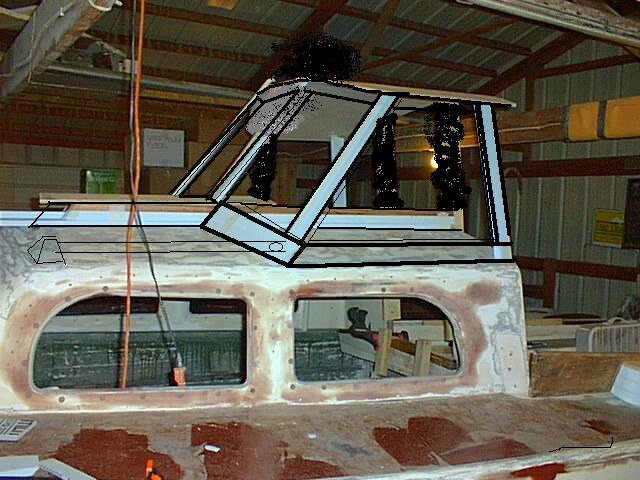

Hard dodger center opening
Hi epiphany
I cannot remember seeing the cut out as shown. I'm sure it would aid access in a low profile dodger but the trade off would be a loss of strength across the back edge and no continuous aft edge grab rail.
This could be partially offset by creating an up tuning rim around the opening of say 2" depth which would also provide water proof rim to a minor extent.
A thing I have seen on a friends boat, and this was around his center cabin hatch.
A rim of bolt rope type sail track was fastend around the front and sides of his hatch onto the deck.close to the hatch base.
A fabric cover with bolt rope edge and thin battens in pockets was slid into this, that when pushed up wards by the hatch being opened formed a wedge.
The batten pockets were positioned to line up with the side edges of the hatch and the batternes supported the fabric over hang that was some 5'' longer than the hatch.
This gave excellent protection from the weather while sailing with the hatch open this same idea might apply to what your suggesting ??
Steve Marshall

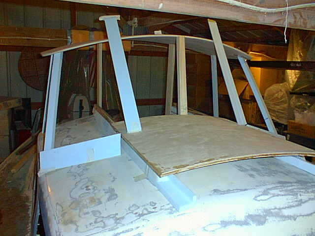

why not a dodger with a hatch?
Hey guys...over here at the end of the bar..
Taking Kurt's idea of a top that needs to be opened to provide more dignified egress to the galley.
His drawing shows that opening.
and Steve is saying that cutting the panel/top will seriously weaken it. True, true.
From the forward corners of the opening put in a couple struts down along side of the sliding hatch.
Right? They won't be in the way of anything. They'll go from the coachroof right next to the slide and up to the corners of the cutout in the dodger - the two legs won't impede the sliding of the hatch.
Won't impede anything going on in under there...Right?
Let's take any bendiness out of the dodger edge and the new opening by trimming it out or doubling it.
Let's play with the position of those legs by moving them back a little to take more of the load. Might work in a couple gussets to make it near impossible to move those corners of the top. Nah, don't like gussets.
AHHH but leave those legs still at the corners, and put in a couple more toward the opening. The first two immobilize the top, The second two support the wings of the top. They probably don't have to be at the end of the cabin top but maybe half way in.... but still bracing those corners.
I think they could be legs las simple as 2x2s. Not panels which would separate that nice space under the dodger. I can't think what would get in the way of these support legs - except the winch handle. Probably arrange the four struts so they are out of the way and nearly unnoticed.
If you are rich enough to have s.s tube grabbers on the dodger, they don't need to be exactly along the outer edge over the cockpit but could be inset to correspond more or less with the struts inside. The struts are locked in to the coachroof. Locating the exterior grabrails near the interior strut join would make for a solid feeling construction.
And the struts could be nice shiney stainless tube too.
If tube works there, the appearance would be more like grab rails and not like structural pieces at all. I'll bet the project would end up almost as rigid as an unbroken no hatch dodger! These vertical grabrails might even work just that way.
Go for it Kurt!
Just throwing this out on the table....;)
hard dodger opening suport
Steve Marshall

Just for argument, the photo sez: Definitely homebuilt, DIY.
Nothing wrong with advertising homebuilt, Some designer pointed out that when making these additions the sight-line of the appendage should point to the stem fitting. They should tilt forward, if they are tall enough. I've noticed that this is good advice for hard dodgers that often make a boat look like it has a pilot house. Or extra cargo.
Soft dodgers which USUALLY don't confuse the boat's lines are often horizontal topped. But then the eye gets a discount when pram dodgers are a darker color than the boat. When in doubt, paint ANY dodger a darker color.
A hard dodger is the most difficult thing to add to a sailboat and make look acceptable. Some boats make it into the character stage where the skipper's personality tops the boat's and the amalgam is completely happy, or otherwise. Usually the color scheme is the give-away. There are boats that are too small or too large to obey this tradition.
Anyway, that the top of the dodger or any other large addition to the exposed deck/sheer of a boat, lines up with the deck at the bow, is a place to start from when designing something the critical eye will accept. Easy as drawing a line on the elevation plan to check it out.
imco It's a reasonable aesthetic that takes into account windage, greenwater and design. Streamlining tells a lot about a fish's lifestyle. Or a boat's, for that matter.
From that datum you makes your compromises.
