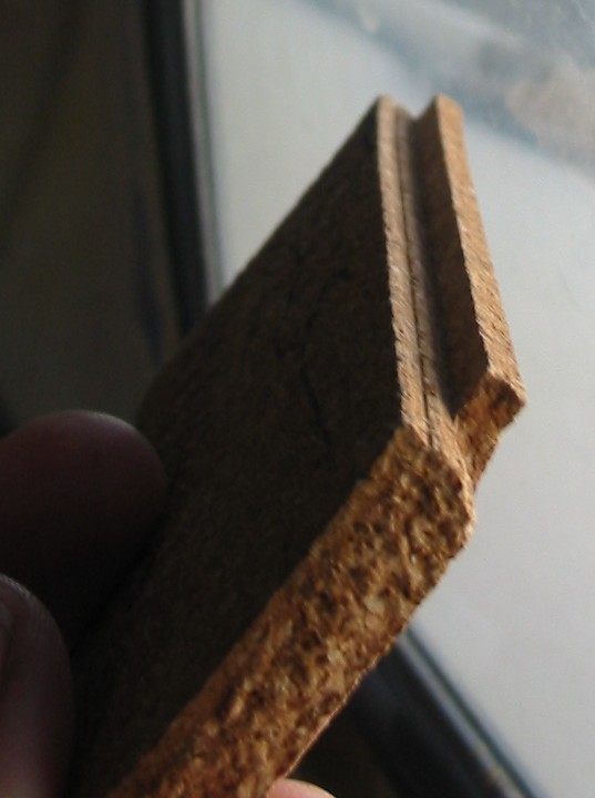

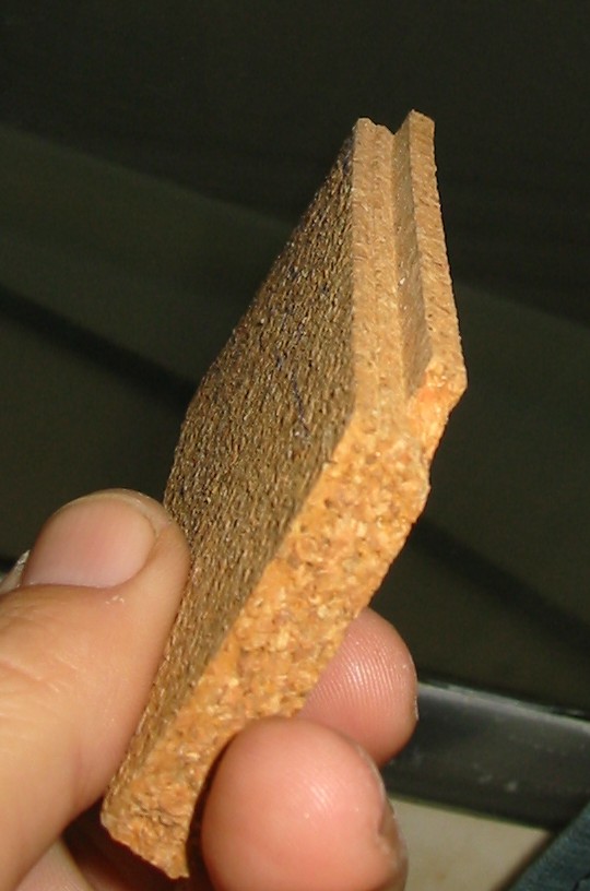

Yes, I have noticed that pixels have a hard time sometimes to rep a straight line. YET that excellent thumb shot does seem to show a very corky material anyway, tho not wavey. I got to see that stuff live on a deck. What a teak deck has going for it is its surgical preciseness. I'm convinced that laying a traditional teak deck takes an artist. It would be fantastic to have an alternative with all the attributes claimed for cork. Is it going to hold up when doing the finicky work like bordering and nibbing the kingplank? Can I shave iit with my lowangle plane?
