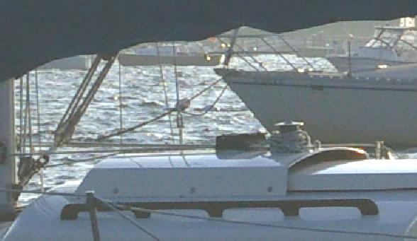

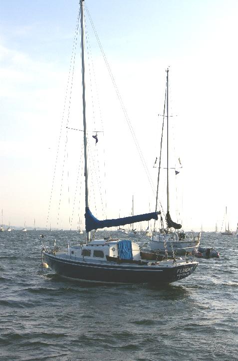

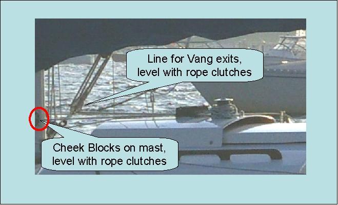

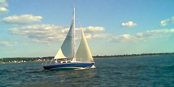

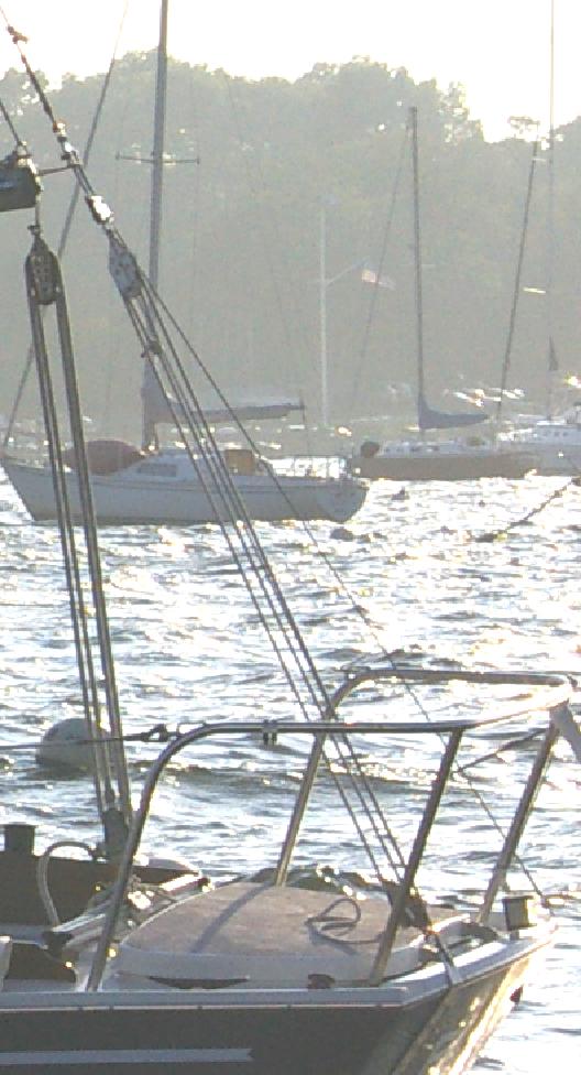

Alyce and I spied a pretty boat near Bristol,RI that we had not seen for a couple years. When we closed to hailing distance we found she was "Fluent" A-250(?). We passed news of the association to the skipper. Hopefully he'll join and we'll get a full report. Short list of interesting mods... Westerbeke 12hp IB, Split backstay with tension control, Sea Hood and I'm sure lots of other cool stuff...

Sorry about the resolution, all we had on board was a cell phone and a sketch pad:;)

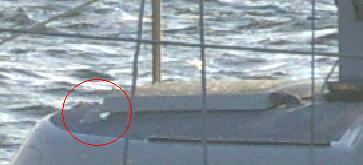

Duno what 338 will have. I've got two Bomar deck hatches up there that'll catch line just as easy as the original!
It's a good idea probably for an offshore boat to have exterior 'coaming' around three sides of a hatch like the Bomar's which are merely gasket pressure sealed - to direct green water over the lid.
I've seen stainless coaming around mega yacht hatches. I can imagine a line and water diverter as a sort of molded deck extension in fiberglass closely surrounding the hatch. With glass it could be made a softer shape and less of a toe or knee killer than metal.
Something in vinyl might be even better, if they made it. It could be installed relatively close to the hatch so that the hatch would provide stiffning. It could have soft corners and be renewable.
(As a emergency flood barrier inside a barn here on the ranch - which has pool heaters, water pumps, and water treatment utiliies with miles of pvc pipe - the containment CURB on the floor is ensolite foam covered with a tough vinyl fabric. The triangular section curb is glued to the concrete with polysulfide and fabric corners are made by gluing over-lapping flaps of vinyl to itself. A forklift could roll over this stuff and it would pop back to its former self. Something like this but much smaller would be a good addition to the deck on 338. A soft and tidy barrier protecting a projecting hatch that you GLUE on I'd be very interested in!):cool:
