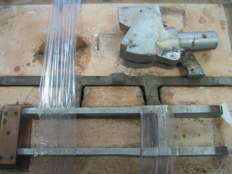

I've been wrestling with the need for new tiller hardware for A-231. we have before us three sources off the shelf...
1. The ensign/electra/ariel/commander tiller casting based on the original rostand pattern is available from ensign spars.
2. Bristol Bronze offers something very similar to the rostand but the tiller head is through drilled.
3. Historical Arts in Utah doesn't have our model in the pattern collection, but the've got the next size up. I've ordered the same shape originally made for a 1.5" rudder shaft. It has more room for a wider tiller. I expect it will be here in a month or so...
I'll stick with the original style for now but just a wee bit bigger (option 3)..

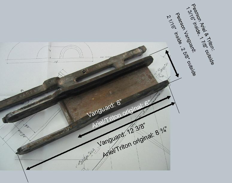

Historical Arts has one other tiller option (originally offered for a 1.25 shaft).
the tiller head appears to have been meant for a vertical rudder stock withthe tiller at 135degrees to the rudder stock (like the bill shaw pearson 26). there is a lot of meat in the tillerhead that could be cut back to allow the tiller to rotate down to 90 degrees and still allow the tiller to be fully in contact at 135degrees to the shaft.
the dimensions on this one are (11" long, 1.75" wide tiller (inside), 1.25" shaft- although it can be drilled for 1")

The Ronstand pattern at Historical Arts looks like the fitting I have. Exact replica. I still find it wanting, still find it too much of a compromise and wrong for properly fitting a wood tiller to.
So we'll see.
Historical Arts has traditional skene chocks too. Skene chocks are line UNfriendly,
tho the Ronstand pattern they show in the thumbnail on their website is not as bad as some skene chocks that tradition puts into the market today.

That pipe tiller fitting is right-on! There is no reason why a modified version of those ears could not be part of a modified version of our fitting. IS THERE?
NO reason that the tines (let's call them) that hold the wood tiller could not be widened on a new pattern. IS THERE?
And ebb says rotate the tines 90 degrees so you can hold a laminated tiller better.
I can't say i've seen a tiller casting with a frame top and bottom.. in such an arrangement, all of the load on the tiller will be born by the bolts. While it would clamp a laminated rudder well, I'm not sure the result wouldn't just be a vertical split thru the tiller along the line of fastners (maybe you could wrap the butt of the tiller in two layers of 6oz cloth before installation).
I'm going to try the 12 inch long version from the Vanguard. I've held one at a marine consigment shop, it wasn't much heavier than the original 8.75" version (just a couple pounds) and it has room for a 2 1/16" tiller. which is the size i'm using today (more non-standard hardware)...:)
