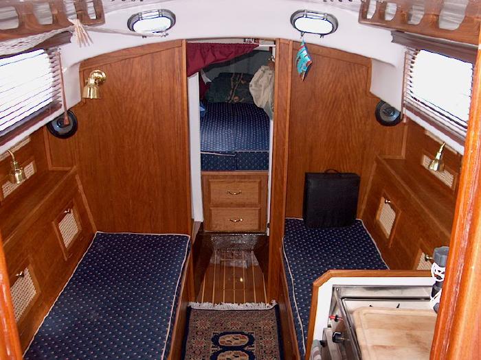

We have just finished the interior of our boat. We decided to remove the headliner: stained and ugly. Condensation is not much of a problem here so we painted the top. In fact, we painted the overhead and every vertical wall with Brightside Hatteras Off White. Previous owner had installed beautiful teak backs to the settee berths and trimmed out the shelving with oval openings, and great trim elsewhere -- nice work. So, we have chosen to go with lots of white on the other surfaces, trimmed with plenty of oiled teak, and green cushions and back rests. Simple and attractive -- and bright. The interior seems 10 percent bigger. I'd be wary of the oppressive feeling of a dark overhead on such a small boat.

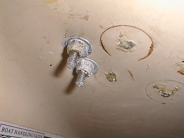

Yikes! And for one last horror tonight, how about a set of these... as you can see I have alot of work to do yet. Thanks to other photos post here and Tim's web site and others I have been inspired to do something...well let's just say something.
overhead
I assume those long bolts are for your hatch hinges,I would cut thoses bad boys off before someone bust their head open on them.I know my head would find them every time I was up there.I can feel it from here.Cool companion way doors.
Yeah, you're right they are and they should be! There's another set on the port cabinliner for an old SouthCoast winch. They all gotta' go. Right now I'm about the only person that goes on board and I very aware they are there(read missing scalp). We've attached a photo of the main'woobee' in the cabin liner. It can be flexed up a good half inch, maybe more, and I'm wondering if anyone else has that much sag in their's.

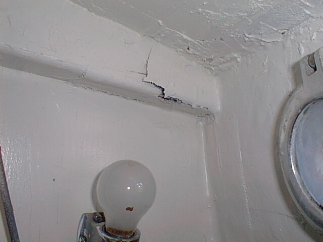

If you want pictures I'll post pictures! Only don't look foor pics of me sailing because so far I've just been snapping pics of scabs, scars and scary stuff that needs fixing. It sort of frightens me that I've aquired SO MANY of these in my file. Friends think I've bitten off too much this time. Oh the sad doubters they are. I WILL NOT CONCEDE-I WILL ONE DAY SAIL THIS BOAT!! Okay, enough of that. This one doesn't look as bad as it really is.
even more pics
Shortly after bringing #113 home I left the forward ports and the main hatch open in an effort to rid her of that 'funky' been closed up tight all winter smell. When I was busy at work a rain shower moved through and this is where all the water went before it leaked out the rudder shoe. Yeah, and this is where I suspect it will come from if I don't fix that. (We're up to like five or six on the list aren't we? 'Haven't even scratched the surface!)
