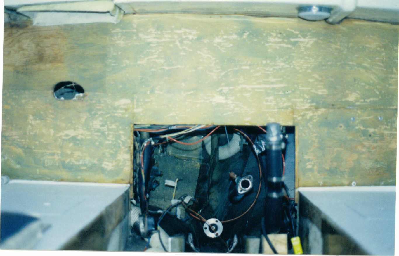

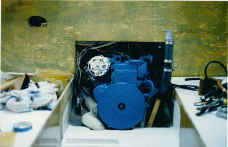

Does anyone have an inboard model where the atomic 4 engine
was taken out and had to remodel the galley because of it.
If you have any pictures it would be greatly appreciated

The Atomic 4 comes right out.You dont need to remove the galley.
Unless you really want too.
I came up empty using the "search" function, would anyone share their ideas and knowledge about some way(s) to get the Atomic 4 out of an Ariel??
There was an article in the newsletter way back in the early '90's (maybe late '80's?) where someone did just that. As I recall, they first had to remove most/all of the galley and then used a plank on which to slide the engine into the main cabin where it could be hoisted out. :D See page 56 in the manual for a little more detail. If the author is still around, maybe he will check in . . . :rolleyes:

If you mast is up, the halyard and boom have the makings of an engine crane (been-there-done-that with a 4 cylinder westerbeke)... or with a couple of jack stands and a come-along you can kludge together a gantry:

I figured when the time comes I'd use a lever suspended off center, the short end would goto the A4 the long end pressure woud be applied by hand, giving fine control of the height, and solving the issue that you cant just link up centered on the A4.
the A4 is about 350lbs if a foot and a half off the short side would reach under the bulkhead to the center of the engine, 3 feet on the long side would need +175 lbs force to lift (if my thinking is right) but being I weight 170 I'd ballast the long side.
