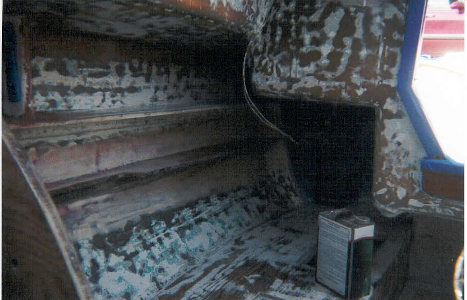

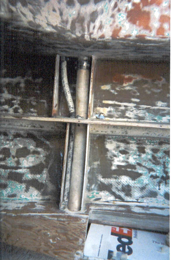

I finished stripping down the interior. No walk in the park. I originally intended to just sand down any flaking paint and rough up the rest. Didn't work out that way. Once I started sanding, more and more paint wanted to go.
What makes it difficult is that the surface is not smooth, lots of hills and valleys.

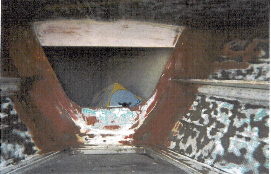

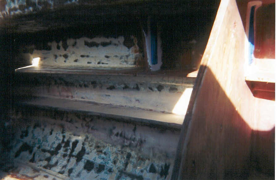

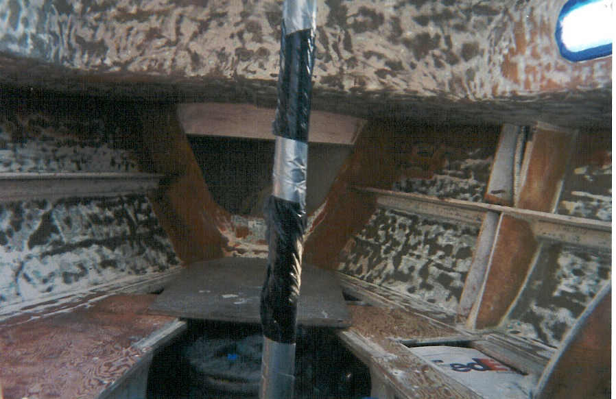

Here's how it looked after I sanded it a few times. The white areas is the old paint (low spots)
A few days after I finished sanding, more paint would start to flake. Back at it again. And so on.
I ended up taking off a whole lot of paint.

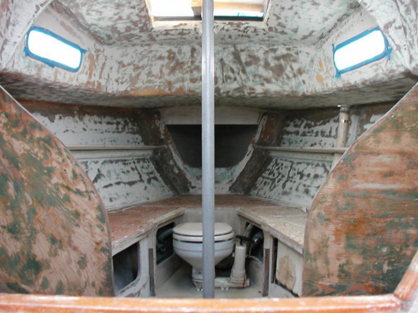

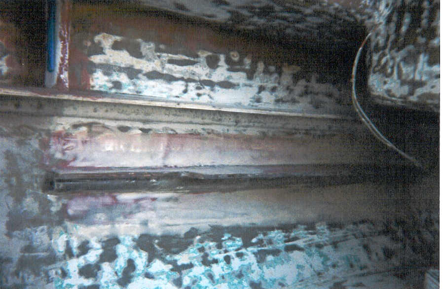

The brown, chocolate colored areas is a fairing compound I mixed with epoxy and phenolic microballoons. This covers the spots where I fiberglassed the bulkheads, corners and hull deck joint.

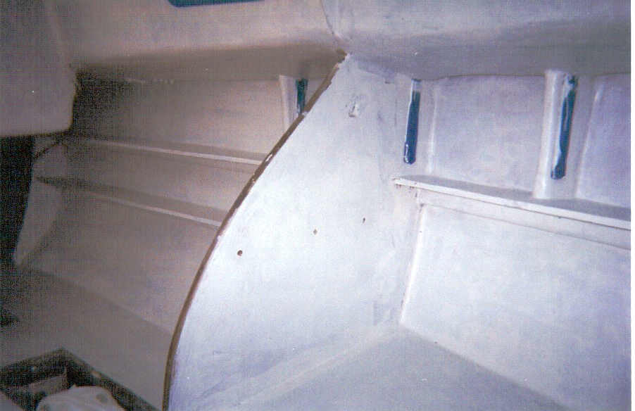

I also fiberglassed a new (lower) shelf on each side of the boat. This is the starboard side, looking aft.
Sorry, that was the port side. Here is the starboard side.
The starboard shelf has a cut out so I can open the drawer of the galley.

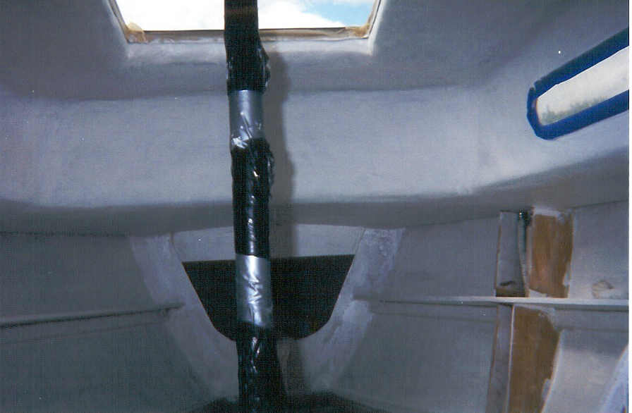

I have a head with a holding tank. The hoses leading up to the deck were exposed. I'm building a little box to cover them. Still need to cut out the front covers.
Just about ready for painting.
You might be able to see a little of the original, green paint.
I'll be painting the interior the same shade of green. Both because I like the color and in the interests of historical accuracy.
Just kidding.

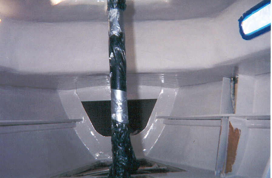

A coat of primer sure helps to brighten thing up a bit.
I have one top coat on now.

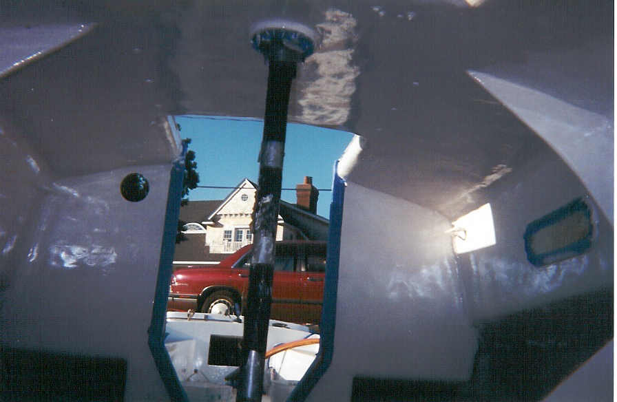

I had to paint that ugly hole I've been calling a motor well.
I beefed up all the chainplate areas with fiberglass. Of course, now the chainplate screws are too short. I have some longer bronze screws and washers coming from Jamestown.
All the hatches needed painting. I used two part paint on the outside and Brightsides on the inside.
I think one coat of primer and one top coat is enough. I'm calling this job done.

For the new shelves, I have some nice 3" teak rails to front them with and keep stuff from falling off the shelves.
When I fiberglassed the shelves, I made sure the wood didn't touch the hull. I formed the brace underneath by using soft pipe insulation covered with layers of glass. The shelf is glassed about 4" to the hull on top, and about 6" below.
It's my typical fiberglassing job. A bit sloppy but tremendously strong. I had to sand down the lumpy parts and fair it (twice).
