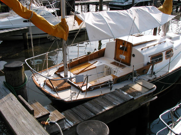

Someone about a year ago was talking about changing their Ariel over to a yawl. I coulnt find the post but heres a picture of a Tartan 27 yawl that might give you some ideas..

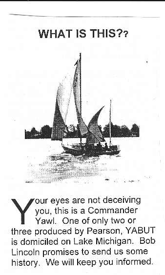

From the cover of the January 2000 Newsletter showing Bob Lincoln's factory built Commander Yawl "Yabut"
Looks like he's flying four sails!
Maybe this scan will work
Sorry to say, we have not been able to get a response from Bob other than the above photo.
It's a mizzen staysail , the yawl's secret weapon . Totally unpenalized sail area .
I hope you don't tire of these stupid maybe redundant questions. In CP's attached photo doesn't the foot of Yabut's mainsail look extraordinarily high? I that a characteristic of yawls (or maybe just smaller yawls). I scanned back to Steve's Tartan 27 photo and that boom seems mush higher than I would have expected. In regards to the split backstays (here we go-sensitive subject again:D )are you forced to install double backstays or are they/it just split to a certain height? If they're double are they set up like running backstays so you could ease the main out as until you start rubbing the lowers? Or do the chainplates attach to the corners of the transom so there is plenty of clearance? Where are the attachment points for the stays/shrouds of the mizzen mast(is that what 'that thing' is called)? What about issues like mast height and boom lenght? Are they calculated by some formula based on sail area or displacement or righting moment or is it less scientific and more asthetic?
Maybe the orginization should 'put the squeeze' on Bob Lincoln for some more info on that sporty Commander. How 'bout those other factory yawls-where are they now?
I'd appreciate it you could educate me here as you just don't see many sailboats period around this neck of the woods and a yawl is totally out of the question. I have a few good books here on maintenance, tactics, seamanship and the sort but nothing that really digs into these matters. thanks Tony G
The boom height is misleading in the photo , Commander's look to have a higher boom , while it is a lower cabin you see .
Yawl's boom placement is the same for sloops & cutters .
The main thing is no "el kabong on the noggin " on any small boat .
