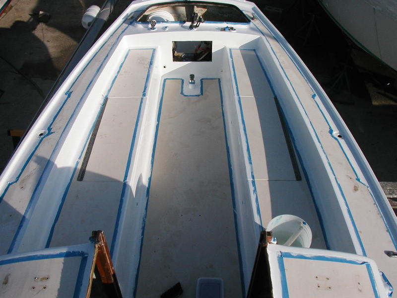

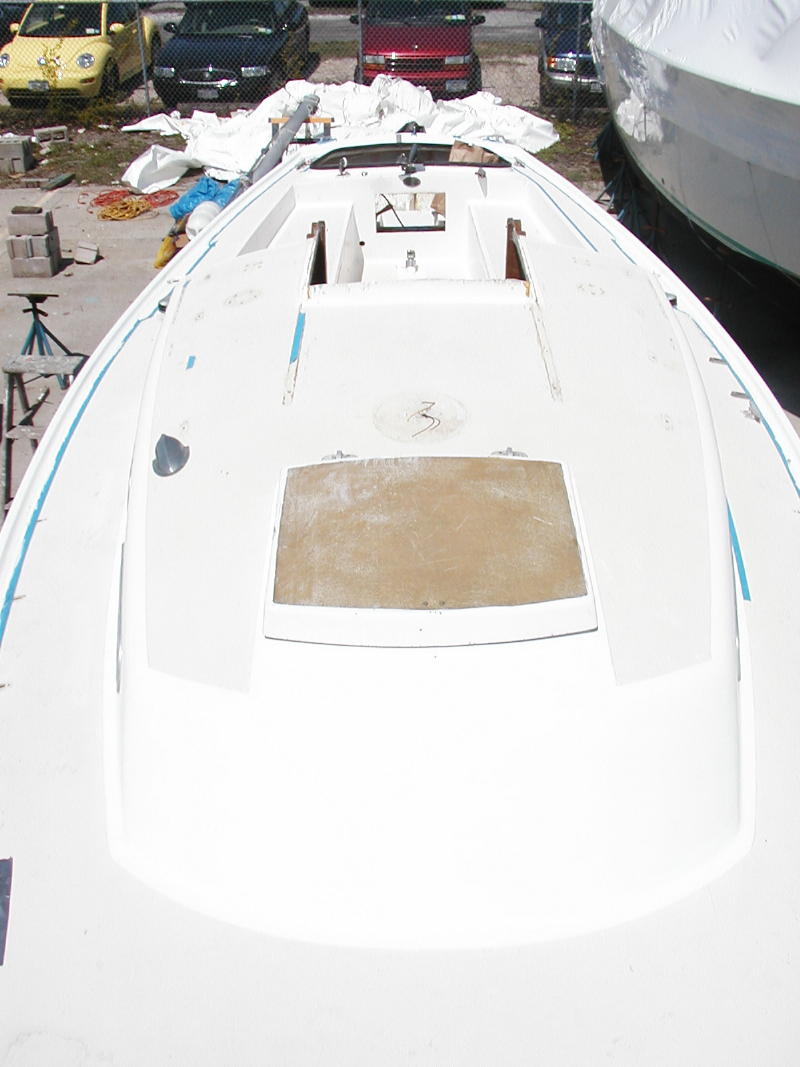

Topside
I've taken much of the hardware off, which I'm rebedding in the proper manner.

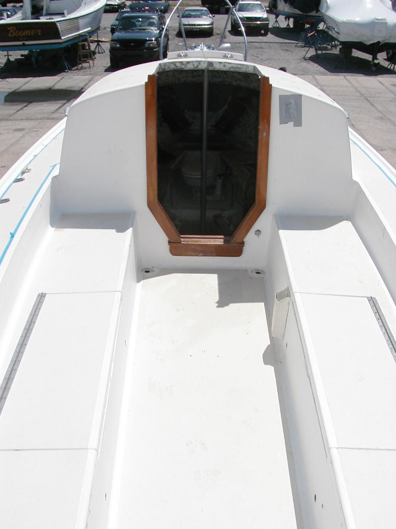

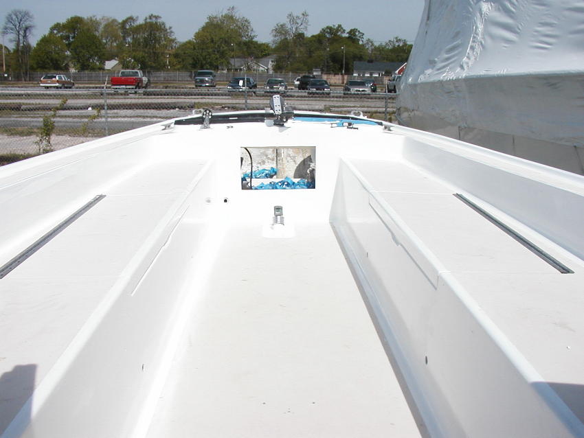

This is the famous Commander cockpit:
Since I have the boat stripped down, I thought it would be a good time to paint the topside. The topside was in pretty good shape actually, no crazing of the gelcoat and very few stress cracks. But, it was oxidized yellow with some stains I couldn't get out.
My friends told me I could just use a fiberglass restorer or sand with 400 grit. They were probably right, since it looked better after I sanded it in preperation for painting. However, I've never been swayed by appeals to reason and common sense. So, I'm proceeding with the painting plan. I'll be using the Interlux two-part Interthane on the topside.
The cockpit will soon be available to rent for Weddings, Bar Mitzvahs and other special occasions.
HEY, this isnt what I thought it would be!!!
I didn't know the Commander had such as long cockpit. I'm impressed.
What a sailboat. Long, low and lovely. She has to be fast.

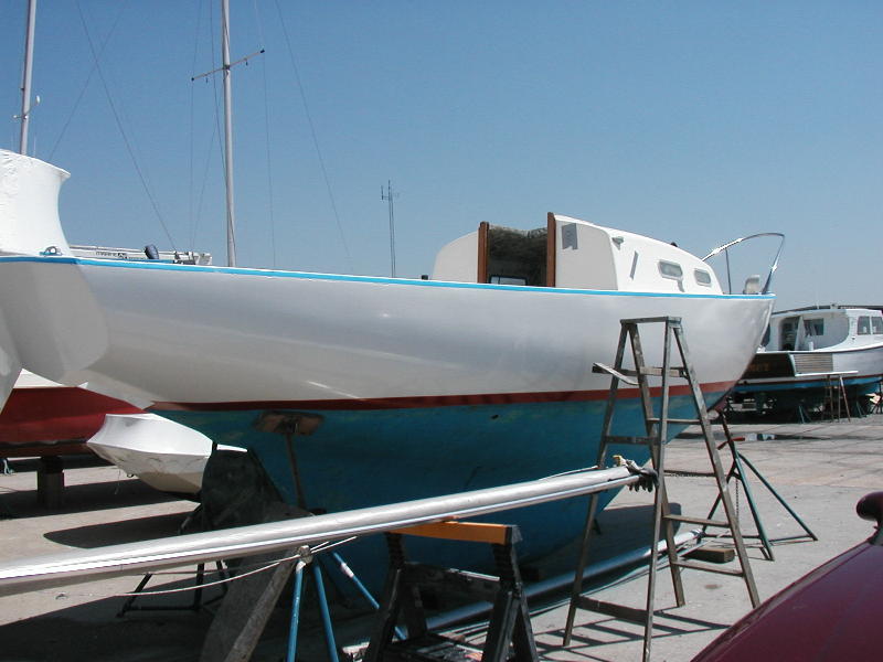

Check out that waterline

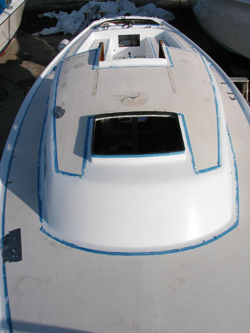

Two coats of primer and one top coat on so far.
The primer goes on thick. It has a consistency somewhere between heavy cream and pancake batter, and fills some minor defects.
I probably should have gone around with some epoxy fairing compound before painting. But, I'm not looking to create a Sirocco or Glissando here.
The first top coat came out poorly. It's actually a three part mixture. I probably should have thinned it more and not worked it so much. Now I'm sanding much of it off :Ugh:

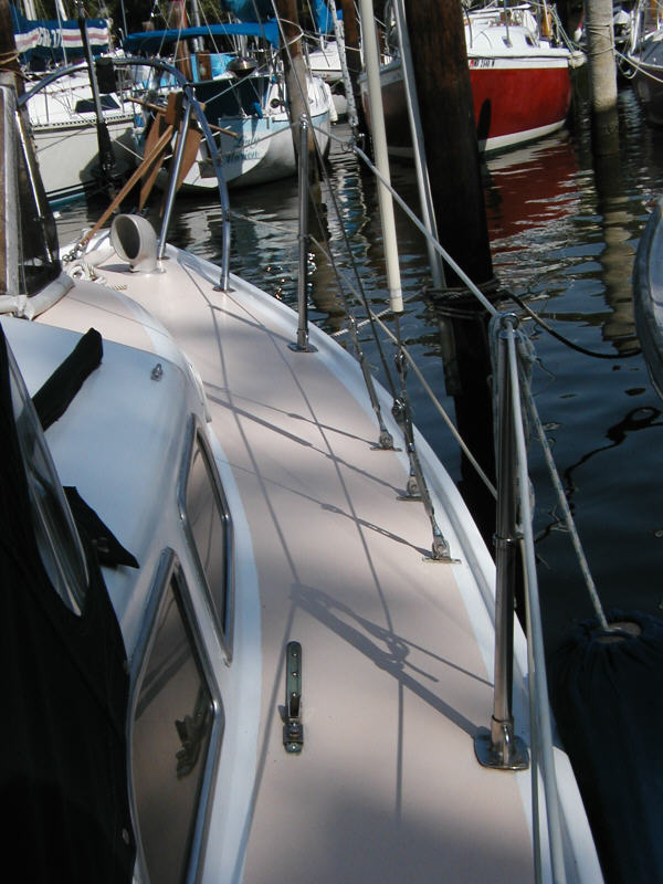

Capt. Pete(gave you a field promotion),dont forget the nonskid while your at it.
Tim, thanks for the encouragement. I'll feel alot better when I'm back in the water chasing down those tubby Hunters.
Steve, I'll have to leave the non skid for another year.

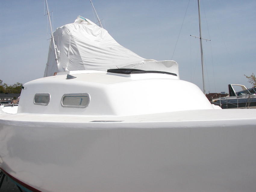

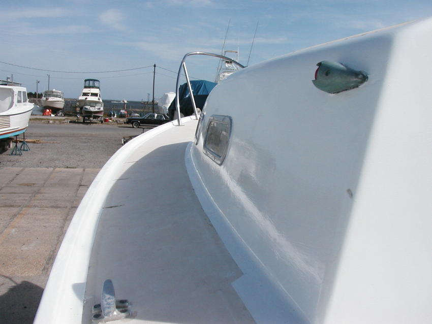

The topside painting is done. Partial victory declared.
I ended up with 4 coats, wet sanding in between.
Very tricky stuff, this two part paint. I hope it lasts.
At least I didn't fall off the boat and break my neck.
Should really have some scaffolding to do this job.
