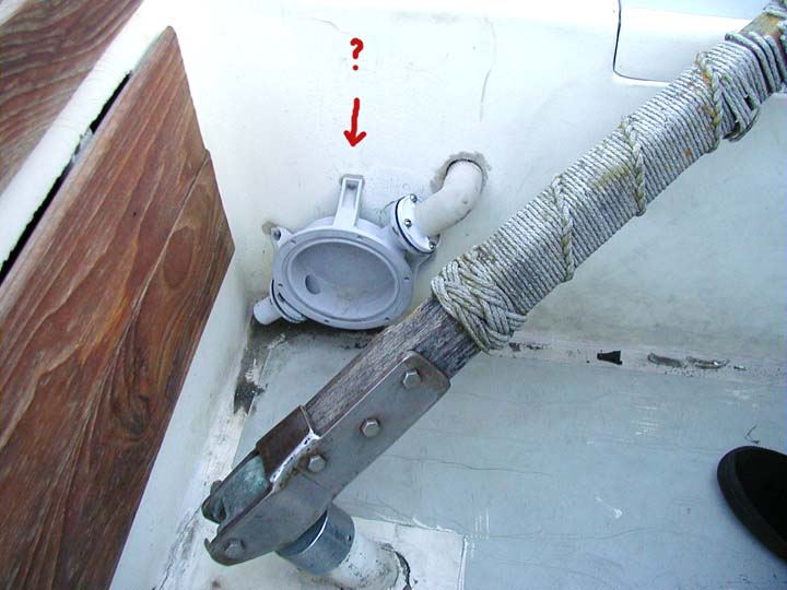

Any one know what these are for.
item one:
item one:

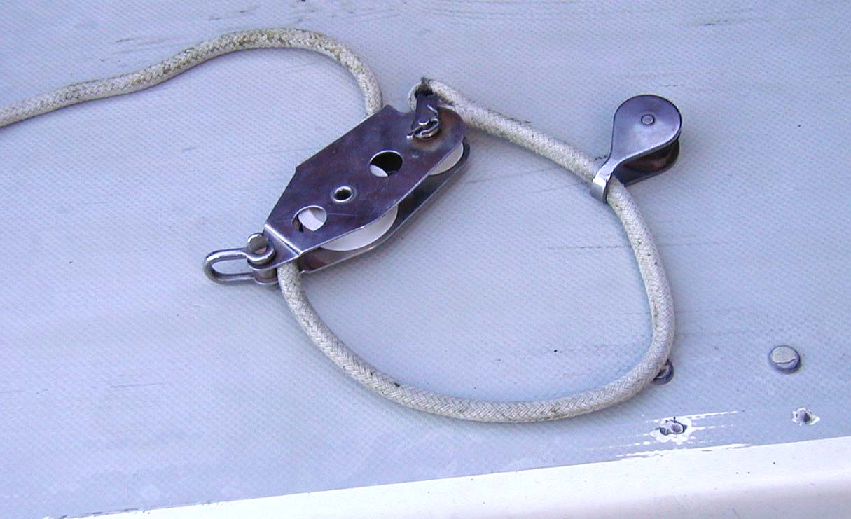

The second part:
#1 looks like the block with jam for a down hall,#2 bottom part of a bilge pump.I see you still have the old style of rudder post bearing,does it leak?

Down haul block w/jam... that would be for the bottom of the boom or tighting the foot of the main sail...? Both of these are just tied now. When I got the boat there were extra things laying around in a drawer. I'm slowly piecing thing together as they should be.

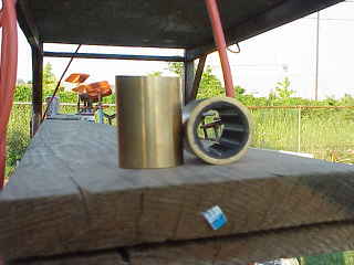

Not on Sirocco Bill,I bought Sirocco from the original owner 11 years ago the old man I got it from was too tight to replace the toilet paper let alone the rudder cap bearing,it had the original cap With 2- O rings just like on Frenches boat.I have only taken 2 apart the other was a Trition and it had just the cap also.The bearing as per the drawing in the manuel is what I show and had made in the rudder post picture ,it wont fit under that cap.I dont see why you would need both ,they are both the same thing.The only reason I would see to take this apart is if you have an inboard because the prop shoots water up the shaft.Anyone with an outboard should probably never see this problem and never have to touch this.It had to be a change from Pearson.What do you have ?Lets see a picture.

Mine was just a cap with an O-ring , I added a piece of cutlass bearing , works great !

Here is what I put under my cap ;
Gives a lot of bearing surface and now there is zero wobble in the shaft .

Mike,thats a smart idea.I assume the cutlass bearing fit down in the tube without any modificationYou would still need the cap with its 2 o-rings to seal out the water.My cap was shot and would no longer keep out the water so I would of had to have another one made.The bearing I had made from the Pearson drawing has 2 places for the o-rings.

I just measured the tube & shaft , it happens to be a common size for a cutlass bearing , all I had to do was gently tap it into the tube with a rubber mallet .

On closer inspection of my cap it would seem that the sleeve/bushing on the rudder post doesn't come close to bearing on the shoulder within the cap ... but it will when I get done with it!!! I priced a cutlass bearing...Yikes, I couldn't have afforded that when I did live in Kalifornia. Certainly can't living here in Maine. But I can exercise the 2nd Ammendment.:D
As I mentioned before my cap has a shoulder of a smaller diameter than the section that sets down over the rudder post tube. This shoulder surrounds a sleeve/bushing on the rudder shaft but still leaves a gap in excess of 1/4" all around. So the only real bearing surface currently is the hole(& o-ring) in the top of the cap that the rudder shaft passes through.
A friend has some teflon sheeting 3/4" thick that I intend to cut into a donut shape to fit into the cap and surround the rudder sleeve/bushing. I will pin the teflon donut in place within the cap to keep it from shifting and it will also be easy too replace with a new donut as required. Should work slick. The teflon is very tough and my friend has used the stuff for bearings in fish feed barges for the past few years and notes there is very little wear.
