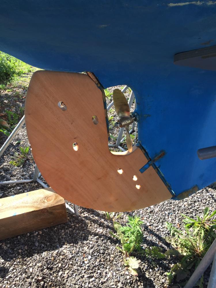

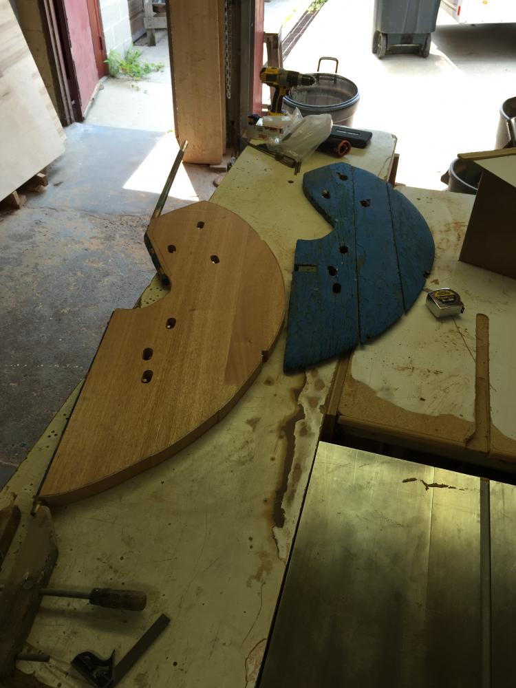

If properly built, a new rudder is going to cost several thousand. I made one out of mahogany last year. The rudder shaft was in good shape, and could be reused, but I replaced all of the bronze hardware (lag screws and drift pins, etc.). Cost of materials was probably less than $500, but it took me about 40 hours start to finish - and I had access to a professional grade wood shop. Luckily, my original rudder was on hand to copy. But after 50 years it was time for replacement. The new rudder got a few coats of bottom paint - nothing else. Hopefully it lasts half as long as the original!
...here's a photo of the new rudder after installation.
nice looking rudder!
aoquinn,
Looks like you've maybe included a mild 'airfoil' taper to the mahogany...?
The parts list with the page 170 Manual drawings also don't look like what you have for the original.
Also missing in the Manual list are the 'drift pins' used to attach the third plank.
Can see 1/4 or 5/16 hexhead lags bolts here. What did you use??
Notice any difference with the extra square inches on the trailing edge?:cool:

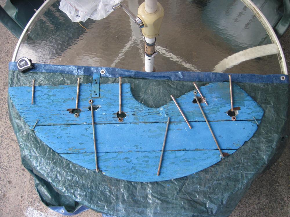

Here's a photo showing the approximate configuration of the rudder hardware. Checking my notes, it's all 3/8" bronze, which was sourced from ccfasteners.com for $125. The mahogany cost $140. Access holes for the internal nuts were filled with autobody filler after the rudder was mounted to the hull. Then everything covered with bottom paint.
One of the more challenging tasks was aligning holes at different angles through all three boards. It would be easier with a drill press large enough to accommodate all three boards AND a drill bit long enough to get through them.
Attachment 9901
Great HOW TO photo!
Can see how that takes some of the mystery out of how the traditional rudder is made!
Can really see for the first time how it was done. But a while ago I went with a straight
stock, meranti and glass composite, without the cutout. If I wanted to do the original
rudder, I would also use unthreaded rod, but looking at the drawing from the Manual
and your photo, I'm thinking why not have all the 3/8" fastenings at 90degrees to the
shaft?? Even the dogleg in the prop opening... stack and tie the whole thing together
wherever needed. For somebody building a new old-style rudder, with new 1" bronze

The original rudder with mid-plank peep-holes for nuts on internal bolts, really
bothers what's left of the carpenter in me. "I know, I know, it sounds like I'm

Memorize or make a copy of aoquinn's revealing blue rudder photo, so fastener
layout is right in front of us. The first plank, the one with a cutout, shows six
medium length bolts that look like they pass right thru the shaft. Three thru
the top, three thru the bottom shaft piece. The way I see it, it's really strange
the bolts don't just extend thru the plank to its seam. Assume the shaft is thru
bored for the bolts -- which are, in my opinion, well positioned on the two
shaft pieces. But we'll end up tweeking bolt positions a bit....

P.S. #3. There is that canted rod in the middle of the blade in our blue rudder
photo that looks a little too short and lost. Let's bore (at 90`) a short hole thru
the deepest part of the curve in the prop cutout thru the first plank. Continue
thru the second. And the third! Have now tied together three planks, not joined
with the rudder shaft, hexnuts at both ends. Nuts remain exposed but inset in
shallow counter bores. A major fastener is now created for the outer plank thru
its widest section in the middle of the blade. (We have, of course, separately
pre-drilled all holes thru the planks prior to assembly. No improvisation.)

HERE"S HOW THE NEW TIE-RODS LINEUP
>using the rudder blade visual from the PearsonAriel Manual<
Looking at the photo: Blade is down, top of rudder is to the right: All rods parallel:
First tie-rod: from shaft thru first plank. Second rod: 90` from shaft* thru 3 planks.
Third rod: 90` from shaft* thru first plank. (*These are the angled holes.)
New tie-rod: throat of prop cutout thru three planks.
Fourth tie-rod: from shaft thru first plank. Fifth rod: from shaft thru all three planks.
Sixth rod: shaft thru first plank. No peepholes. No extra long slanted bolts.
Tie-rods 3 and 4 can be separately extended to include the second plank, but would
not be accessible. Adding extra weight to this already heavy rudder isn't smart.
Seventh, 1/2 tie-rod: short stud threaded in shaft in the bottom of the blade.
Total: 8.
