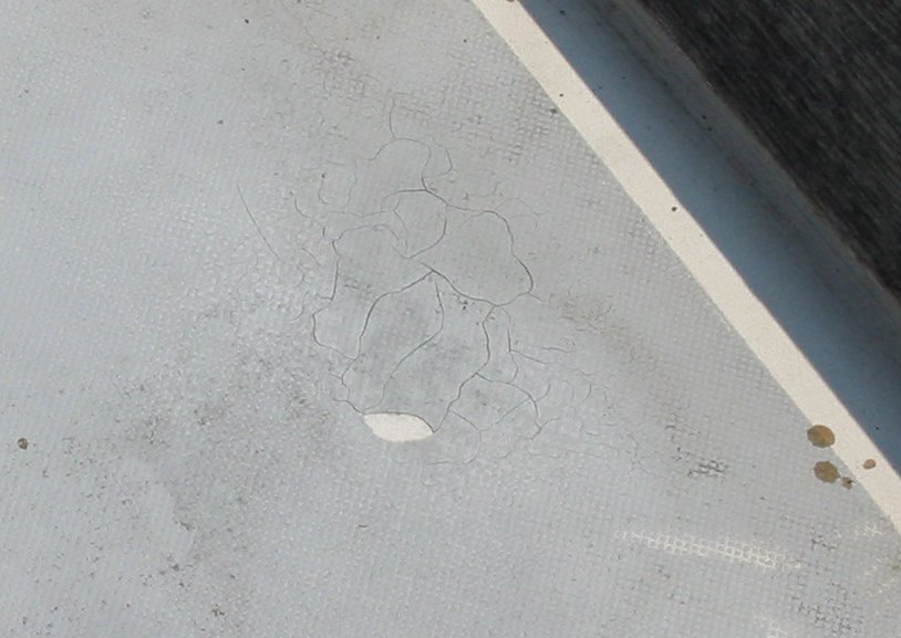

Here's a picture of the non-skid on the cockpit floor. It looks molded-in (a cross-hatch pattern), but you can see the crazing and chipping. Underneath it appears to be white.
Could this be the gelcoat chipping off?

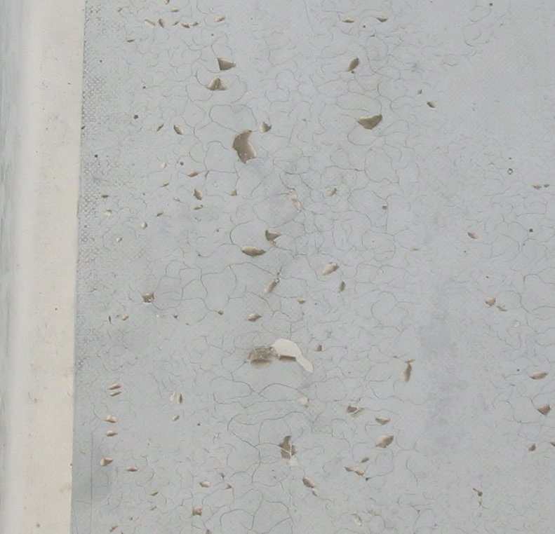

Here's another shot, this time of the cockpit seat.
If this is the gelcoat chipping, is it enough to sand it down/off? How should I deal with this?

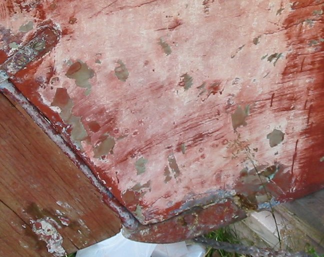

This is near the rudder; you can see where the flakes came off--the nearly colorless parts surrounded by white & red.

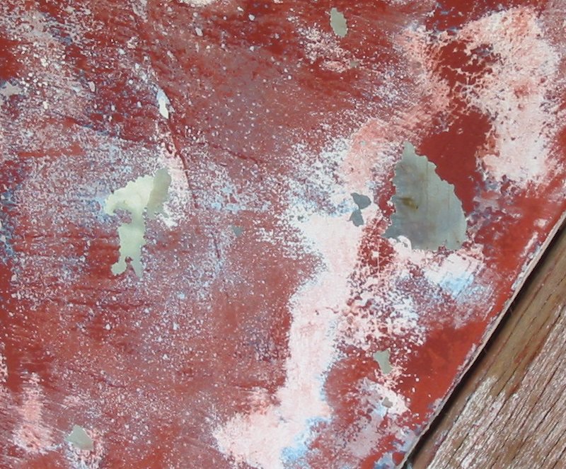

Here's another pic from the port side.
Are these colorless patches the gelcoat? If so, could the white be a primer for the red bottom paint? This is my first boat with bottom paint, so I'm a bit clueless here.
Some light scrubbing with a brush gets the red off the boat (and all over me), but the white seems more persistent. Is the white the gelcoat? Am I seeing gelcoat chipping off here?
I've also noticed blue in some spots, but I figured that was a prior-year's coat of bottom paint until someone mentioned in another thread that it may be gelcoat.
