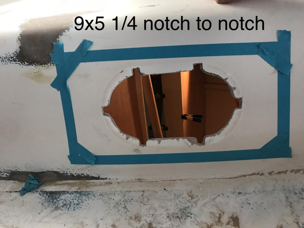

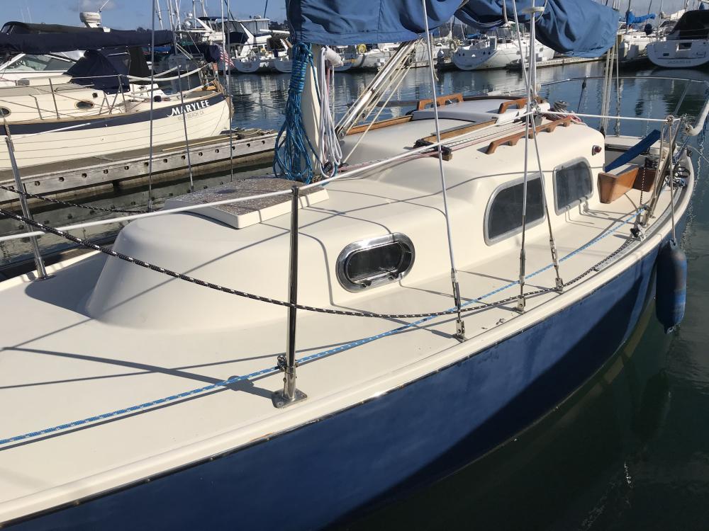

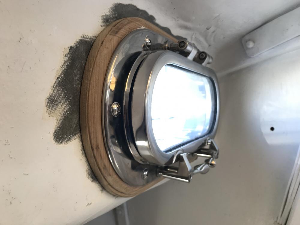

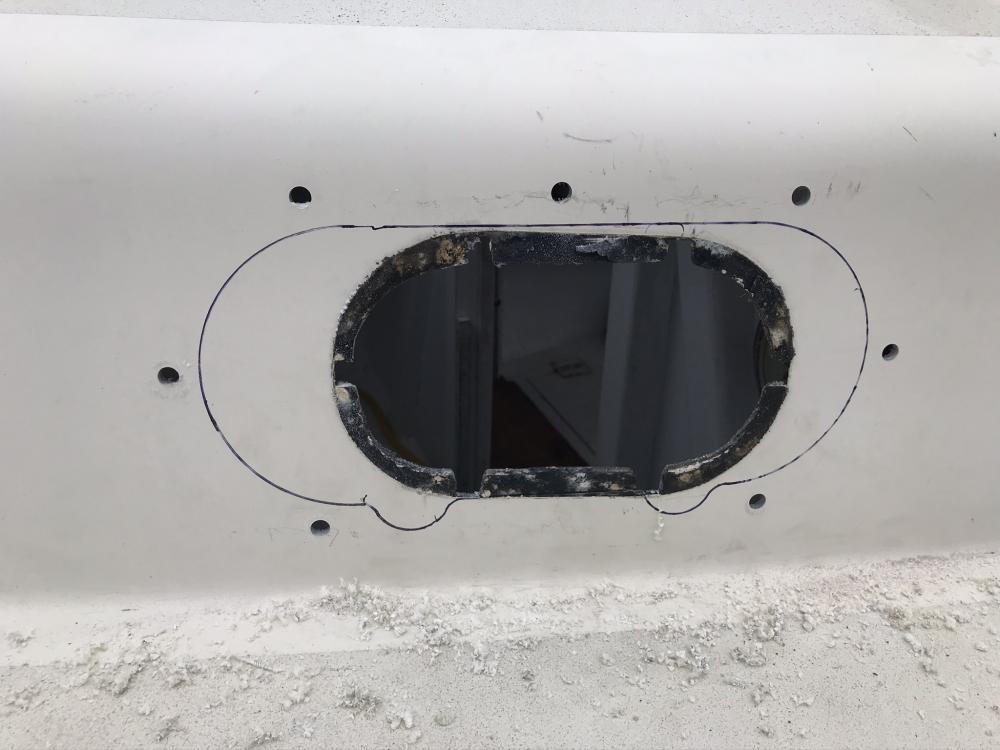

I couldn’t find anybody with the original molds. Port Townsend Foundry either doesn’t have them or they didn’t feel like dealing with me. We did some emails back and forth but nothing came of it. However, I had success with New Found Metals, also in Port Townsend Washington. They didn't have an equivalent they did have a larger portlight that worked out perfectly.
The original holes in the v-berth had to be enlarged but I’m really happy with the result. They look good and there is an increase in light and ventilation. I purchased 2 oval stainless steel 5” x 12” (model 512OSS), the teak spacers, and butyl sealant. They also provided a template that made it easier to cut the right shape in the cabin. New Found Metals was recommended to me by the owner at Blue Pelican Marine chandlery in Alameda, and I’m thankful to him. Richard at New Found Metals was extremely helpful. I recommend him highly. These portlights cost about $275 each. The teak spacers were about $60 each. The template cost $20 (100 deposit, $80 refunded upon return.

Here it is from the outside

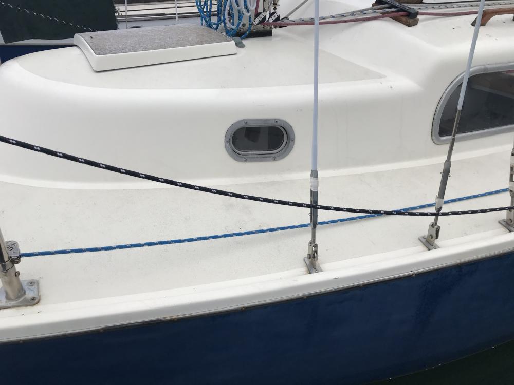

I was worried about enlarging the hole in the cabin because there’s quite a bit of curvature but it worked out OK. This is the original portlight. One of the dogs was broken on this side so it didn’t close properly and was a source of water entry. The starboard side portlight had a crack in the glass. I saved the old parts, someone could probably make one good, original portlight from the old parts. Hit me up if you need them.
Here’s one more photo showing the placement of the larger portlight
Those Newfound Metals windows are the Boss. I've been very happy with mine that I installed in 2014. They alter the appearance of the Commander, but IMO not in a bad way. My install is here - http://www.pearsonariel.org/discussi...6905#post26905
I don’t know why I didn’t see your post before, those ellipticals look great in your Commander!
