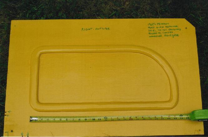

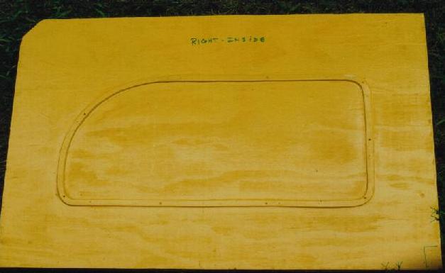

OH OH Bill I just read your first post, Sorry! But won't edit this below...YOUR patterns, VERY cool, NOW you MUST show and tell!!! As a woodworker I know how much effort went into making that pattern perfect. But a big plus may have been (when I disassembled the lights, discovered that all frames in and out, except for a few details that could be taken care of at the foundry?) were ONE pattern.

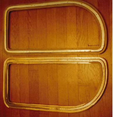

I'm guessing these frames are not actually paired UNTIL they get machined as a pair?

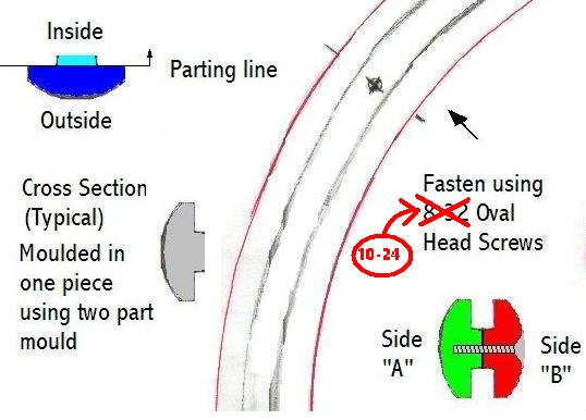

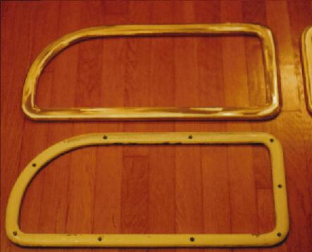

Are you doing the blind tapping also? My frames are very flat in profile leaving no room for a mistake in drilling. And if I remember, no more than a couple threads in the hole. Pearson depended on the squeezability of the cabin liner to draw the frames together. (Your drawing shows a much thicker frame than 338's aluminum ones.
Went to the trouble of restoring and powder coating the aluminums redrilled for thru bolts with heads countersunk on the exterior. Much stronger but not ocean proof nor as classy as bronze with hidden fasteners that Winiarski has talked so long about befor offering these frames - just wanted to know what he had there.
What did he quote for ready to install? Polished, predrilled and countersunk inners? As the Admiral once pointed out in this forum - once they are paired you have two separate sets of the 4 paired frames. Lotta work.

[The bronze frames I've lusted after that I've seen on The Admiral's boat and West Coast Tritons SEEM to be close in profile to the aluminum I became so familiar with. Bristol Bronze would had to have new full sized patterns made for the new bronze unless they have finally found original patterns to cast from. They would have to stay with original stuff since you cannot cast using existing frames as the result would be smaller overall frames. 338 has barely 1/4" lap all around on the existing cutout - a smaller frame could not be used!
I'm sure bill@ariel231 checked this out with Roger. It will be my first question if I decide to go for the gold er bronze.] And what do these retro frames weigh, is it an issue?
Bill231 You Gotta Give Us a Pic ASAP! ....and an OA length/width measure?

By the by, your work has now passed into a sort of patternmaker's D.Jone's Locker, a nail on the wall in his office - as Roger does not return patterns!!!
