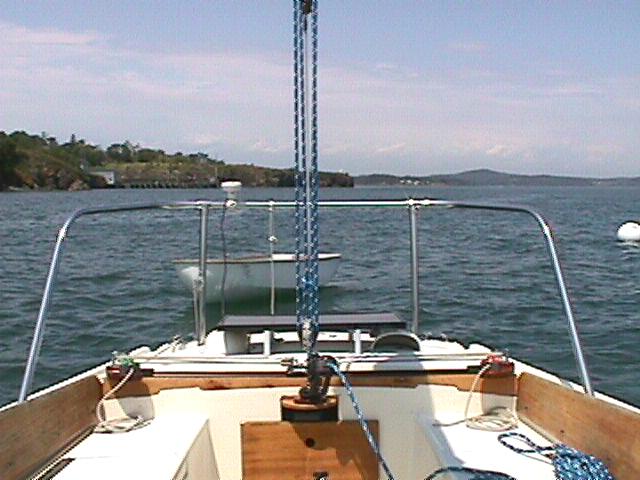

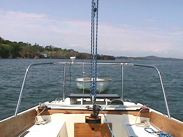

To satisfy the curious as to who's got what .... here's a pic of my ....whatever brand it is.... tender. I have no idea re manufacturer but it is 9 or 9 1/2 ft. and quite stable. Rows pretty well and has seat floation fore and aft. Picked it up in Stonington, Me, from a lobsterman who was gettin outa fishin!
This might be a bit betta
