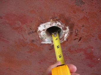

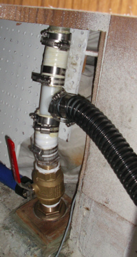

In 2010, I decided that it was time to try it again the right way. The capable and very professional people at Aquarius Marine in Santa Cruz removed my two Groco sea cocks and two inline ball valves along with all four thru hull fittings. The two seacocks along with three additional sea cocks were installed IAW American Yachting and Boating Association (AYBA) standards. Pre-drilled resin saturated plywood blocks were glassed onto the interior of the hull, and covered with additional layers of glass, and finally a layer of gelcoat. The seacocks were mounted to the resulting raised pads with bronze screws. I decided to have a fifth thru hull installed for the sink to eliminate the "T" in the port cockpit drain. I reasoned that this would prevent an accidental flooding of the cabin due to a blockage in the cockpit drain below the “T”. I now keep the sink drain closed unless I intend to use the sink for something other than a storage bin for items that I can reach from the cockpit. Shown in the photos below are:
1. The port-side cockpit drain before mounting of the seacock
2. The completed raw water line for the head.
3. The completed port-side cockpit drain and separate sink drain
