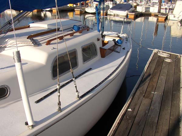

Theis - I see you have your genoa on top of the toe rail. mine is there also, but after a little exploration, i don't believe there is any reinforcement, backing plates or other on mine. What did you use. i hear horror stories (ok, maybe just one) about the track ripping out and though, "Boy that would suck, especially at that part of the deck. how do i prevent it?"
Maybe some of the others have thoughts. My preliminary thought is of the Hobie Cat 16 i still haven't sold yet. the two shrouds are attached throught the edge of the deck/hull joint. and it uses a solid rod about 2" long, with a hole drilled perpendicular-ly and the chainplate/thing threads into that. it spreads the load along the inside of the "lip" of the deck/hull joint.
Anybody know if that is a practice out there? or where to get such a thing?
thanx - km#3
attached pic:
oops, sorry Theis, meant Mike Goodwin
sorry Theis, i saw the picture Mike posted, read the first line and got everybody mixed up.
so my original question goes to Mike Goodwin, how did you add reinforcement to your toe-rail mounted tracks? posted above are the discussions Theis and I had when I had him mixed up with you. did you reinforce it in either of the ways we talked about (round rod with hole drilled, upside-down aluminum U-channel, etc)?
Also, would you do it that way again?
Thanks so much,
-km#3

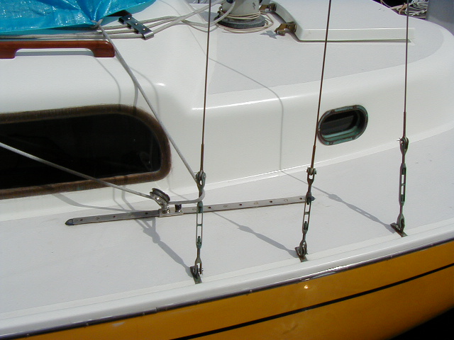

Toe rail mounted jib tracks comming up.....
Mike,
Here are mine, I settled on 8' of 1" track. How long are yours?
Any tips on the install?
I plan to start forward where the bend is more severe, so I won't have to finish bending the ends with short pieces of track (and little leverage).

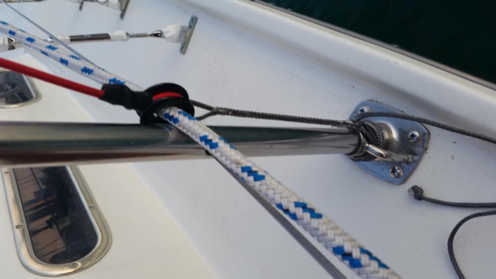

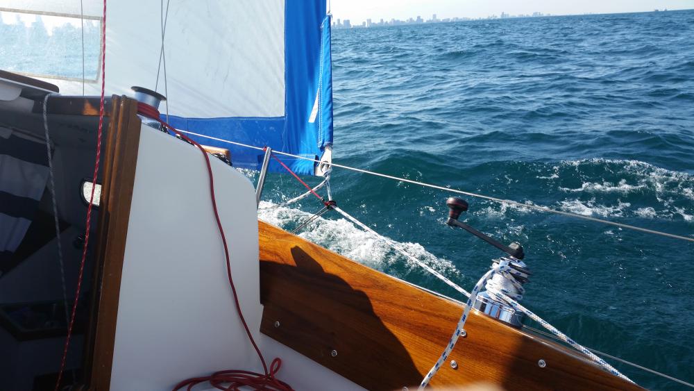

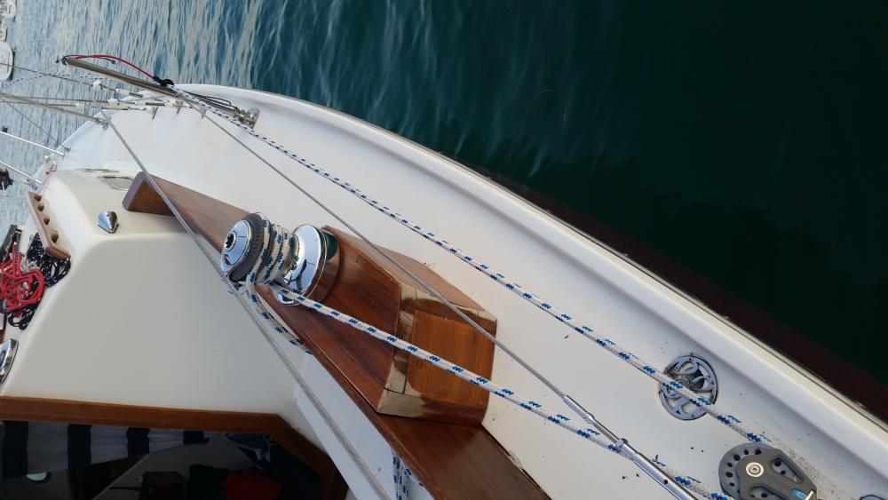

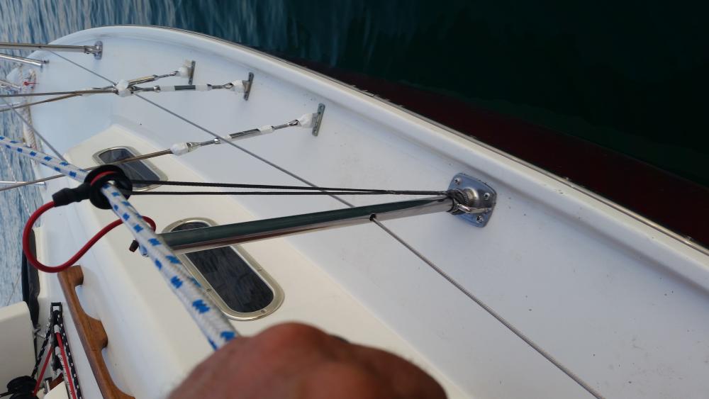

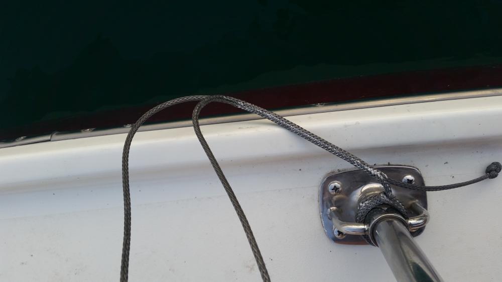

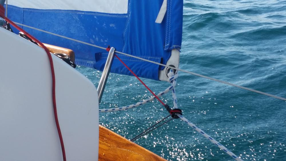

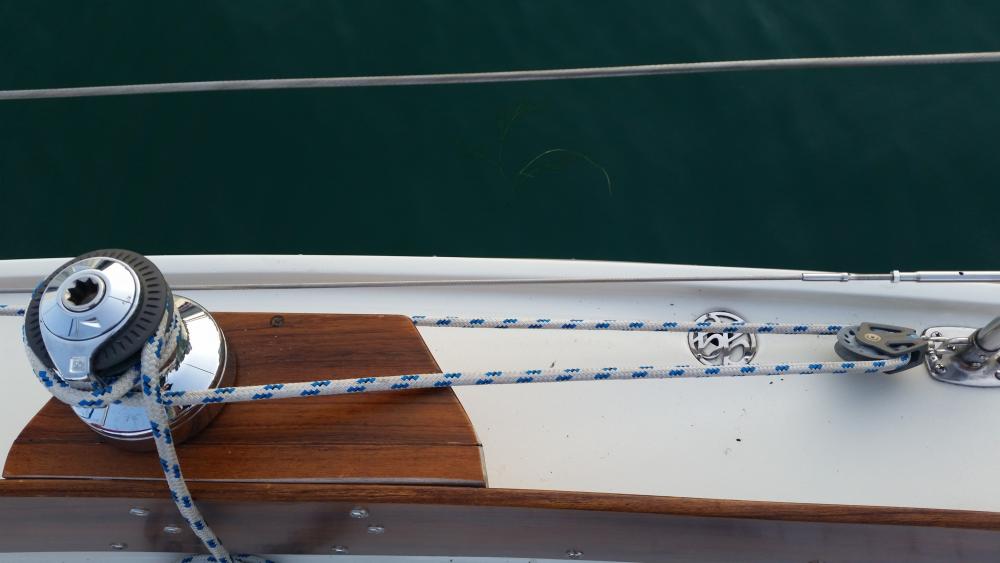

I just installed a floating jib lead set up and it is working really well. I looked at all of the posts on track placement They were very useful - mostly in convincing me that I didn't want to go through all the effort to install a toe rail t track and inboard tracks. After recoring the entire deck I wanted to come up with a solution that required drilling as few holes in the boat as possible. I've used a similar set up on a Santa Cruz 52 and a class 40 and figured that it might work on the Gail Grace too. I'm flying a 155% headsail on the furler. The first time I pulled it out I realized that the locking foot block I installed on the deck near the back of the cockpit was not going to work. I had to turn it somewhere further forward so I put a snatch block on a stanchion base and the lead was almost perfect but I had no adjustment. I have since replaced the snatch blocks with a couple of Lewmar 80mm blocks that work nicely. Below are pictures of the floating lead as installed. It consists of a short length of Dyneema spliced around a friction ring, The tail of the line is spliced with a loop and an adjustable splice. On the top of the friction ring there is a piece of bungee attached to the upper lifeline to keep it from banging around when it is not under load. I can flip it inside the lifeline and use an inhauler to the cabin top winch to trim smaller jibs inboard.
Attachment 9907
Jib sheet lead thru adjustable lead, back to turning block and to winch
Attachment 9908
Turning block to winch
Attachment 9911
Adjustable lead set at low position
Attachment 9910
Adjustable lead set to high position (around 13" of difference)
Attachment 9909
Adjustable splice
