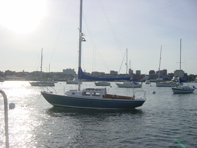

I would be very interested to know how you like your A/C to sit. The Princess naturally wanted to squat aft and I felt her performance sailing to weather suffered as a result. I added ballast to her nose until I thought she "felt right". (Pretty scientific approach, eh?) To really do it right one should speed check against a similar boat, sail just aft and to windward of the other boat at different points of sail and note the speed difference, then shift some weight around and try it again.
I found what I think to be The Princess's proper lines by compromising between; 1, drawings in the manual and pictures in the gallery.
2, watching water run to the midship scuppers from fore and aft.
3, the trim I "felt" was right after sailing the boat and shifting sand bags.
Here is how she sits in her slip with no one aboard;
37" from water surface to flat surface of the stem fitting.
27" from water surface to top of toe rail at the aft lower chainplate.
26" from water surface to top of toe rail at aft corner.
The Princess is rigged as a day sailor and carries no tanks, provisions, fuel, etc. so I'm sure she floats higher than most Ariels, but the proportion between the fore and aft measurement should still indicate the attitude .
If you get a chance, take a fore and aft measurement and post it along with some defense of your position.
