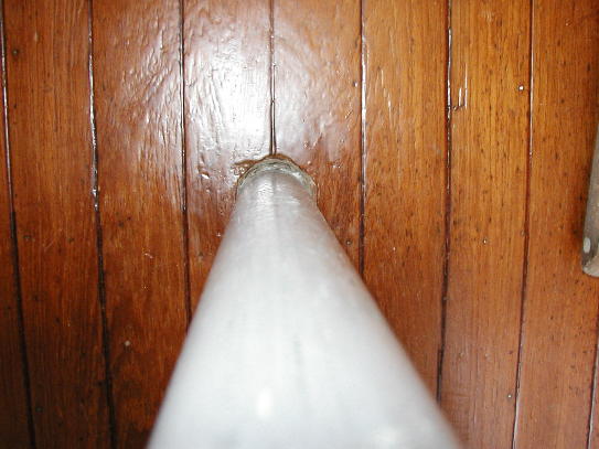

Does any one know exactly how the bottom of the compression
post is held in place? Do you have to remove the sole to inspect
it? It appears to be glassed in and sitting on the lead but its
hard to get an idea peeking through the bilge hatches.
I have cut out the core above the post to reveal rot and some
dampness. The top of the post is free and it can move around
somewhat. As I am soon to bed in a 1/4", tapering to 1", 8"
diameter , solid glass pad above the post I wonder what might be
done to the bottom while at this junture. Any Commander owners
that have had their compression posts out or any thoughts as to
what might lurk at the posts bottom would be greatly appreciated.
Cheers, B.

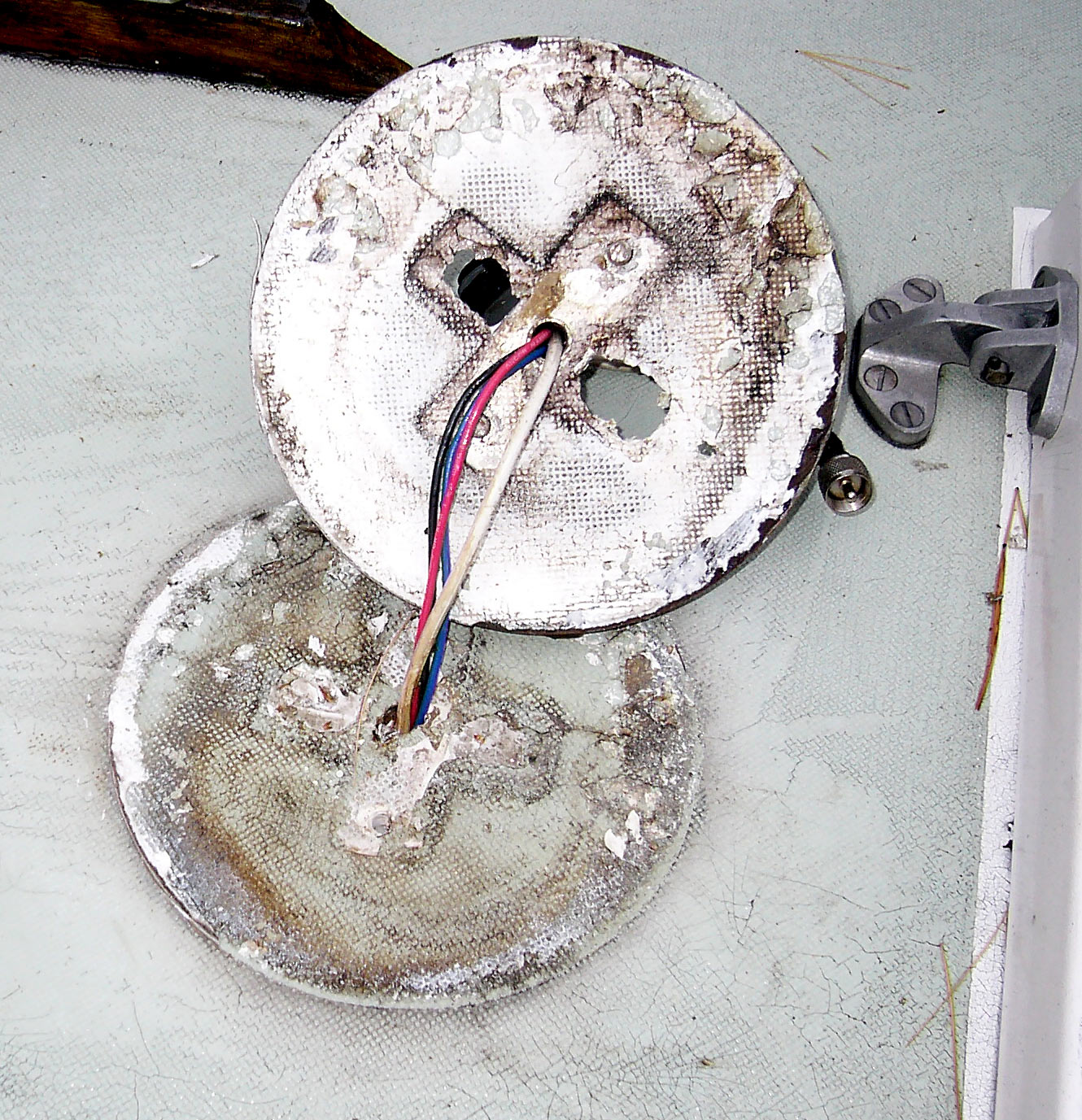

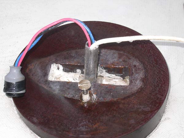

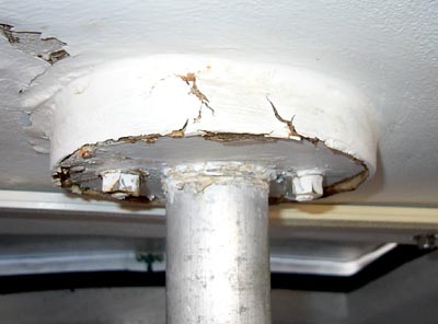

Commander Compression Post cap/top
The top/cap of my compression post show signs of needing replacement. It is pie shaped and is slightly wider at the top. There is a metal washer about the same diameter as the bottom of the cap that appears to be through bolted to the mast mount on top of the deck. I am guessing that that washer spreads the compression load over the cap and supports the mast mount on the cabin top. The only through points are the small pipe lead the cabin top and the mast mount bolts.
There are several open cracks on the edge of the cap and the washer appears to have crushed into the bottom of the cap. I believe that the situation has gotten slightly worse over the past year.
Has anyone removed and rebuilt this cap? Has anyone made a mold to fabricate it? Is it possible to have this turned from wood and then glassed?
Suggestions anyone?

I will take my digital camera out to the boat this weekend, and try to take some pictures. I was thinking I might also probe one of the cracks with an ice pick to see what is underneath.
Thank you for the information on the pad. If that is all it is, then I can, at the worst, cut the tabing, drop the pad and cut a new pad out of regular ply and glue it up with some epoxy. And then tab it back into place.

I have removed two compression posts from Commanders
Hello all,
I have experience removing and working the area of the compression posts on Commanders, don't know if there are any outstanding questions that I can help shed some light on. Here's a couple of points though:
1) The compression post is schedule 80 anodized aluminum.
2) The sole was installed first, then the post lowered down through the forward hatch and inserted into the cabin sole hole at a slight angle.
3) The lower end of the post sits on a built up fiberglass base in the bildge. Most likely with wood somewhere inside. The post itself is not glassed in.
4) The wooden wedge between the top of the post and the underside of the cabin is made of teak. The wedge is necessary for the same reasons the mast base has a slope to it.
5) Pearson cored the entire cabin roof, to include (unfortunately) the area immediatedly under the mast step.
6) The core is 3/8 inch end grain balsa.
7) Any detected movement is a sure sign that the balsa's integrity has been compromised. ie, water intrusion followed by rot / decay.
8) No work should be attempted with the spar (mast) up.
9) To remove the compression post strip away the very light tabbing around top of the post and with a block of wood drive the top of the post directly forward. Remember, the post was installed through the cabin sole hole at an angle and will come out at an angle. The biggest challenge will of course be in overcoming any downward movement the cabin roof made due the core failure.
I'll leave it at that for now, unless there are more questions of repair, etc..
Thanks,
Chance.
