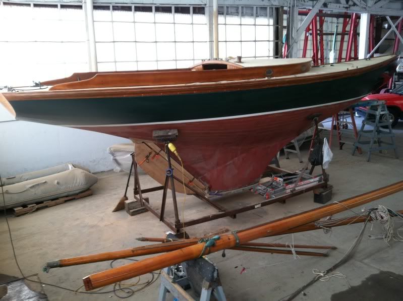

Spent the day yesterday working on the S-Boat Iroquois' rudder, old story. Random orbit in one hand, yard stick in the other, more to do. She should be in the water by next weekend. The owner Rick did a really nice job finishing the topsides and brightwork. Hopefully with the new rudder she'll be as fast as she looks.

Beautiful work, beautiful boat.
Nice, simple jack rig.
How do you get it moved out of the shop?
Thanks for the work in progress shots,
it's really been a treat!:cool:
I second that... nice work and thanks for posting the progress photos Ben.
Thanks you guys, really appreciate your comments.

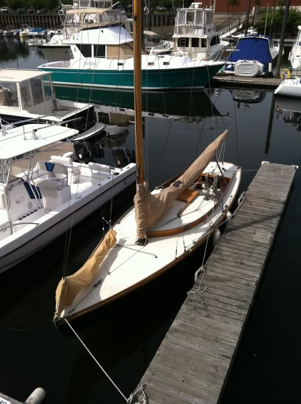

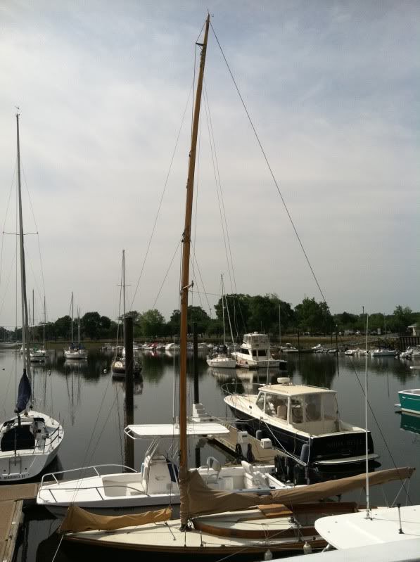

Here are some pictures of Allegro I took last Saturday after Bill, Allegro's co owner ghosted her under sail into Mamaroneck's harbor to get her bottom painted at the boatyard.

I was talking to a new sailor on another forum recently and explaining to him the proper procedure to tune his rig. When he was done he had a bout 3" of prebend in his mast. Which for the boat he sails is just about perfect. Butt he was all concerned that none of the boats around his had as much prebend as his and thought maybe it was too much. I need to send him your photo of this S-boat wooden mast with it's prebend so set him a little more at ease.
The s-boat sure is a good looking boat.
Jerry one of the interesting things about these beautiful curved S-Boat masts is that they were built mostly in the past twenty years. Many S-Boats had lost their original masts by the sixties and seventies and were racing with conventional aluminum masts. A man named Frank McCaffrey resurrected the art of making the wooden curved S-Boat mast sometime in the 1980's I believe. Hard to imagine an S-Boat racing without a curved mast today.

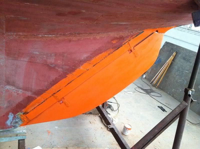

Almost finished. Rick and I riveted the pintles and gudgeons onto the hull and rudder with copper rods today, fun to do. Still need to make and attached a wood cover which hides the bronze rudder stock, early next week. Primed everything with red lead, the yard needs to fair up the lead keel that was damaged last fall and do the bottom painting.
