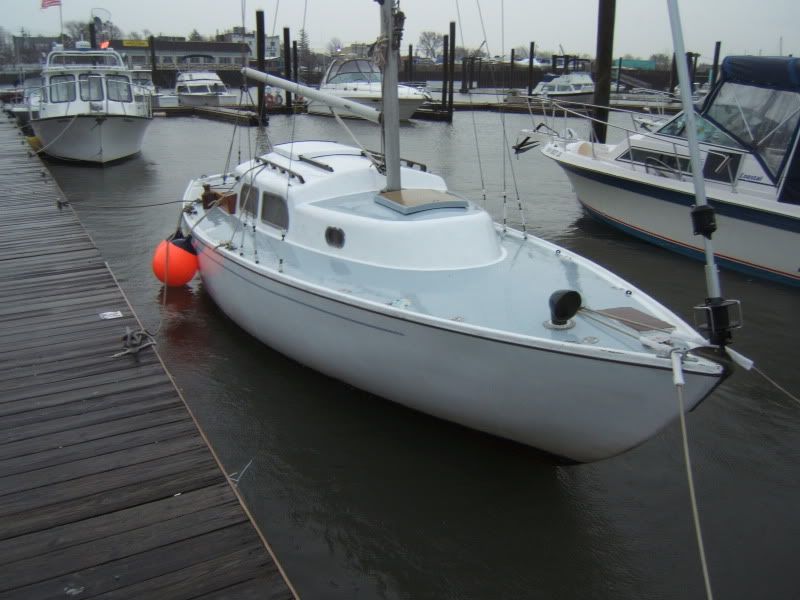

I think my "new" dingy was an old fishing rental skiff. It's got to have been built, my guess, in the 40's or 50's. The skiff's flat bottom makes it easy getting into the Ariel while out on the mooring. Brockway skiffs were built nearby in Connecticut for many years. I'm not sure if this is a Brockway.
Here we are back at the dock for the winter.

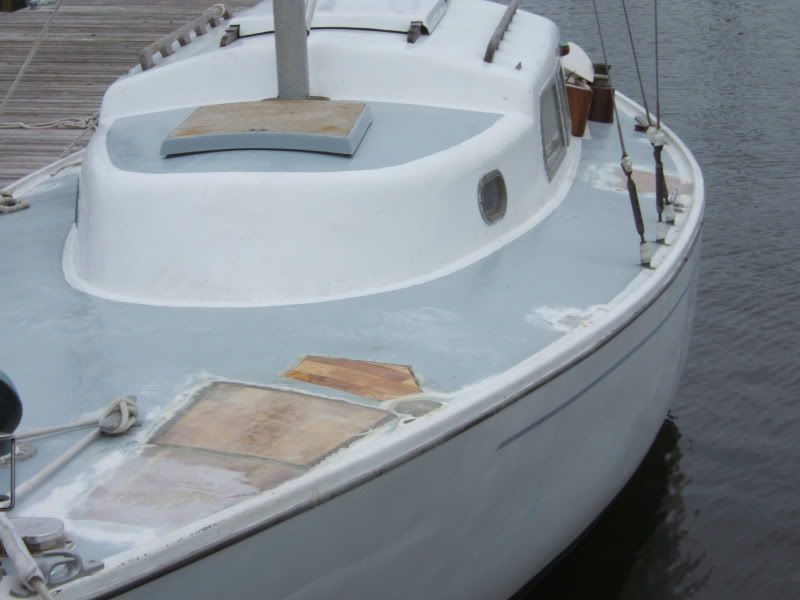

I started working on the deck issues over the past summer, mostly on the un-cored areas around the lazarette. But now I need to get tackling on the cored areas damaged by the dearly departed lifeline stanchions and bow pulpit. The "crude" marine plywood patches I chaulked down on the deck worked well, keeping the boat dry below. So now off we go with the balsa core, fiberglass and low temperature setting epoxy.......

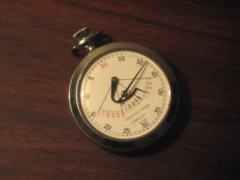

Getting ready for this upcoming season's Wednesday night races with the Ariel. I found this vintage (1960's) yacht timer at this little antique store on City Island run by a 91 year old gentleman named Cappy. The Swiss maker Gallet made some nice timepieces. This one is nothing fancy but feels good in the hand, runs nice and very reasonable in price.

The warmer temperatures of the past few days allowed me to epoxy the two gaping holes in my deck that I covered up last season with plywood and marine caulk. Noesis' deck is going to look pretty spiffy very soon.

A blast of cold temperature weather, 30° high, hit City Island today. I decided to take the risk and deploy the warmed at room temperature West 105 / 205 epoxy and glass cloth to complete the outer shell of the bow deck repair, devil may care. In the aid of my endeavor a 250w heat lamp bulb was purchased and clamped to the forestay which in conjunction with a day of bright sunshine set up and harden the epoxy mix.

Spoke too soon about being finished cutting into the Ariel's deck. I opened up two areas that felt soft behind my "gaping" hole bow repair. The balsa core in each of these areas was intact and in fresh condition but had delaminated from the deck skin. Oh well, it doesn't seem a very big deal anymore to cut into the deck and do these type of repairs. Hope to finished with the epoxy tomorrow and move on to fairing, sanding and painting in the coming weeks.
