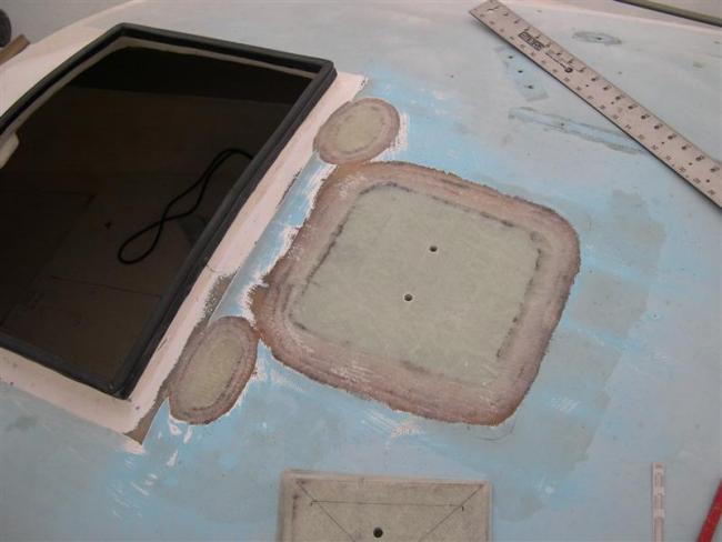

The next picture is some future planning work I'm doing. Initially I plan to have my halyards terminated at the mast and I will mount a couple of winch pads on the mast for the halyard winches. But as I get older I may decide I want to run them back to the cockpit. So the second picture is of areas that I am making solid glass pads for rope clutches and winch bases.

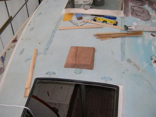

I started out by making a wood plug the size and shape of the step I wanted to end up with.
Attachment 6750

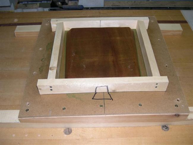

Then I had to build a piece that recreated the curvature of the deck that I could set on my workbench so I could attach the plug to it and build a framework around it that would hold the casting resin I was using to make a mold for the fiberglass step.

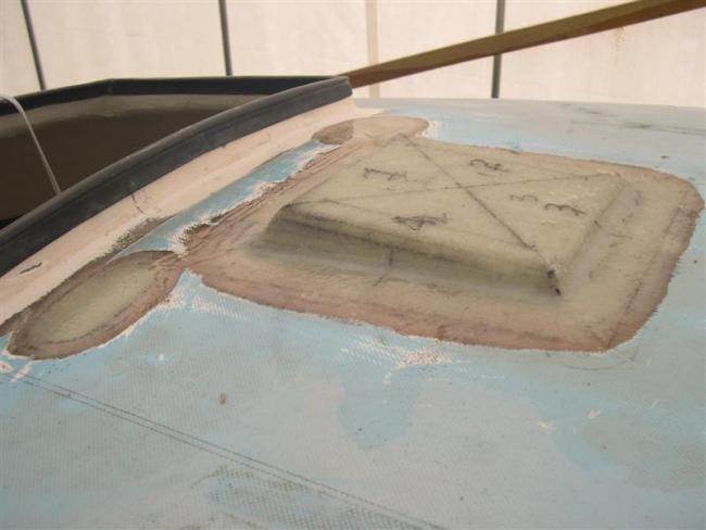

After that I poured in the casting resin, let it set up and I had a female mold that would allow me to make a solid fiberglass mast step. Then I popped out the wood plug and started cutting pieces of fiberglass that would allow me to fill the mold with solid glass. I must have cut between 30 and 40 pieces to get enough to fill the mold. I painted the mold with release wax and started laying up my mast step. After all the glass was wet out I covered the assembly with visquene and then clamped the piece that matched the curvature of the deck to the top of it. After the epoxy cured I dissasembled everything and took out the fiberglass mast step. I used a special solvent that removed any traces of the release wax and then sanded everything smooth.
While I was waiting for the epoxy to cure on the mast step I recored the deck where the new mast step would go with solid glass. And as long as I was at it I made the areas where the forward hatch hinges go through the deck solid glass also.
Attachment 6752
Then when all the parts were ready I mixed up some thickened epoxy and spread an even layer on the bottom of the new step and pushed it down on the deck. I used the squeeze out to make a fillet around the step. Once that had set up I glassed the entire thing down to the deck. This picture shows it at that stage. The only thing still needing to be done is to sand it then fair it out with some epoxy thickened with cabosil and mircoballons.
Attachment 6753

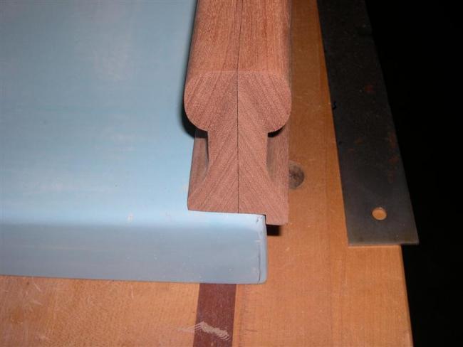

The little piece of wood trim that came on "Destiny's main companionway hatch did not allow for an easy way to grasp the hatch and slide it back and forth. So I decided to make somethiing for it that was more accomodating to my fat fingers.

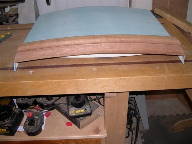

This was not a real easy task as I found out when trying to make the new hand hold. The curvature of the hatch is not a smooth radius so I found I had to first cut and shape the bottom of the new piece to match the shape of the hatch. Then 2-1/4" above that point I had to draw and cut a true radius that would allow me to use the top as an indexing point for the 4 router bits it would take me to make the profile I wanted to make.
This first picture is the profile of the new hand hold.
Attachment 6754
This second picture is the view showing how it looks on the hatch.
