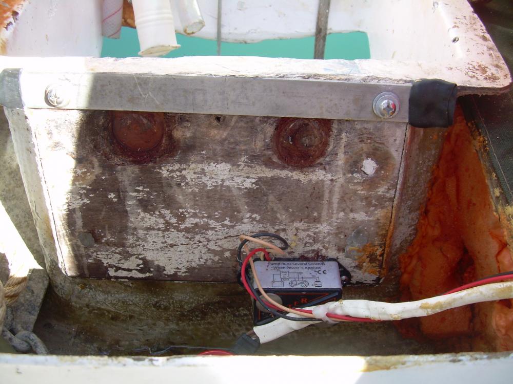

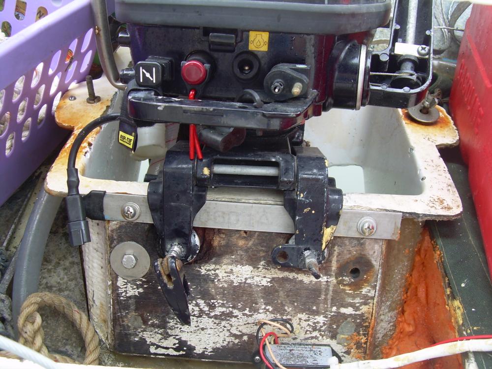

I solved this problem by installing a stainless steel bar across the top of the engine port mount. Carefully measured to allow the round clamp pads just enough clearance to pass under the bar when the engine is installed, the bar retains the engine while allowing only very slight movement, and I can install the engine and remove it (which I do after each sail) without torquing the mounts excessively. When the clamps inevitably loosen after a long sail, I only have to reach in and give the clamps another twist. The engine stays put.
Attachment 9380Attachment 9381

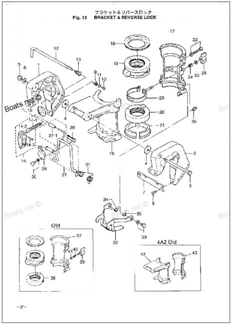

2) The Nissan has a “feature” that allows the lower shaft to tilt back when the engine is in forward gear. Referring to the attached drawing, the reverse lock arm (32) engages the thrust rod (12), but only in reverse and neutral gears.
Attachment 9383
In forward gear, the engine is allowed to tilt back freely. This is a useful feature on a skiff that prevents prop damage when the skiff is run up on a beach, referred to in marketing material as a "Shallow Water Drive." But the free-tilting behavior is completely useless on a vessel where the prop is higher than the keel and will never strike the ground (you’d have to back into something to strike the prop). Plus, the tilt range in the Ariel is too limited to be of any value – only a few degrees before the engine cowl slams into the forward wall of the engine compartment (damaging the cowl).

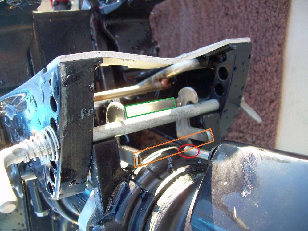

The kind folks at Svedsen’s solved this problem for me. Referring to the attached photo, they removed the semi-circular swashplate (area marked in orange) so the push rod end (circled in red) cannot engage the reverse lock arm to move it out of the locked position. They then welded a cross piece (marked in green) to the top of the reverse lock arm. Alex in the chandlery came up with this solution. The engine now remains locked in the vertical position in all gears. The modification can be reversed by installing an original reverse lock arm.
Attachment 9382

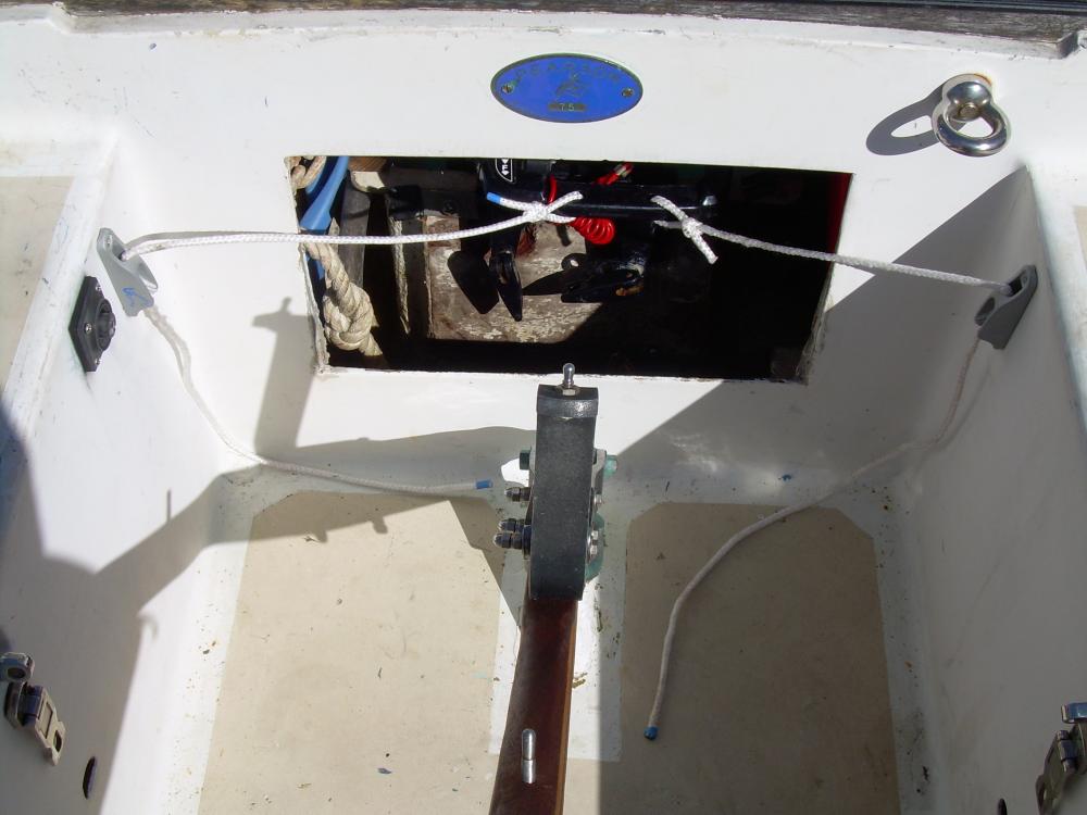

Here's photo of how I solved the problem.
Attachment 10280
