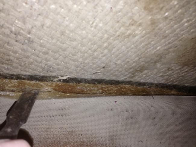

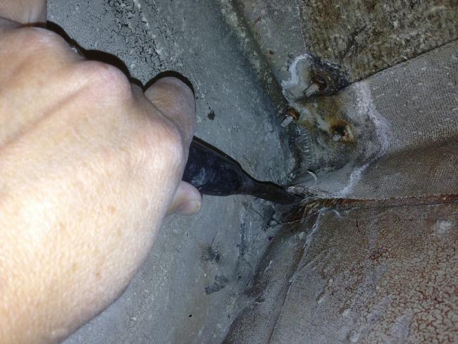

However, Pearson's hull-deck join - evidently after thousands of these boats alone - never was engineered or upgraded correctly during these three different model runs. It's a Pearson thing.
While all of them were sold as bluewater capable boats, it's obvious now when these old glass boats are involved in accidents that test the mettle of Pearson construction methods
that this most important connection, hull to deck, of these boats is seriously FLAWED.
And just as seriously not usually recognized by restorers, renovaters, and owner-voyagers.
Maybe the age of these boats has something to do with the serious destruction of the fiberglass seam in these recorded accidents.
Maybe it's new. Or maybe it's showing up more as we ask more of these boats. Imco age has something to do with it.
Maybe these starved seams - with fiberglass strands turned at crushing angles - are getting tired?
If there is TWISTING of the boat as it's being sailed or
stored improperly braced on the hard....perhaps both passive and active stress can weaken these minimalistic hull-deck seams?

Rex talks about the Pearson monoque fiberglass design as seriously flawed at the hull-deck seam. Put that way, it shows how weak and meager
the seams are on these three class models.
Better in all cases would have been a simple lap joint, 'shoe box' joint, one over the other. Glued & bolted. No ifs, angles, or butts at all.
The laminate schedule on A338 left a thickness of 1/8" toe-rail BUTTED to a 1/8" hull. Seam covered with casual thicknesses of matt ! ! !
