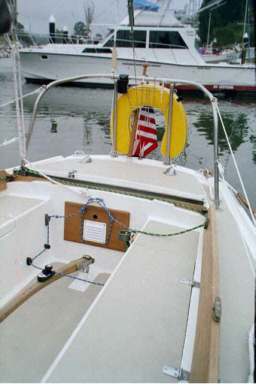

I modified the vertical hatch board behind my tiller to increase ventilation in the lazarette locker both at the dock and underway. A photo is attached. Incidentally, the tiller tamer fairleads and cleats were installed on the boat when I bought it, but the old tiller tamer was long gone. I bought and installed a new one shown in the photo. I discovered that although the device was functional, it was fragile in the configuration shown due to the extreme angle of the lines running from the device to the first fairlead. I could not see an easy way of changing this without drilling a bunch of new holes. I now use a knotted bungee cord run between the two cockpit-side mooring cleats and wrapped around the tiller, and that works just fine. I have a pile of stuff in a sack that someday I intend to use to make my own more durable device for securing the tiller.
