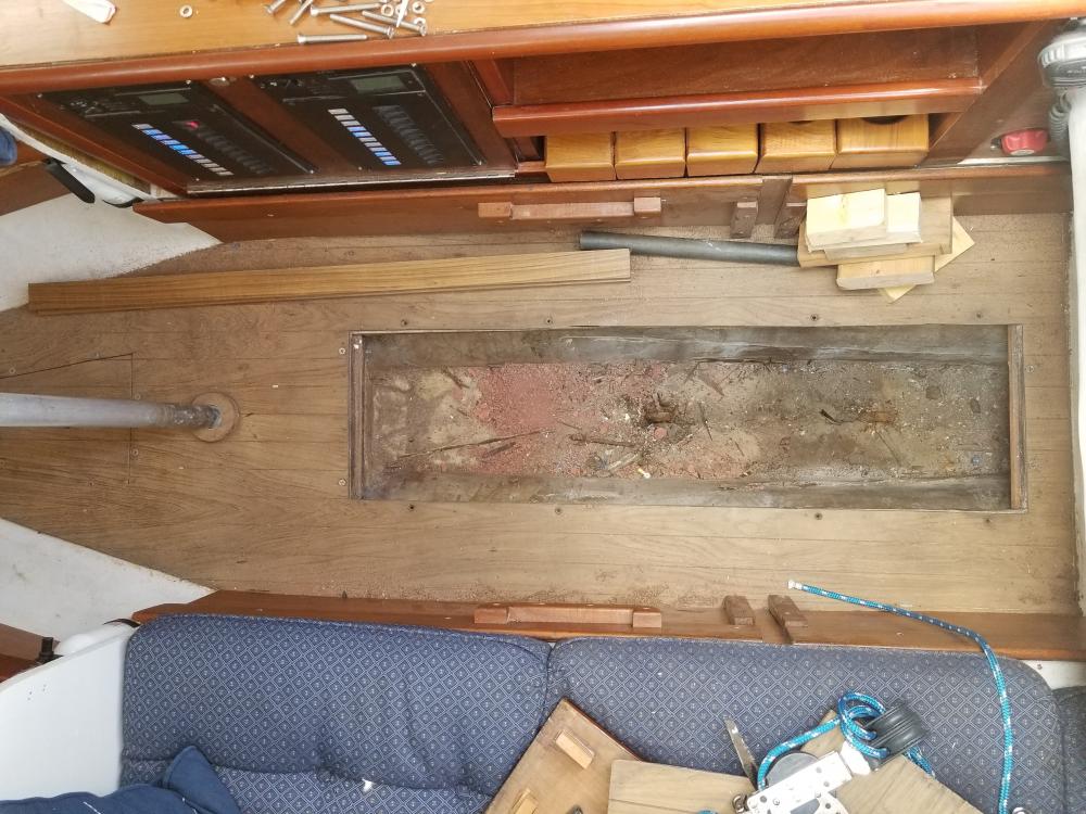

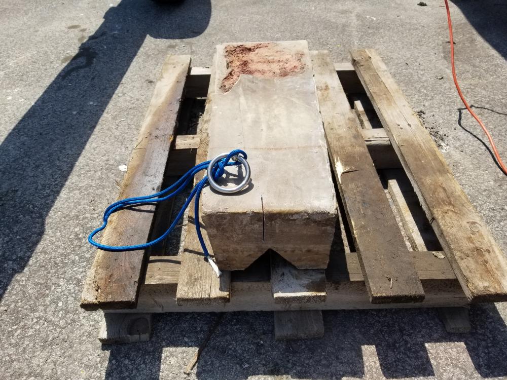

I removed the corrector weight today. Not too difficult although I was worried the lag eye I installed to lift it would pull out. As soon as I got the piece upright I tied a couple of safety lines around it and pulled it out of the boat. We'll see how the boat behaves without the additional ballast. I opened up the floorboard to make the removal easier.
Attachment 10103
Attachment 10104
