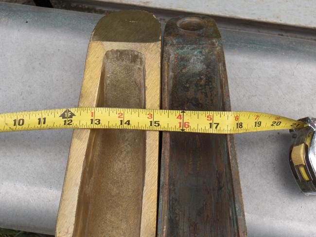

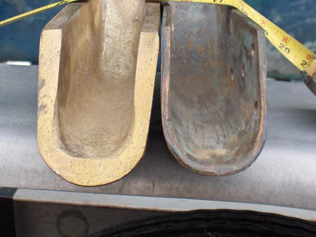

The casting is nothing like the humongous casting shown in the side by side photos above.
It is slightly larger in overall width, but imco can be easily faired into the hull. As it was on A-338.

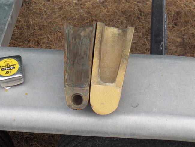

The oversize cast rudder shoe in the above photos looks rather crude -
and imco the material looks more like brass than bronze.
I think it is better to have a new shoe cast in a known material.
My absolute choice is silicone bronze 655.
Everdur 655 bronze comes in plate form and can easily be welded.
It may be possible to have a pretty good rudder shoe fabricated from this bronze in a metal shop.

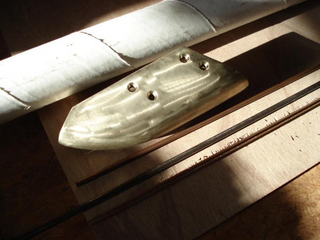

Silicon bronze rudder shoe
Just want to let those who may be interested:
New silicon bronze (Herculoy) rudder shoe
Cost: $325.00 (includes machine work)
This is fast moving. Foundry will have the pattern first part of this coming week, and is scheduled for casting.
If you desire to purchase one, your intentions and commitment to purchase is needed this weekend.
