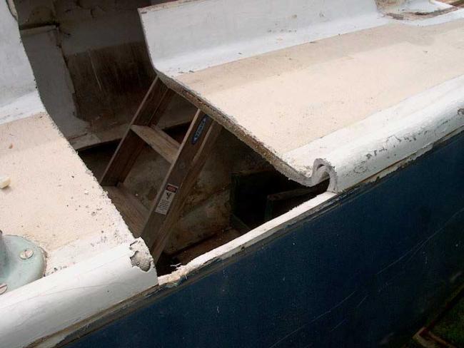

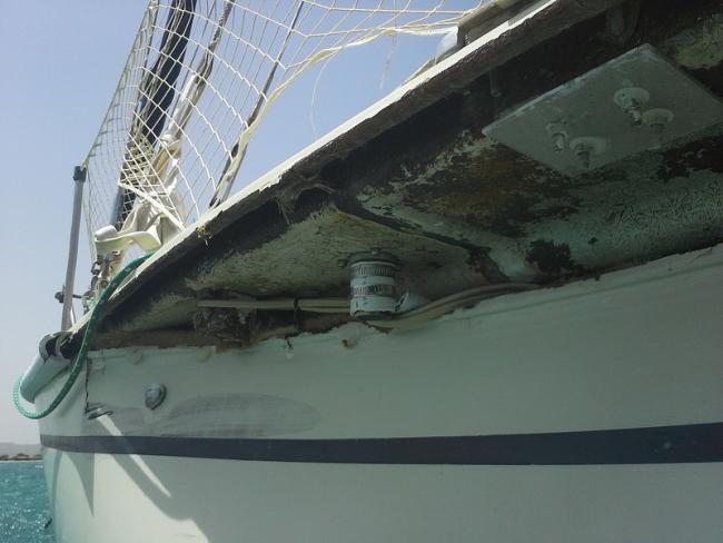

The short version is that Vento Dea was lost due to hull deck separation sustained as a result of a freak wave slaming it down on its port side which openned up a 4 foot long and 1 foot wide gaping hole. The pictures that the owner posted on his blog (which are reproduced here) clearly show that the hull deck tabbings are grossly inadequate. You can see that the separation is really a clean break between the hull and the deck as if there were no tabbings there at all. You can see that what the fiberglass mat tabbings there were are no match for the violent force of the wave.
Attachment 9068
Attachment 9069
I don't know exactly how many Ariels/Tritons have made accross the Atlantic or the Pacific but let's assume that number is 20 give or take a couple and the average distance travelled in those 20 blue water voyages is 5,000 KM (approximately a round trip accross the Atlantic or from the west coast to Hawaii) that puts the total distance under sail at 100,000 KM. My concern (which is not the same as conclusion) is that the reason we have not lost that many Ariel/Triton's is not because of the construction quality BUT because Ariel/Triton's just have not crossed that many ocean miles. To put in relative terms 100,000 KM is less than what the Pardeys or Hal Roth travelled by themselves. In addition, almost half of the 100,000 KM is attributable to James Baldwin's two solo circumnavigations which were completed in a very customized Triton. Sure, I don't think Pearson/Alberg designed and built Ariel/Triton's for the blue water. They are probably designed and built for club racing or coastal cruising. That being the case I think it is imperative that we don't over look issues like hull deck joint when preparing an Ariel or a Triton for the blue water.

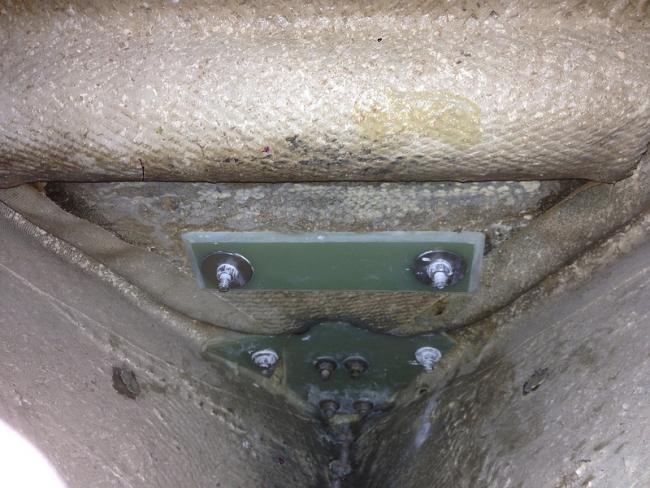

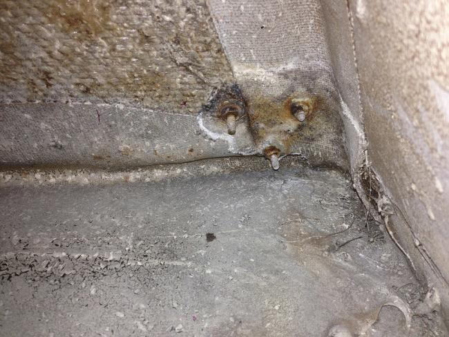

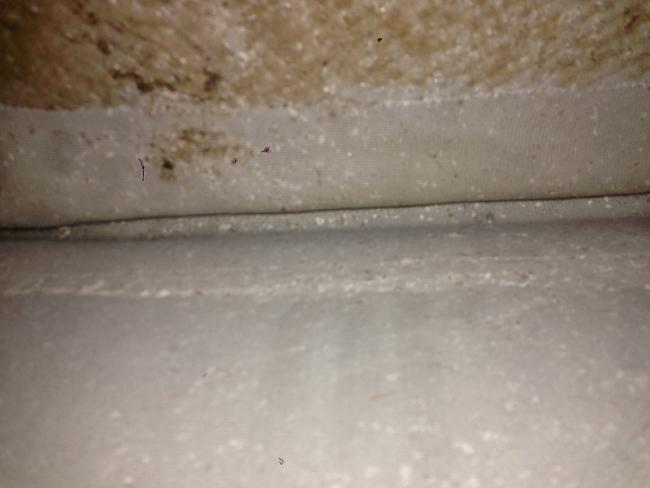

I looked at my own Triton hull deck joint at several locations (in the V berth and in the cockpit lazarette) and can see that the tabbings are very suspect although I have not openned them up for a closer inspection. After seeing what happened to Vento Dea I definitely want to open it for a closer inspection and potentially redo the hull deck joint using the ideas proposed here by Ebb, C'Pete and others. I am not looking forward to this dreary job but there is no choice in this matter for me.
Guess more than a few tons of wave caved in that hull.
The Triton has a flange join that many other frp production boats copied.
Maybe it could have been more substantial.
But extraordinary force did cause it to 'zipper'.

*If going with the redundant clamping idea:
you'll need access to the machine screws inside for nuts and wrench. Won't be able to create a mechanical clamp in many places.
These fastenings will never be removed (or if they are, it'll be part of a major overhaul or resoration.)
So, imco, it's ok to epoxy them in, cover them up. Where no access exists, instead of sheetmetal screws, I'd try tapping holes (in cured epoxy) and driving in 316 machine screws dipped in liquid epoxy! They won't leave a sharp point inside the toerail for a finger to find someday.
And pre-threaded holes make a cleaner maybe stronger connection.

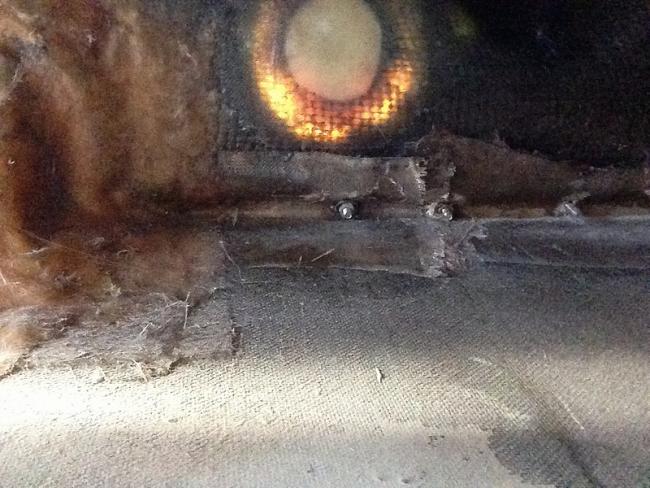

I read the above referenced blog. That was a bone chilling story. It would be interesting to know whether the damaged boat was an East Coast or West Coast built Triton. The West Coast Tritons I have seen seem to be built somewhat differently than the East Coast Tritons. To my knowledge, all Ariels were built on the East Coast.

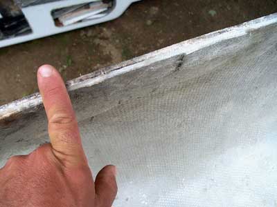

The hull to deck seam on West Coast Tritons have approx 3/4" protruding lips - top lip the deck - bottom lip the hull.
I don't know Tritons, and didn't notice. But have search some and found that these lips sometimes were or were not
thru bolted at the factory. Tritons have a history of problems with the joint. On both Coasts.

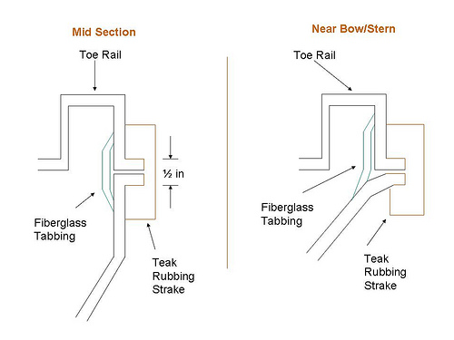

Here is Ray Alsup's (National Triton Assoc) essay on his renovation: (maybe somebody can make the direct blueline connection for us?)
google: Alberg Sailboats - Rubrails
albergsailboats.org/about-the-triton/...triton.../hull.../667-rubrails.html

Another way to view the damage, is to imagine that the boat didn't only get caved in,
but the that the whole boat for a few seconds was TWISTED by the comber........ and that popped the seams.
Ebb, I am adding the link to Ray Alsup's write-up on how he strengthened his west coast Triton hull deck join here - http://albergsailboats.org/about-the...wcrubrail.html. Ray did an admirable job and it certainly sounds strong enough BUT I am not sure if it would be strong enough if slamed by the same freak wave. The reason I harbour my doubts is because the externally turned lips that are typical of west coast Tritons are very narrow. At best it is only 1/2" wide. You can imagine how much holding power there might be if you drill a bunch of 1/4" hole in the middle of this lip. That's why it is probably not the route I would take. Certainly I am not saying it is wrong to take that approach, just not as strong in my opinion as some of the other ideas proposed in this thread. If you really want to get into the theory behind strenghth of machine fastened vs. fiberglassed hull deck joints you can read David Pascoe's article "Screw It" here - http://www.yachtsurvey.com/Screwit.htm.
Scott, to answer your question Vento Dea is a west coast Triton just like Ray Alsup's and mine. I have a drawing of the hull deck joint here. For the reason I stated above (ie. the lip being too narrow) I did not end up using machenical fasteners. I also consulted Tim Lackey before making my decision. Tim also advised using internal tabbing approach to strengthen the joint. I fabricated and clamped "C" shaped mahogany rubbing strakes (I know the drawing says teak but I could not afford it) from stem to stern on the external lip with a ton of 5200 after sanding and cleaning the external joint. For a while, and as long as I only sail inside the SF Bay, it is probably strong enough. I don't imagine that a freak wave could come inside the SF Bay.

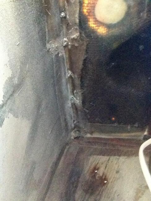

OK, so when you look at the photos,
the lips coming together wasn't where the separation occured.
In this case it tore apart at the angle where the deck flange turned. Easy to see that it was the
flange turn that zippered. Probably because the deck is not as strongly laminated as the hull.
So can we agree... the weakness in the join is not where the two flanges come together -
but where the two flanges are forced to make hard right turns.
One thing we know is that fibeglass doesn't like point loads and doesn't like sudden changes
in thickness. The glass fibers in the apex of thse tight turns might be broken.
If this is correct, then the sudden out turn of the deck and hull flanges are a weak construct.
The way the boat came apart is the clue.

Ebb wrote:
The pictures are not very clear so it is not easy to verify if the 90 degree turned lip is the weak spot. It certainly is possible. Assume that is the case, I still think that stronger internal tabbings could have saved the boat or at least minimize the extent of the damage. I looked up some of the east coast Triton hull deck joint internal tabbings they appear to be much more substantial. The following pictures come from Tim Lackey's Day Sailor Project website. I "borrowed" the pictures because they are the most clear and relevent that I can find (hope Tim does not shut me off from his websites:-)Quote:
"OK, so when you look at the photos, the lips coming together wasn't where the separation occured. In this case it tore apart at the angle where the deck flange turned. Easy to see that it was the flange turn that zippered. Probably because the deck is not as strongly laminated as the hull.
So can we agree... the weakness in the join is not where the two flanges come together - but where the two flanges are forced to make hard right turns. One thing we know is that fibeglass doesn't like point loads and doesn't like sudden changes in thickness. The glass fibers in the apex of thse tight turns might be broken. If this is correct, then the sudden out turn of the deck and hull flanges are a weak construct. The way the boat came apart is the clue."

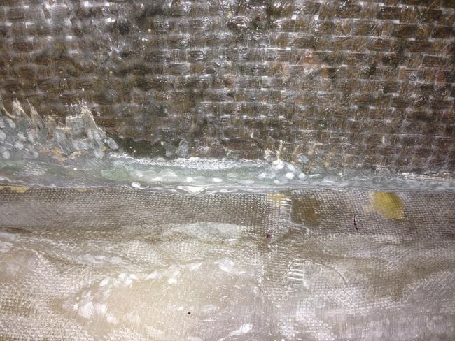

Tim wrote,Quote:

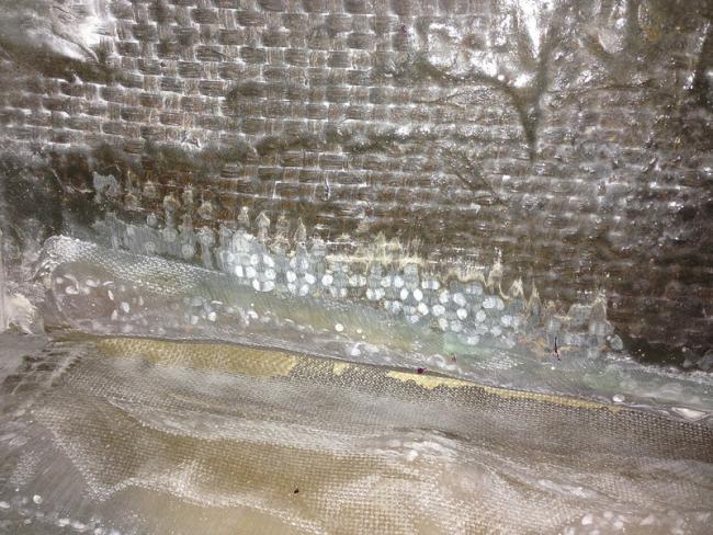

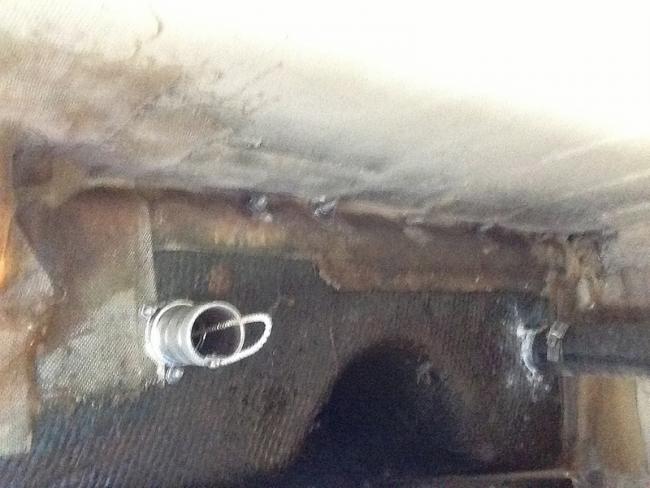

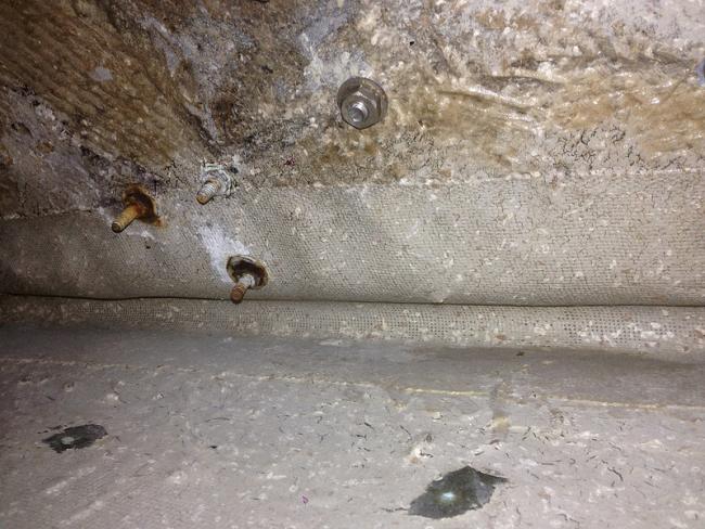

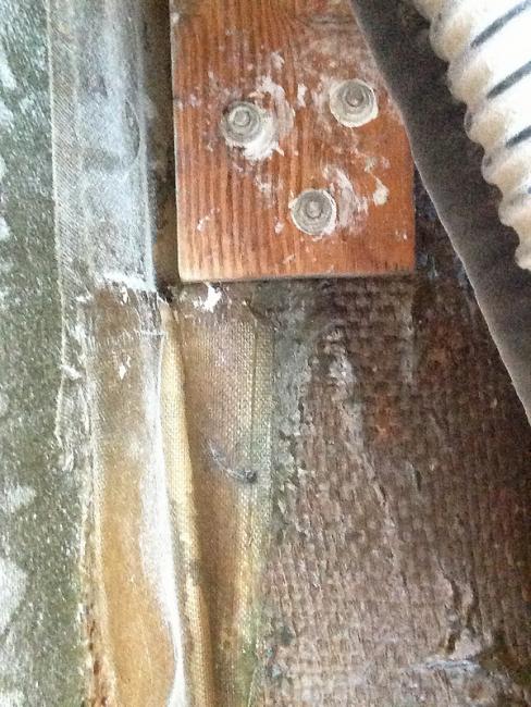

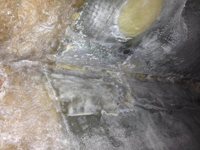

I discovered that the upper part of the hull was surprisingly thin. Discounting the thickness of the tabbing that had been used to secure the deck and hull together, the upper portion of the hull shell at the gunwale was only about 1/4" or so. The thickness in the bottom, where visible around old through hull installations, is about 3/4". These thicknesses are substantially less than what I have found on #381 Glissando--I found about 5/8" of glass near the gunwale on the port bow when I installed a holding tank vent fitting there, and anywhere from 3/4" to 1-1/4" of glass in portions of the bottom. In the photo, you can see the line between the tabbing and the hull shell, and my finger is there for reference.
Tim is lamenting the thickness of this particular Triton's hull here but we can infer that the tabbings must be close to 1/4" on this particular Triton since they appear to be about as thick as the hull. Although I have not openned up the joint tabbings on Blossom I am fairly certain they are not 1/4" and at several spots they are not even properly bonded to the hull. I will report back once I have had a chance to open it up.
As for the repair I am leaning toward stronger internal tabbing approach, combined with eggcrate idea that Ebb proposed. My main reasoning is that I really hate to take off the mahogany rubbing strakes I installed a few years ago to strengthen the joint from the outside. They look nice and they are functional. Any external tabbing would also be harder to fair and repaint as they would have to be near "perfect". I don't mind taking out the internal shelves and cabinets since I am not too thrilled with them anyway. Taking them out and reinstalling new and stronger shelves and dividers properly tabbed to the hull would make the entire hull deck joint region a lot stronger. Anyway you look at it it is going to be a big job.

It seems probable that the long rip at the seam of the Triton VentoDea was caused not only by the weight of the comber,
but by the whole boat getting twisted for a second or two. Twist a banana and it'll probably pop open at a skin seam.
Hey Ebb, twisting a banana could do it. In addition, it may have been picked up by the freak wave and body slammed on solid water (is it an oxymoron?) I read somewhere that is how Humphrey Barton's Vertue XXXV cabin house was partially torn open. When a boat is body slammed down the force from the impact seeks the weakest link to release the absorbed engergy. In Vertue XXXV's case it is the cabin trunk and deck joint because it is a wooden construction and is fasterned to the deck by mechanical means. In a fiberglass boat like Vento Dea the cabin trunk is molded as a part of the deck so its weak link is the hull deck joint.

I went to my boat today and took some pictures of the existing internal tabbings on Blossom. I focused on the anchor locker and cockpit lazerette areas since the access there are better than the areas behind the cabinets and shelves in the saloon. The first four pictures are from the anchor locker. Please ignore the rusty screws which I know I should have replaced long ago, but hey we are all human beings. I want to point out the obvious that what we can see in these pictures are the final layer of the tabbings. We don't know how many layers there are or how thick they are or how well they are bonded to the hull and deck. What you can see however is that the final tabbings in the second picture are not bonded to the deck properly, probably due to the deck stringer being in the way. The G10 backing plates and the machine screews and nuts are for the bowsprit I added recently to fly a code zero in light conditions.
Attachment 9073
Attachment 9074
Attachment 9075
Attachment 9077
The next four pictures are from the port and starboard cockpit lazerettes. Please pardon the fuzzy quality of the pictures as it was hard to steady the hands to take pictures upside down in the lazerette. As you can see the tabbings in these areas appear to be different than the ones in the anchor locker. For one thing they are not painted. My speculation is that they were added afterward by a PO who clearly needed a little more practice with fiberglass work. The workmanship is not something I wish to emulate. The bonding to the hull and deck are very poor. I will probably have to grind down this area all the way to the hull and deck which is not a bad thing as it will provide me with some clue as to how many layers of tabbings were used and how thick the total tabbings are in this area.
Attachment 9078
Attachment 9079
Attachment 9080
Attachment 9081
In the Ariel that has me, the predominant factory fabric is mat and woven roving (an irish lament:rolleyes:)
When you grind the paint and gunge off the original polyester, revealed is a greenish tone to the plastic. And the the sweet smell of styreen. Epoxy has an amber look sometimes and isn't sweet smelling.
You can recognize the roving by its huge basket weave, and the mat by its translucent and messy look, usually where a prospective boat buyer won't be looking.
The forepeak has some nice work in it - both the factory's and the PO's backing plate.
The backing plates in A338 were easy to recognize squares and rounds of Ariel laminations - all about 1/4" thick.
The Ariel had backing for cleats and hardware. Looks they they forgot plates in your Triton - the bolts do look long enough!
If those rusty bolts are 50years old, they are in great shape! If they are replacements, they
are an inferior grade of stainless like 304. But the rust may be caused by the nut and/or washer being a different grade of steel.
Some of those old repairs look OK, but others look like hurry-ups. Handiwork looks like several different PO's or yard worker's. Some look like epoxy, some polyester. If they are polyester you can probably slip a sharp chisel under an edge and almost pop it off.
If epoxy you might do the same, or at least separate the new from the original with more persuasion.
Can guess there was little prep done previous to pasting the tabs on. Chiseling them off, you'll find, is a lot more fun than grinding. Watch it tho, a sharp chisel can also find a cloth seam in an old Pearson lamination....and before you know it you're peeling the hull!

Thanks Ebb, Tony for your timely encouraging words. I just come back from a couple of hours of grinding the worst tabbing job in the Triton history. I was wrong about the tabbings being done by amature PO's. They were done by amature Aero Marine employees! I looked at another friend's west coast Triton (belonging to Rob Heggen). It turns out that the tabbings in his lazarette look similar to mine (i.e. same material and not painted) except his tabbings are done 100 x better than mine and looks the way they should be. Seems like I drew the short straw on the hull deck tabbing.
I figure if I am going to go through this dreary job I might as well start as soon as possible. No sense postponing the inevitable pain. Here are some of the photos I took while I was goint through the port side cockpit lazarette. Starboard side tabbings are in similar albeit somewhat better shape. I noted three types of tabbing problems in Blossom. Firstly, the outer layer is waved cloth. At times they are barely attached to the hull or deck. There is no dbout they have no holding power whatsoever. Secondly, the inner layers are woven rovings that Ebb mentioned above. There are a few spots where I can tell that there are air pockets behind the rovings. I am not just talking about the air pockets in the recess of the toerail. You can see in some of the pictures there are circular shaped voids in the tabbings. Those are results of air pocket after the tabbings covering it has been ground out. Lastly, you can see that the overlap between the tabbings and hull and deck are marginal in my opinion. In some places the overlap is only an inch or two. As for the thickness of the total tabbings I was not able to determine for sure. It appears that there are a couple layers of rovings at least in the lazarette area which is a lot better than I thought. I would like to add two layers of 6 and 8 inch biaxial tape with adequate overlap.
Attachment 9082
Attachment 9083
Attachment 9084
Attachment 9085
Attachment 9086
I appreciate the tip on proper tools. I never heard of Festools before Ebb mentioned it. I have not decided if I will get them or not as they are expensive. One question I have is what tool you used and how you grind out the recess under the toerail. There is no way to get into it with an angle grinder. I have not address it. I was thinking of using Dremel tool with some type of sand paper or grinding stone but they don't seem to be the optimal solution. I would like to use something a little more powerful. Any ideas will be much appreciated.
