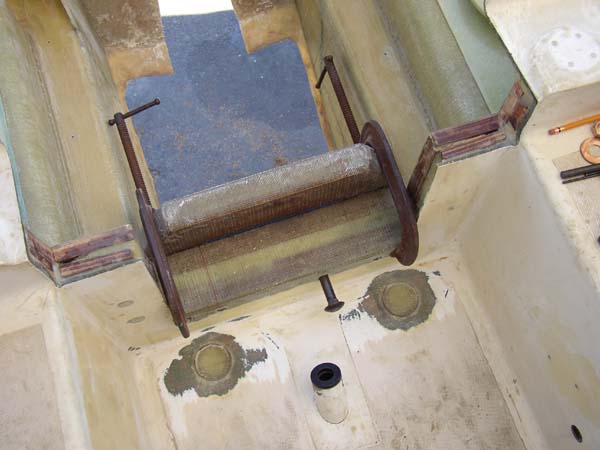

Finally, Ebb did a handsome job of glassing the tubes that pass through the cockpit sole to the hull (rudder shaft and two aft cockpit drains).

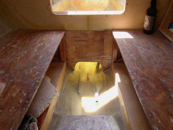

In photo #9 I can follow the drain pipes coming from the Pearson anchor chain locker okay but to the right and running mostly vertical there is a slightly curved pipe peeking through the cut-out where the old water tank effluent would have been. Is that more drainage? From the Ebb chain locker perhaps I thought but no, you're having some poly tubs made for rode storage and it couldn't serve them because they are not there in the photo. What the devil is that!!

Ester, would you look at the pipes on that fella! Are 338's new c-pit drains more of the frp gas pipe used for the forward scuppers? Nice work but here I'm more interested in technique. Do you lower your epoxy and glass, tools etc. down one c-pit hatch then climb in the other and work or did you have help? Devine intervention?

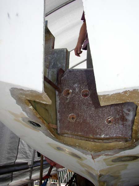

There are stress cracks where the rudder tube comes into the c'pit floor, where Pearson had put very little reinforcement on the underside of the deck. (More may have been a bad idea,) If I wanted to put in 'straight-thru' drains (just like the rudder tube) I felt I had to immobilized whatever possible, to the greatest extent reasonable. I glassed the tubes in first with x-mat going thru the holes with the tube and turning the mat onto the flats outside, Then I laid on another layer of mat over the pipe and up to the inside. The inside of the hull and the underside of the c'pit. Then there is the bugle-shaped sculpting (epoxy/cabosil/chopped strand) and a final layer of mat. The rudder tube got the bugle up top to match the bottom Pearson did - with extra layers of mat. Interesting that the cockpit sole still can flex when walked on - it is about 3/16s thick with strips of plywood matted to the bottom for stiffning. Not a whole lot.
There are, of course, arguable merits to leaving the cockpit suspended and semi-flexible. I chose to lock it all together because I removed the aft bridge (and Mrgnstrn was on my case) Monoque. I warn you that the grinding and prep necessary especially of the hull and the underside to the cockpit structure is beyond the pale, or pail, whatever it is, you have to be Nuts to undertakeit! I had heroic help!

You may notice in the photo, this cockpit has been immobilized with longitudinal bulkheads that marry the free hanging cockpit "bowl" to the hull beneath it.
The rudder tube (with its bell-shaped buildup of matt and who knows what?) was not attached (glued/glassed) to the underside of the cockpit BUT deliberately by Pearson - because Ariel cockpits are hung loose and unsupported - not attached anywhere except higher up where the molding becomes seats and bridgedeck. Had a real problem with that concept!
Since I stabilized the cockpit, I attached the rudder tube to the sole.
ALL the new bell-ends are composed of mishmash (epoxy, fumed silica, chopped strand) on top of fiberglass, as describe above here, with more glass cloth or biaxial matt on top of everything to finish. These tubes support compression loads....the cockpit floor -- in A338's case of factory encapsulated plywood strip reinforcement -- still somewhat limber...
Again, not BrianC's textbook construct. But thick backup plates of bullet-proof mishmash is not unknown (see "Fibreglass Boats, by Hugo duPlessis, AdlardColes 1966. Reinforcing frp tubes per se' is not covered there, but it has been my glass bible since the beginning.)

I've been thinking about adding extra cockpit drains too. However, I'm concerned that seawater might be forced up the short tube into the cockpit. "Ram effect," or something like that. Not alot of water, just an annoying little bit.
I have a friend whose boat does that, but only sometimes. I think it happens when the boat is heeled over and extra crew brings the stern down.
Some people cross the drains to the opposite side. But, that is supposed to make the drains less able to empty the cockpit of boarding seas, which is the whole purpose.

I tried to take into account the consequences of putting the rear drains in like they are with the cockpit deck so close to the waterline. [338s forward drains exit aft Above the current waterline, while the rear drains exit aft under the current waterline.] It was a shoot first take the consequences later decision. Ive spent hours looking for a retrofit flapper valve. No wonder Pearson didn't put in rear drains. There are a number of different kinds. Ones at the cockpit deck like a ball in a cage type take up too much of the drain volume. But are right there to keep an eye on.
A power boat exhaust flapper on the bottom side in the water would probably be my choice, but I worry about the pressure of the outside water not allowing the cockpit to evacuate. So nix that. I'm thinking the flapper idea could be adapted to the cockpit deck drain. But again, at what cost to emptying the c'pit quickly?
So, how about a sliding ss or bronze drain plate that could slide open fully when needed. It would be captured under a flange, the flange screwed like any fitting to the deck. Yah shure, there are design considerations here and a month or two of design time and model making, etc. For the moment, when I go sailing (OH GLORIOUS DAY) I'll screw shower drains over the holes. Something will come up. Hopefully not too much briney.
I was thinking, the holes might make annoying gurggling sounds, as well.
Crossing the drains could be done couldn't it? Would one use hose? Probably dangerous in the back without ready access. Seacocks: impossible. What considerations are there at the companionway in a Commander? It would be possible to do a 'hard' install in the back with angles and pipe. PVC and epoxy mate well, I've heard. It IS tight back there!
The ball in a cage check valve is worth looking into. There are a couple, anyway, and if I recall, they are a fitting - in that they can be incorporated into normal or existing plumbing.

#9 shows the access under the chain locker, Just access. Three tubes: Straight one on left comes from drain hole in forepeak. Bent one on right sweeps up to hole in chain locker. Both will continue by conduit under the sole to the sump and end in threaded ball cocks. Short upright is a piece of the sonar model which is sculpted into the stem. Cheers................Ebb

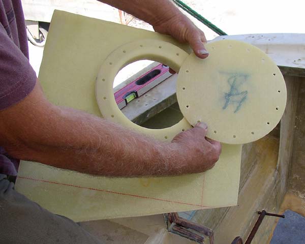

The first photos are of the "motor clamp board" being installed at the forward end of the ob well . . from below
And from above (ie., from the cockpit)

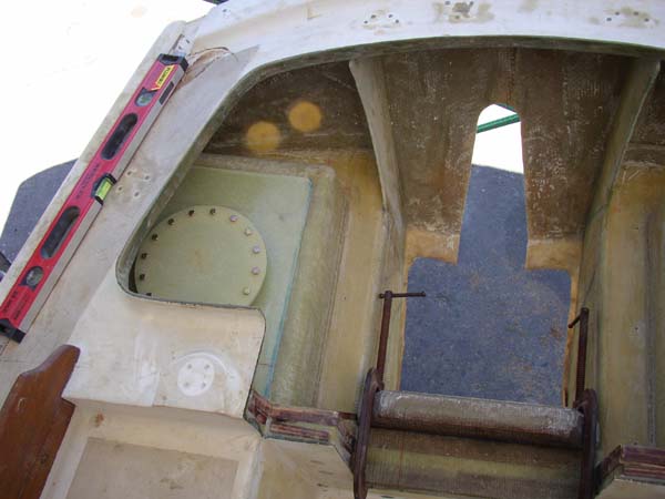

Next, we have the fuel tanks (the starboard side is shown). The hold approximately 8 gal each.
Here is the top of the tank and lid assembly as modeled by the captain ..
