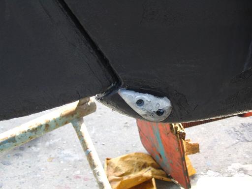

On C-80 the rudder shaft looks fine. But the shoe is almost totally gone.
Obviously the shaft is more noble. I wonder what alloy of Bronze the original shaft is?
I am working on a solution to this common problem. What alloy would be most like it but slightly less noble?

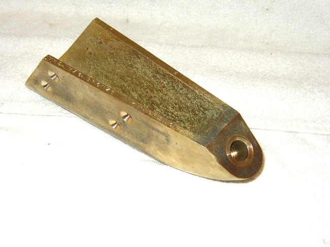

Contacted Fred for an update. He has one shoe machined and ready for shipping. Price is $300 including S&H. This price is higher than the earlier shoes due to increasing copper prices. The cost of the next shoe is likely to be higher still as the materials for this one were purchased over a year ago. :(

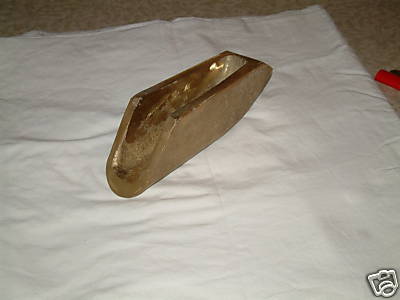

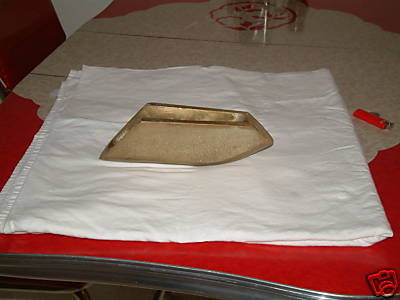

I just had the bottom done on 376, and what do you know? The Zinc I put on the rudder shoe two years ago was gone. I also had a zinc attached by wire to the tiller head fitting when at the dock, but not much gone from it. I have one of Frank's beautiful new rudder shoes in inventory ready to be installed when needed.

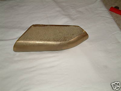

http://cgi.ebay.com/ebaymotors/NEW-R...3A1%7C72%3A317
Brand New Cast Bronze replacement rudder shoe to fit Pearson Ariel, Commander. Vanguard and Alberg 35. These have also been used to retrofit Pearson Triton, but a new rudder stock and keel modifications were required. MAY also fit/be adaptable to the Pearson Coaster but am not sure.
This is a raw silicon bronze casting and requires finish machining to be installed on a boat.
Copy of authentic Pearson drawing with machining dimensions and specs is included.
C'pete, great find. good starting bid price.
If it's correct to the specs then it is a real goody. Pg171 A/C Manual.
Added expense is getting the ruddershaft hole (3/4"X3/4"D) milled.
Has to be accurate.
Side pins can conceivably be drilled while mounted to the boat, but really easier and more accurate to do on the drill press with holding jig. And a breeze to add the chamfers for peening into.

Finishing the bronze is more a matter of fit than removing the casting marks.
Sandcast surface is not rough and makes a good surface for paint. Not that S.B. needs paint.

The shoe sold for $146. Must have been one that Fred built

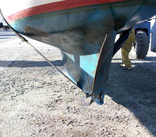

Thanks Tony. I didn't supervise the haulout of my boat closely enough last Winter. This is what happens when they start to lift the boat out of the water, by the rudder
Lucky I had a spare rudder
They did that at a yard.:eek:
Wound up being $172 w/shipping, near enough. Anticipating the worst - I'm not *positive* that I need it, but wanted it on-hand just in case I find 'bad stuff' down there when I pull the boat. Bronze rod can be ordered fairly easily, not so a shoe. And with the price climbing above 3BoatBux over three years ago, figured it was a good deal not to be passed up...

Hate that the yard did that to your rudder. :eek::confused: :mad: Did they pick up replacement/repair costs?

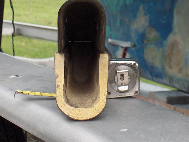

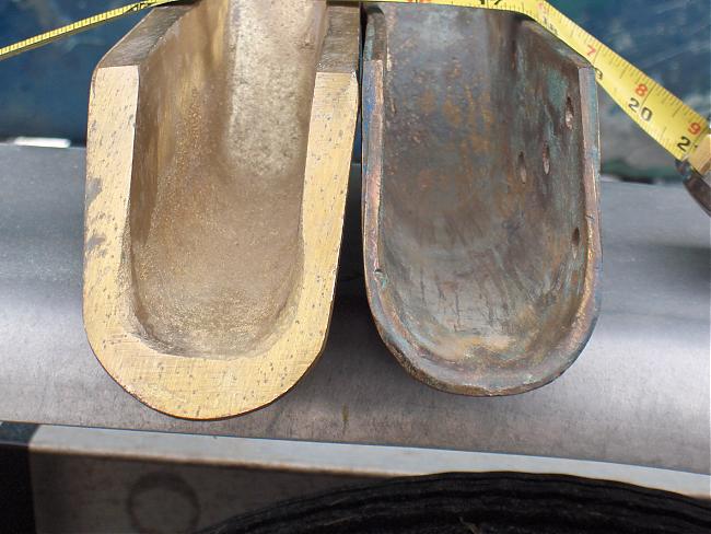

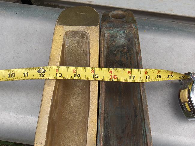

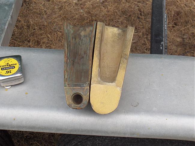

I bought one of the rudders shoes advertised on EBAY, it arrived today. It is certainly a very hefty piece when compared to the original. I'll post some pictures tomorrow of both shoes , new and old, side by side so you can compare.
The seller said his friend had several of these cast several years ago and just recently dug them out to sell. I don't know how many he has, but I mentioned posting here if he had more to sell.
Later:)
PS I will add I feel like this is nearly twice the weight of the original and will positively need to be milled (ground) down to use, it's just TOO hefty a piece.
I really don't need it as my original is in good shape. If a member does, contact me, The price is cost plus zero.

Mr. Boggs, Welcome, If I recall the gentleman who had these cast had an A-35 and had these cast from that original shoe. This wasn't cast as an Ariel direct replacement. Hence the hefty size in the previous photos. This piece is for sale if your interested, I could take some measurements this weekend if I should get home and post here.
