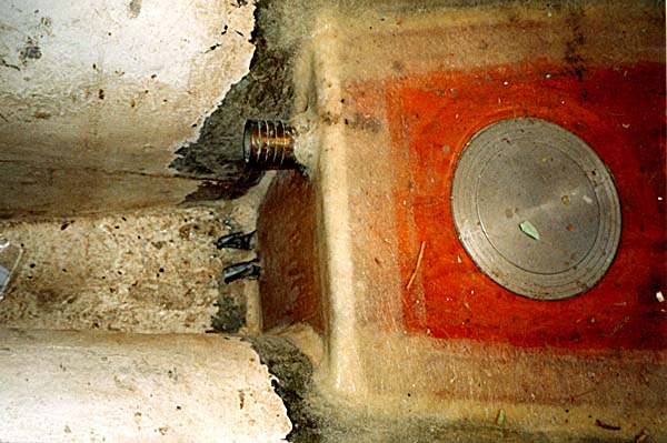

Photo #17 is looking aft at the fuel tank located below the cabin sole. "Fuel tank is Diesel, of course. Two athwart ship full baffles in the tank. Fuel quality inspection hatch visible. Engine beds aft of that and the two pipew coming from the cockpit floor are the forward cockpit drains."

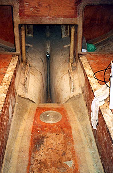

Photo #18 looking directly down at the fuel tank. "Filler for fuel is 50 mm (2-inch). It will be lead up to the starboard side deck. A breather will branch off to the cockpit. The tape at the bottom is protecting two brass taps. One is a drain and the other is fuel supply."

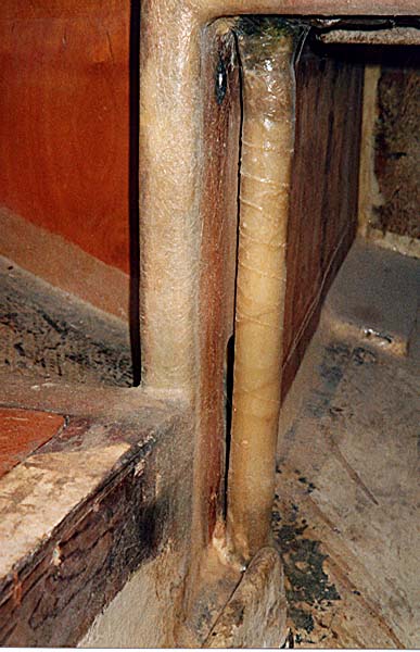

Photo #19 looking aft under cockpit floor. "Engin beds are angle iron pieces that bolt onto the uprights."

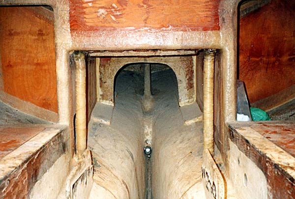

Photo #20 under cockpit. "Details of construction of foot space, everything glassed. All angles covered and double taped."

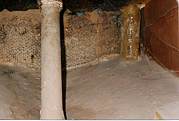

Photo #21 under cockpit. "Way back under the cockpit. I put in rear cockpit drains. You are looking at the porside drain. The pipe is the rudder post."

Is it just me, or did anyone else notice the wonderful grain of the plywood Geoff glassed in under the cockpit in photos #19 and #20? Is that sub-sole fuel tank glass coated wood? 'kinda looks like it-I didn't know you could do that. I like the hard dodger idea too-it gives it that live aboard look. Geoff's got my support!

#17 Very interesting use of this space. The baffles in the tank and the tank ends create the 'transitional' stiffening (I think is important) between the abrupt termination of the ballast and the longitudenal plywood berth tabbing. Excellent upgrade for a cruiser. Wonder how many gallons he got? Seems like the perfect place for the tank of a diesel. Glad 338 is an OB, tho.
#19 Looks like the original NOseacock well drains. Can't tell if they're hose under the wrap. However, I'd glass them bigtime right to the engine room walls there.
#21 Geoff's aft cockpit straight thru drains get my vote. Treat them just like the rudder-shaft tube. If anybody else is looking back here in the Ariels, I can guess the stalagmite part is in pretty good shape. But take a look at the upper end where goes thru the well deck - 338 needs reinforcement here. Again, I would throw a lot of Xmat and epoxy at these straight-thru drains so that nothing flying around loose is going to open them up! After the motor is in only a ferret will get access back there. Maybe a small hatch in the c'pit deck in front of the rudder tube is called for. Like Tim has in his T-381.
