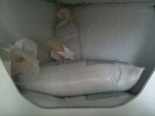

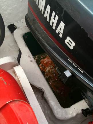

So... 240 lbs of tube sand in the chain locker and the aft end of the engine cutout is flowing free and easy. That must balance my 200lbs sitting far aft in the cockpit. Not sure about sailing performance. Sailed in light winds on Saturday and Monday and didn't notice a dramatic difference. Will be curious to see in a blow.
Below, that is a water flowing under the stern at about 5 kts - previously, the laz would usually have water sloshing around inside. Hence my bored out drain hole idea that ultimately didn't solve the issue.
(10/25/11 edit: Based on 10/24 sail in a pretty stiff breeze, I think the ride is nicer. Seems to cut through the water rather than "belly" through. The difference in ride is only a nuance, but my top speed seemed to be up 0.2-0.3 kts. The outboard cut-out continues to ride above the water even in a blow. Not a bad low-tech performance upgrade for under $14.00)
