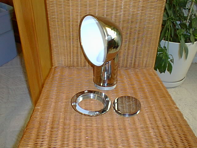

It can be done! But I think you would need dogs about every four inches to keep the leaks unknown. Being one that doesn't see offshore work in his future, I opted for some 3" dorade vents. The 4-inchers would let in much more air but look HUGE on our little boats. Between the hatches, dorades and fans to blow the stink and heat away I'm hoping to be cool. Actually, I'm just hoping to be on the water away from the phones!

Well, I'm all behind anyone's efforts to modify or remanufacture parts as long as it is an improvement. So this photo is not an attempt to derail E's progress. It's just an alternative (to snag lines, house hornets, stub toes, etc.)

Puuuuuuurrrrttttyyyy. :) Looks so much better than the white bendy plastic ones. At least to the eyes - toes may well have differing opinions. ;)

Maybe I could glass over the deadlight spaces, and mount 4 ventilators like you have pictured, poking out from the cabin sides.
Or maybe not!!! Gawd, that would be ugly. I'm ashamed for having thunk it. :)
"Monday morning" is my only excuse...
Where did you get those, and could an inquisitive fellow also ask how many hundreds of dollars they cost apiece? Look nice, and look nicely engineered.
