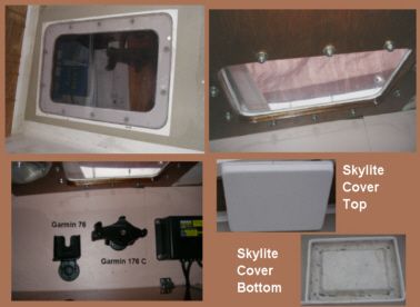

I've been digging around here and on your own web site trying to find some pictures of that chart table skylight you write of. If one knows what they're looking for you can just make it out in some of the photos. How did you attach the plexi/lexan over the opening? Obviously it's watertight. We're still kicking around some different ideas here on how to structure the outside frame for a skylight/portlight just like what you describe.
Would you have any close-ups of that area of your cockpit you could share with us? Thanks, Tony G

The Previous owners installed the skylight and chart table. The skylight is flush mounted in a recessed lip that was cut at the outer edge. The skylight is thru-bolted through a mahogany panel on the underside with acorn nuts on the bottom. The bolts are flathead machine screws, so they flush mount into the Lexan skylight. Given that the bedding of choice for the previous owner seemed to be silicon, and given that the bedding on the skylight is clear, I assume that the bedding is silicon. Plans for the chart table conversion are in the Ariel Association manual. I will take a few photos of the skylight and chart table and post them.

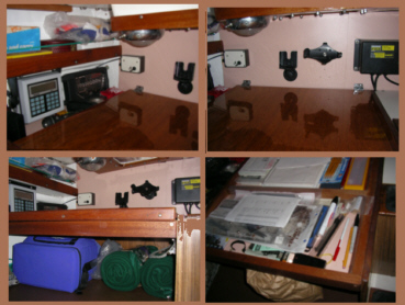

In the photo below you can see the table. The right chart table lid hinge is visible against the bulkhead. The mahogany strip above the table is the front trim strip for the mahogany "ceiling" installed above the chart table through which the skylight is thru-bolted. The black mount on the left is for my Garmin 76 and the longer black mount on the right is for my Garmin 176 C chart plotter. The GPS units are directly below the skylight. The Loran is on the far left, and a dome light that has both white and red bulbs in it is mounted against the mahogany ceiling. You can clearly see the dome light in the photo. That fixture lights the chart table very well. The compass can be read from the chartable or from the cockpit. It is lighted.
A small sub-panel (connection box) is below and to the left of the dome light. The purse-like apparatus above the table is a contraption that I devised from an imitation leather purse (Ross Dress For Less) and a 1 X 1 piece of teak. The teak strip is backed with Velcro. It attaches securely to a strip of Velcro on the bulkhead. A small pair of binoculars, some pens, a variety of small tools, knives, propane torches for sealing rope ends are inside the purse compartments. I can either reach inside the companionway hatch and remove the whole thing from its Velcro strip, or instead, I can reach into one of the pockets to retrieve the tool that I need for a quick topside repair without having to drag out a larger tool box or three from below.
As requested, I have attached are two composite photos that I took today. It was raining at the time, so the tent was over the companionway hatch. The light available for the photographs was poor. The first composite shows the chart table. Again, I did not design or build this icebox-to-charttable conversion. The plans are in the Ariel Association manual. I have no critical comments about either the design or the execution of this useful and well built table. Since the table is varnished, an occasional splash of salt water has done no harm to the wood The placement of the electronic instruments beneath the skylight in the bridge deck also offers excellent protection from spray and rain.
The second composite shows the skylight in detail. The cover is merely the original icebox lid with new gelocat on top and an edge protecting plastic strip mounted on the bottom edge to protect the deck and Lexan skylight. Garmin GPS 76 and garmin GPS 176 C mounting brackets are shown. Both receive adequate reception without external antennas due to their proximity to the skylight.
