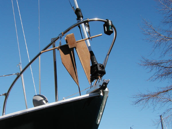

Better view of #0 Harkin furler

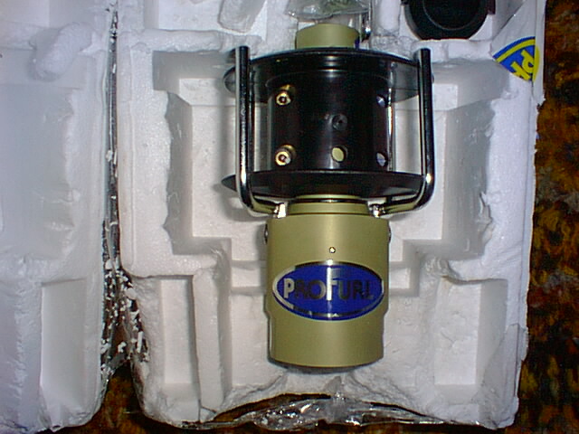

Thanks. I dug out that copy and had a chance to read it on a recent trip. I honestly don't know why I hadn't read it earlier. Even though Schaefer gets the thumbs up I snagged this one at nearly half off regular price because someone had pilfered two ten dollar shackles from the box. Maybe next year I'll get to see what it looks like on the boat!
