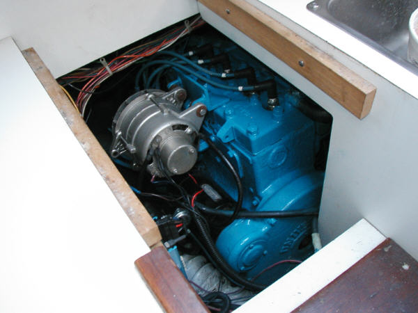

Hmmmm, first I've seen from this angle . Looks like and old flathead Ford
Atomic 4
Yep your right French it is a flat head with only 6 to 1 compression.Its probably the most simple engine in the world to work on,but it still needs to be maintained,something most sailors dont seem to do. Mine only burns about 1/2 a gallon of gas an hour and pushes me along a full hull speed in any condition and is as quiet as your cars engine unlike a diesel engine.
