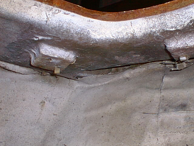

In the early 80's when I had to march in a straight line if someone said 'unsat' it meant unsatisfactory. Well lo and behold it's the early notties and it still does. Here are just some of the spots on 113 that I found unsaturated glass. Some of it is just superficial some has been a little deeper. The superficial stuff tends to be located on/or in the area of the hull deck seam so I don't know how 'superficial' it really is.
Aft starboard corner of the lazerette...

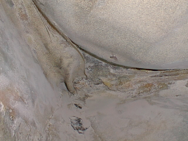

Nope! Sorry, that was inside the starboard cockpit locker looking aft. Unsat just the same.

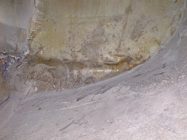

Dang! Good thing this is just a mouse and not a hand gun. I'd be pokin' holes in everything around here! Still-unsat in the stem. Here's a broader view...
Gaps and holes everywhere. Maybe I should rent a chopper gun and throw in a hundred pounds along that seam...
WHOLLY JEHOSEPHAT!
Well. I'm not completely sure what we're looking at here. Last foto is of the forward bulkhead at the stem?
Of course you'll be checking with your epoxy friend....but dig, cut, grind out the unsat IF IT IS NOT THE HULL LAMINATION and fill it properly and retab the bulkhead to the hull.
If the unsat is also the hull, WHICH I CAN'T BELIEVE, we need further discussion here!!! - especially with input from Mike.
In 338 there is a lot of roving used for the hull in the rear where finish was not deened important - sand away the paint where you intend to repair befor you epoxy. That looks like paint on the roving. Sorry if I sound patronizing. Looking at Geoff's. I wonder how close is close enough?
That last photo is lying on your back looking up at the deck at the stem. You're right, that area still needs some prep work. Enlarging the chain locker opening was one of the last things I did on the boat and the was entirely to facilitate working in that area. About that paint, I'm still looking the right tool or technique there. I fashioned a clamp for a 6" wire wheel and that has worked great in the toe-rail cavity. Hours with the 4 1/2" angle grinder and 36grit. But up front in the chain locker when I use the grinder it starts exsposing the raw roving fibers and I'm uncomfortable with that. There may be enough layers there but I'll keep looking until I hear otherwise. The wire wheel worked ok, maybe I'll just have to put in more time.
