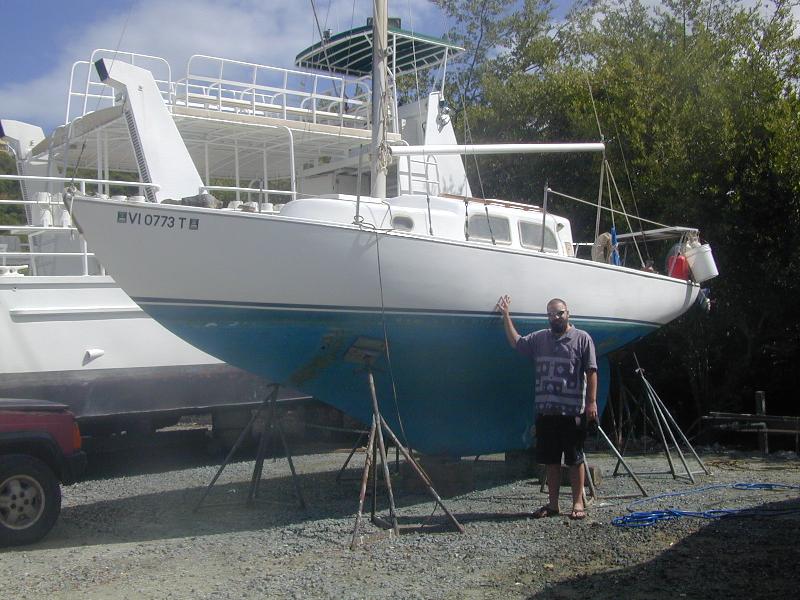

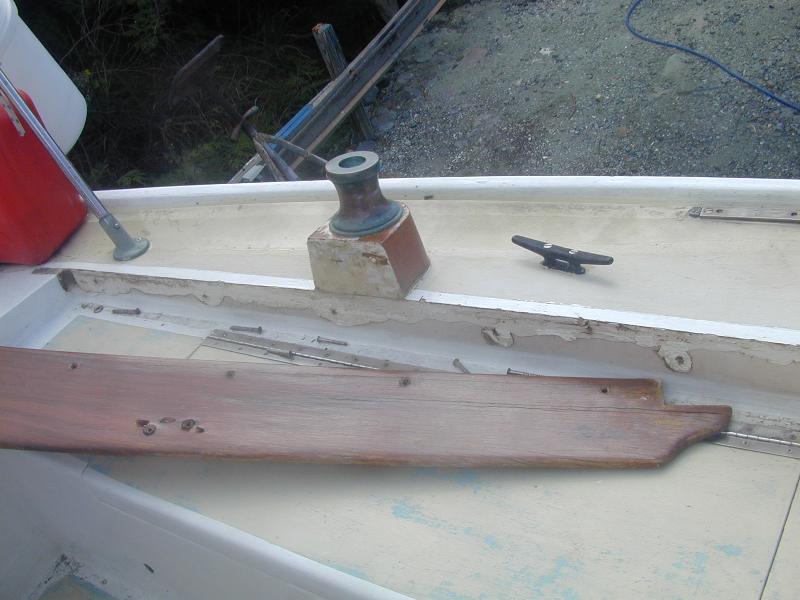

Wayward Star is hauled out for the month of May. I'm replacing the port coaming , recoring the foredeck .
Just making her strong for this upcoming hurricane season.
Here's Wayward Star on the hard. That's my son standing next to the boat.
A man walked by yesterday and said,"Who's Ariel is that?" He has one in Huntington NY and says no matter where he goes, he sees an Ariel! He saw one in the Bahamas also.

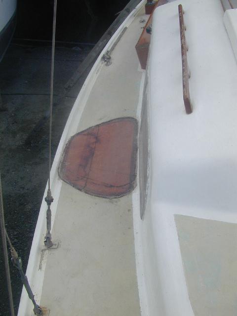

Starboard deck fiberglass repair.

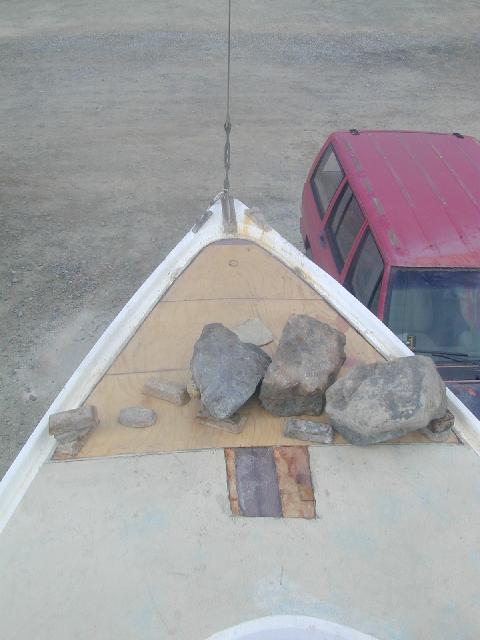

Boulders on the foredeck
I'm not a naval architect, but I think you want to carry the extra ballast lower in the boat ;)
Janice,
Good to see work in progress. Now go order at least one of those Ariel name plates we had copied off of 376 to go on your new coaming. I'll look terrific!
Janice:
Is that a metal bar underneath the foredeck? I have assumed that the bow cleat is attached through a metal plate, but you know about assumptions. Seeing your picture made me want to ask rather than assume.
Peter,
I cut open the guts on my foredeck a few months ago for a repair, and what you see down the middle of the deck is a stout peice of wood, not pipe. You can see the outline on the underside of the deck pretty clearly if you take a look inside your yacht.
That's not what I wanted to hear. I was hoping that it was a piece of stainless or something that a cleat could not pull through. Have to go back to the drawing boards now. I now have the first item on next year's project list. And as for assumptions.....
