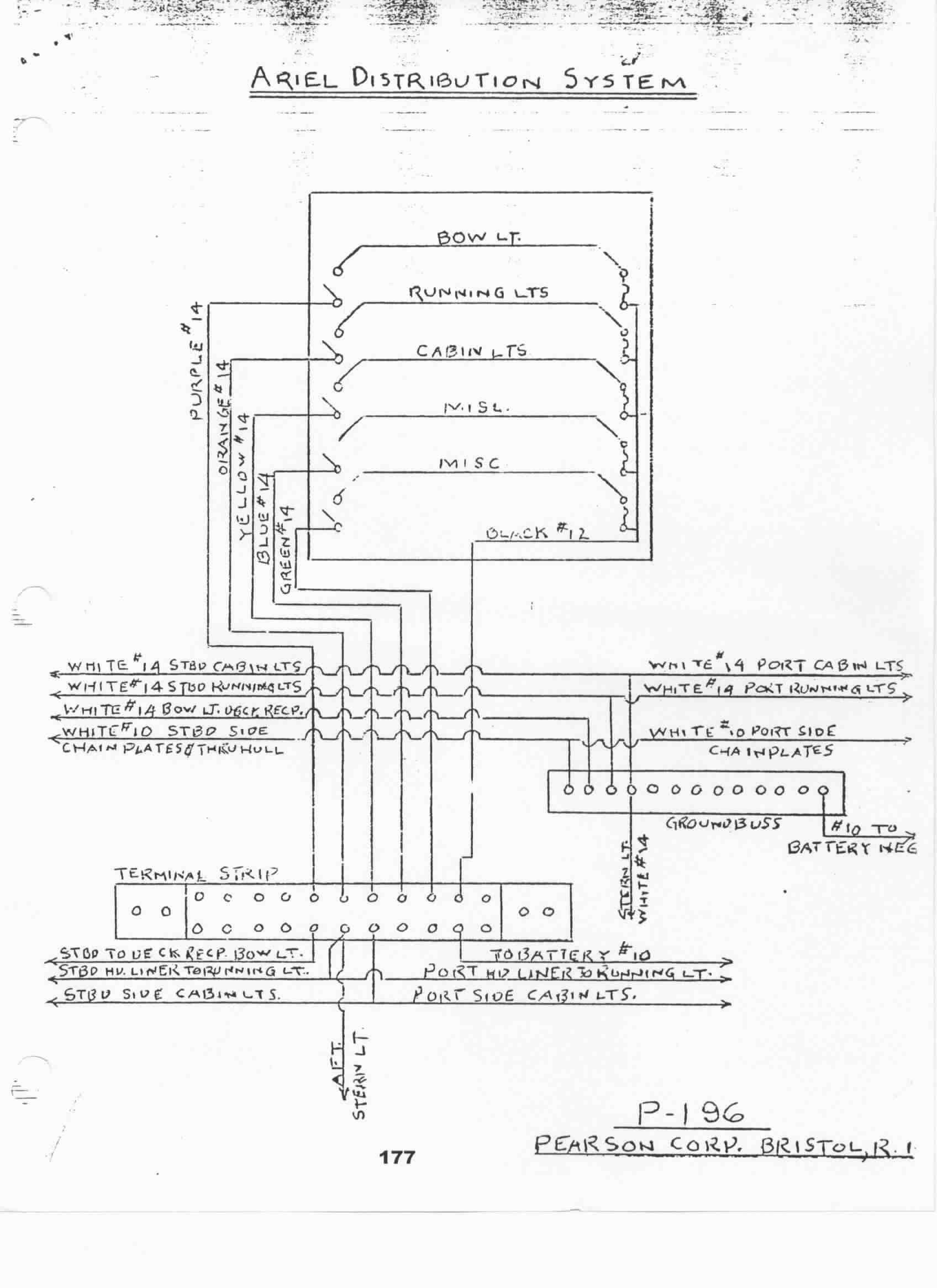

Ok gang, maybe I should call this the "mysterious red wire" thread. My boat is wired at the distribution panel like the second wiring diagram in the Ariel manual as follows:
Purple: Bow Lt
Orange: Running Lts
Yellow: Cabin Lts
Blue: Misc (Anchor Lt on mine)
Green: Misc (Spreader Lt on mine)
Black: to the termnal strip then to (+) battery
But wait, there's one more. A red wire is in the wire bundle but it doesn't attach to anything in the distribution panel. It has the exact same butt connector that all of the wires use that attach to the switch panel, so it looks like original installation as opposed to add on. Only one prior owner on this boat and only for a couple of years in the 60's, and I know my dad didn't add this wire! The red wire reappears and is connected to the top of a circuit on the terminal strip, and there is another red wire from the bottom of the same circuit on the terminal strip. It goes to who knows where-- it disappears in the bundle of wires that go off into the darkness behind the bulkhead and the icebox. Sooooo, may I safely assume that this was an "extra" that can be used with the additional switch panel I'm adding, or was it for something? I'm hoping to shift attention away from "Logo Envy" to "Red Wire Envy" for those of you who don't have one.

Yea, what I call the distribution panel is the switch panel. What I'm calling the terminal strip is the strip mounted next to the steps (right above the ground strip). And all the lights and everything work--- there's just one extra red wire in the bundle that has a butt connector but isn't and never was connected to the switch panel. The connector was never "crimped". Its the sixth wire and it doesn't have a home-- the switch panel (original) only has room for five. The red wire is the same gauge as the others. On my ariel, the black is the heavier gage and goes to the battery + terminal eventually (its the seventh wire-- don't you love this?). I'm just going to assume the red wire was an extra put in there for "expansion" but never used in the basic factory set-up. It doesn't appear on the electrical schematic in the ariel manual (the second schematic which is for the higher numbered boats, everything in that diagram matches my boat exactly-- will be different from your original set up on a low number boat, which probably had next heavier wire size and wire insulation colors were different). I've got an OB model, could that wire have been used on boats with Atomic 4 inboard? Oh well..........maybe instead of "the sixth sense", I have a boat with "the sixth wire".

See page 177 in the manual----- the black wire goes to (+) battery. Very interesting.
Look at page 176. You will see that the red#10 wire to the switch box is the hot wire. There is no black wire to the switch box. This drawing has a date of 1966, and the drawing on page 177 does not have a date. It would appear that the 176 drawing is a later drawing, however, as it also includes the Lark.
