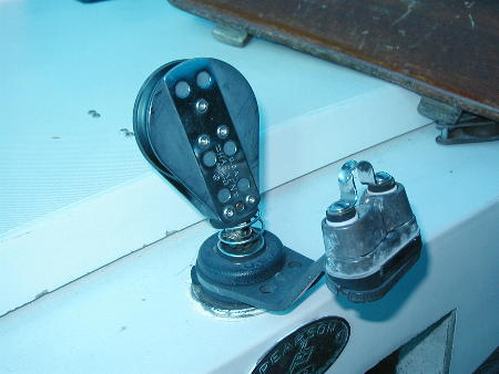

I see that some people replace the port block with a fiddle block with integral cam cleat. I see these type of blocks on e-bay every once in a while.
I did something different. It's a swivel block with cam base that also swivels. This is mounted where the cleat was.
A traveller is the best method, giving you better sail shape, etc. Plus you get more lines to play with. It's on my wish list. Parts alone cost $300-$400.
Here's what I have
mainsheet control
