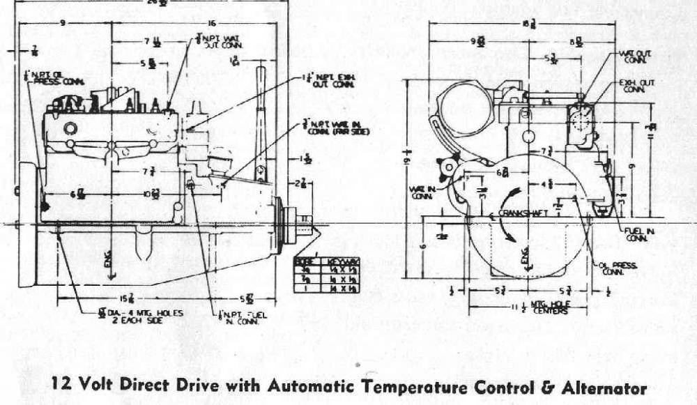

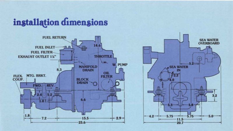

Ariels were designed with the A-4 as their inboard auxiliary power. If the Atomic Diesel has the same block, etc., it should fit. But, that's just my assumption.
The Atomic 4 and the 5411 use different blocks but are similar in size although not identical. The 5411 is a couple of inches taller. Below are diagrams with dimensions for the two engines.
