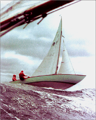

Here is a great photo of a folkboat in heavy weather.
