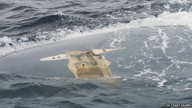

A US Navy warship found an overturned hull with a 'breach where the keel had been.'
It was the 39' Cheeki Rafiki. A Navy swimmer found the cabin completely flooded (no air pockets) and windows shattered.
Missing are Capt Andrew Bridge, 22.. Crew: James Male, 23 - Steve Warren. 52, and Paul Goslin, 56.
The search was abandoned and an armada of 40 or more yachts headed for the area, 1000 miles off the US coast, mid Atlantic.
The yacht was again found, I believe by the same warship.
Look into the blog at http://www.wavetrain.net/news-a-view...heeki-rafiki-/
CHEEKI RAFIKI: Hull Found Again, Post Mortem. We finally discover the hull is from a Beneteau First 40.7.
Close up photos of the keel area show what appears to be REMAINS OF THREE RUSTY KEEL BOLTS, centered along the headprint of the keel.
Actually, it's SIX rusty bolts seen in the revealing photo of the bolt pattern inside the cabin. Any casual builder can see there should have been at least three or more wider apart pairs of fasteners.....to take stresses of LEVERED side loads on a keel. A sudden side load obviously snapped off the keel.
The flat of the keel head lifting as a lever on the leeside of the force, creating the breaking moment of the bolts. It is/was fastened thru the center of a stamped jelly-mold pan that looks unconnected to the hull framing (if there is framing in these boats.) Agree 100% with the writer's assessment (Charles Doane.) No spread to the fasteners, and probably 304 allthread bolts work-hardened from regular keel movement, was the cause of the accident.....NOT THE WEATHER.
