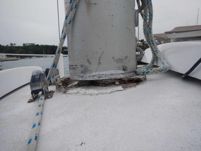

Hello Eric, I will be making a mast base for my boat in the next week or so. If your still in need and haven't anything in the works let me know. I can make two without much more trouble than making one. Going down to 3 degrees tonite here in OKC, OK. Bet you wish you could be here, lol. Of course shipping to Burmuda might be costly. Mailed a package to Canada a few weeks ago and it ran about 20.00 more than usual. I would be happy to help if I can.
I am a newbie to larger boats and so I am keen to get some experience under my belt. I have been working on building a mold with the cabin curve and bow/stern slope from plastic wood and strong card, on a wooden base. Then using the mold to build up a fiber glass mast step block with the right base dimensions ready for shaping drilling etc. . It has worked well so far, I am almost ready for the first fitting. With my power sander and a good eye I am hoping to make a more durable replacement. If I mess up I can always make another from the mold. :) However I truly appreciate your kind offer of help. When I get it to work, I will post the pics of the mold and step . Cheers !!
Sounds like a good idea, looking forward to seeing your work. I am looking at a wood called Osage Orange. Its hard as a rock and nearly impervious to rot, but your fiberglass will be better I would think.
